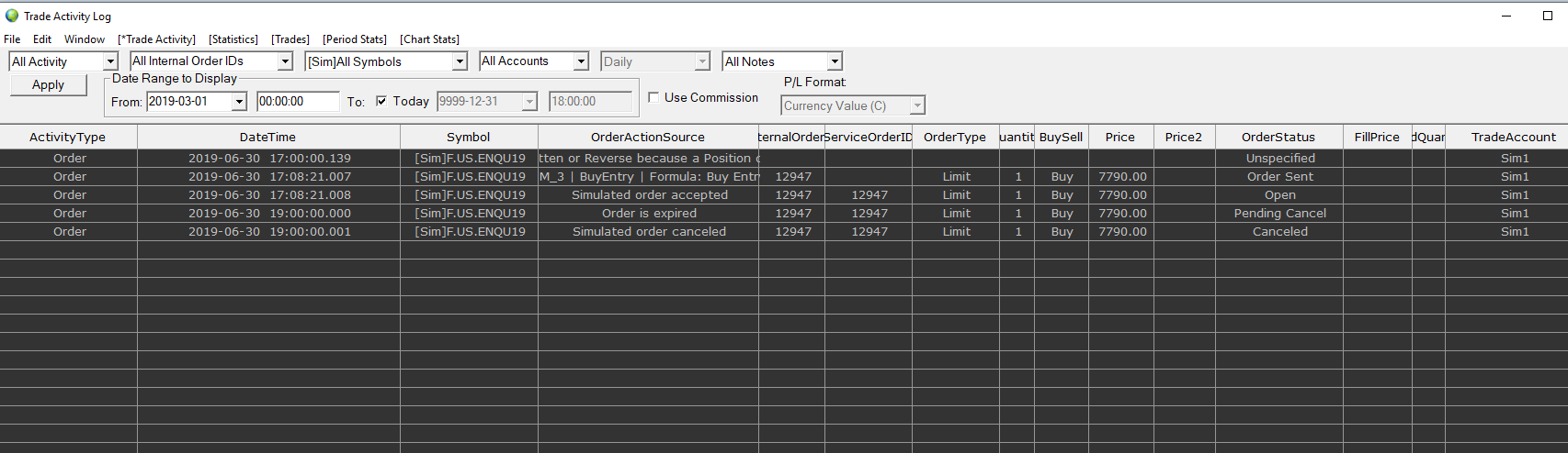

Hello. I do not understand why the limit order is canceled. In the table, for this special functions are not assigned. Counter ENTRY event does not occur. In the study settings I tried to disable all possible points of order cancellation, but this did not help either. Maybe somewhere in the settings of the program, cancellation is enabled when it is not executed for a certain period of time?
imageorder canceled.png / V - Attached On 2019-07-03 11:52:29 UTC - Size: 30.08 KB - 554 views
Private File
[2019-07-03 13:06:20]
Sawtooth - Posts: 4355
Check the 'Time In Force' setting on the Trade Window:
Attached Orders: Time In Force

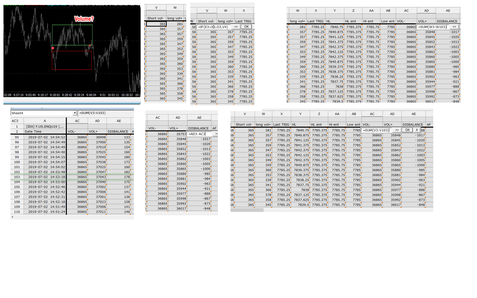

Trying to find a formula for calculating the volume above and below after the trigger of the Large Volume Trades trigger
  What I did wrong, because when the entire volume is on top of the price, the data is simply duplicated, as in the example
Then I summarize them and also get wrong, because they are mixed with those that are not within the specified range from = SUM (W3: W103) and = SUM (V3: V103)
Maybe there is a more reliable method?
image1.png / V - Attached On 2019-07-03 18:39:26 UTC - Size: 139.08 KB - 556 views
[2019-07-03 22:19:14]
Volume at price in not output by the Large Volume Trades Indicator study, and not directly available to the Spreadsheet System for Trading study.
It is output by the Spreadsheet Study study by setting 'Output Volume At Price Data' to Yes, but you cannot use more than 42 Formula Columns because the outputs are in column BA and above. Also the output is horizontal, not vertical, and starts with the volume at the low in column BC.
It would be challenging to do what you want with a spreadsheet study because every bar's low is at a different price.

= AND (MROUND(E3,1/ROUND(1/$J$21,0)) >= MROUND(V3,1/ROUND(1/$J$21,0)) + 0.25)
= AND (MROUND(E3,1/ROUND(1/$J$21,0)) <= MROUND(V3,1/ROUND(1/$J$21,0)) -0.25)

AndreyPoroshin - Posts: 105
The logic is such that when touching the level, the program must accurately understand the direction of entry, but no one can say for sure, and even more so the logic of the program. Therefore, it remains only to make it understand that by touching the level and passing it 0.25 lower, the sale is turned on, if the price turned around and went higher by 0.25, then the purchase should work and so on. Of course, this is the only right decision if you can minimize the difference between buying and selling, because it is in any case faster than it can be done manually.
What you offer = AND (E3> = V3 + 0.25)
= AND (E3 <= V3-0.25), creates many entry points, the sensitivity is large, and a lot is lost on slippage. I would like to give such a command to automation
 1. It doesn’t matter on which side the impulse is going, but if the bar just approached the level or touched the level and 0.25 below the level, then the sell entry is turned on, but on the contrary, then buy entry accordingly. This is probably difficult for automation and there will be contradictions as when using = AND (CROSSOVER (E3: E4, V3)), i.e. on the same bar there will be both sell and buy.
These are all seemingly elementary things, but it turns out that in any strategy this is the most important place where problems begin. With the wrong approach, a lot is lost in this place
It is very important that Signal only ON bar close is NO to reduce reversal loss
The attached video shows the problem of this strategy when the buy entry does not turn on after a reversal, although it is necessary
I am sending you a sample strategy to understand the situation. Timeframe 60min NQ or any other instrument
Date Time Of Last Edit: 2019-08-02 06:41:12
attachmentBIG VOLUME.scss - Attached On 2019-08-02 06:28:13 UTC - Size: 2.89 MB - 489 views
attachmentBIG VOLUME.Cht - Attached On 2019-08-02 06:28:22 UTC - Size: 321.08 KB - 506 views
