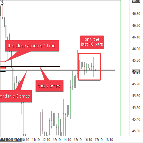

I know this study but I want to realize this kind of diagramm from ASCIL because I want to display pulling and stacking and delta volume.
I tried this code to display how often the same close appears:
SCSFExport scsf_test(SCStudyInterfaceRef sc)
  SCSubgraphRef sg1 = sc.Subgraph[0];
  if (sc.SetDefaults)
    // Set the configuration and defaults
    sc.GraphName = "test";
    sc.GraphRegion = 0;
    sc.AutoLoop = 0; // manual loop
    sg1.Name = "BidVolume";
    sg1.DrawStyle = DRAWSTYLE_HORIZONTAL_PROFILE;
    sg1.PrimaryColor = RGB(247, 77, 68);
    return;
  for(int i=sc.ArraySize -10;i< sc.ArraySize;i++)
    sg1[i] = sc.Close[i];
I attached the result. My questions here are:
1. how can I place the diagramm on the right edge of the chart
2. how can I setup it so it use only say 20% of the chart area?
After this simple use I want to display the delta per price (I know how to get this values) like a volume profile but I need to know how to plot the delta per price because this is now working:
sg1[price]=deltaValue;
imagepic-1.png / V - Attached On 2019-01-01 10:36:21 UTC - Size: 17.15 KB - 661 views
