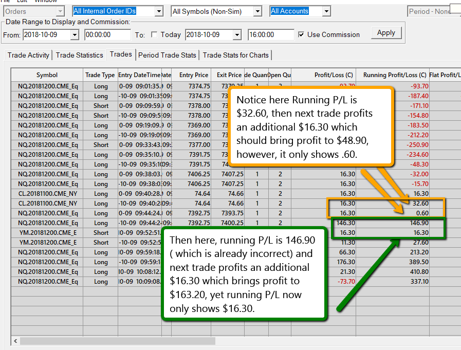

I have been working a combine with Topstep Trader and when I login to Sierra chart thru the CTS server as instructed, my P/L's don't calculate correctly for the running P/Ls. I have updated Sierra to the latest version, but still have the problem. Any suggestions?
Here is a picture of what is happening so you can see what I mean:
imageRunning_PL.png / V - Attached On 2018-10-19 12:36:06 UTC - Size: 126.58 KB - 650 views

For the record we did have the call and upon further review of this screenshot:
https://www.sierrachart.com/Download.php?Folder=SupportBoard&download=22959
We can see that actually the Running Profit/Loss is correct per unique Symbol and Trade Account pair. It is necessary to look back at the prior PL for that same Symbol and Trade Account to see that.
So at this point this support request is now considered complete. And we are doing additional work on trades list and trade statistics which should be out today or tomorrow.

a)When the current trade has a different symbol to the previous trade, the previous running PnL is not being added to the current trade to calculate the current running pnl.
This is by design and will not change. You need to look at the Trade Statistics tab for the Total Profit/Loss for the closed trades.
