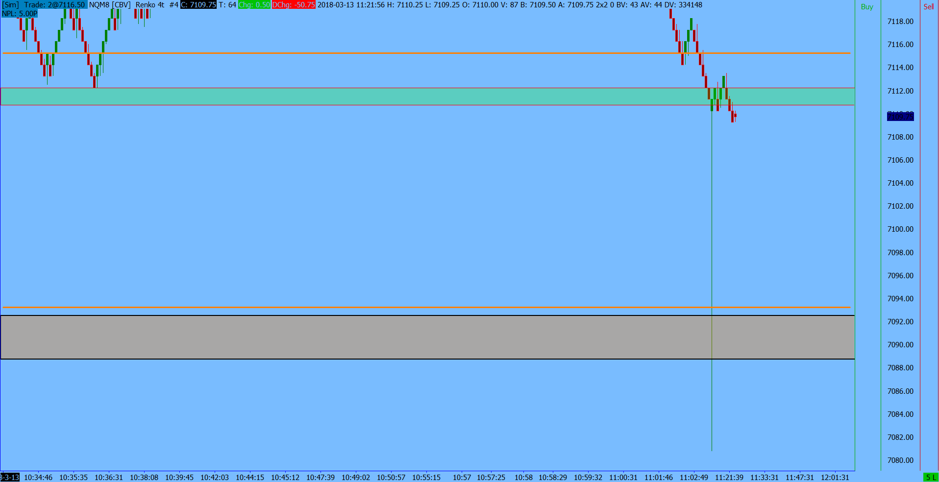

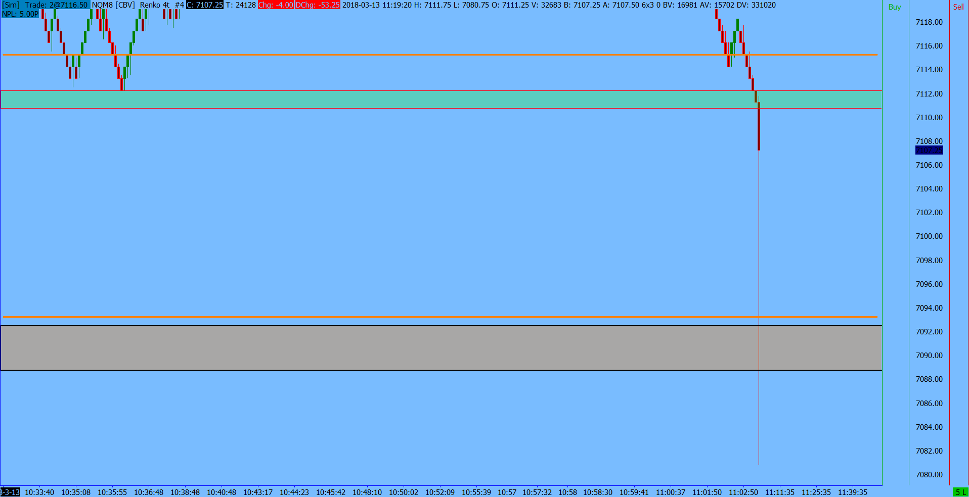

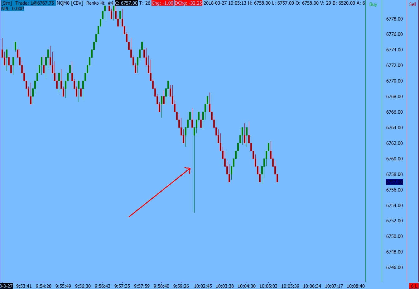

i'm using a 4 tick renko chart for the NQ.
This morning i have a single bar spanning 31 points and over 9 minutes at this point (from 7111.75 down to 7080.75).
when i switch the char to a 6 tick range it looks normal.
Switching back to 4 ticks gives me the same over-extended bar.
5 minute chart on same contract looks normal also.
i've seen this before when scrolling back through days, but not often and i wrote it off to a bad tick. This is obviously something else.
uploading an image of the chart.
As i'm writing the bar did finally end and create a new bar, but only after taking out the high of the bar. for some reason it would not start a new bar on the low. attaching both images, before the new bar, and after the new bar plotted.
I have removed all studies from the chart for uploading purposes.
http://www.sierrachart.com/image.php?Image=1520957961794.png
http://www.sierrachart.com/image.php?Image=1520958117612.png

Attach that particular chart by following these instructions:
But first try re-downloading the data for the last two days following these instructions:
[2018-03-13 21:47:43]
User98657 - Posts: 420
the delete and download fixed it, thanks.
the reload recalc earlier did not, but i understand the difference.

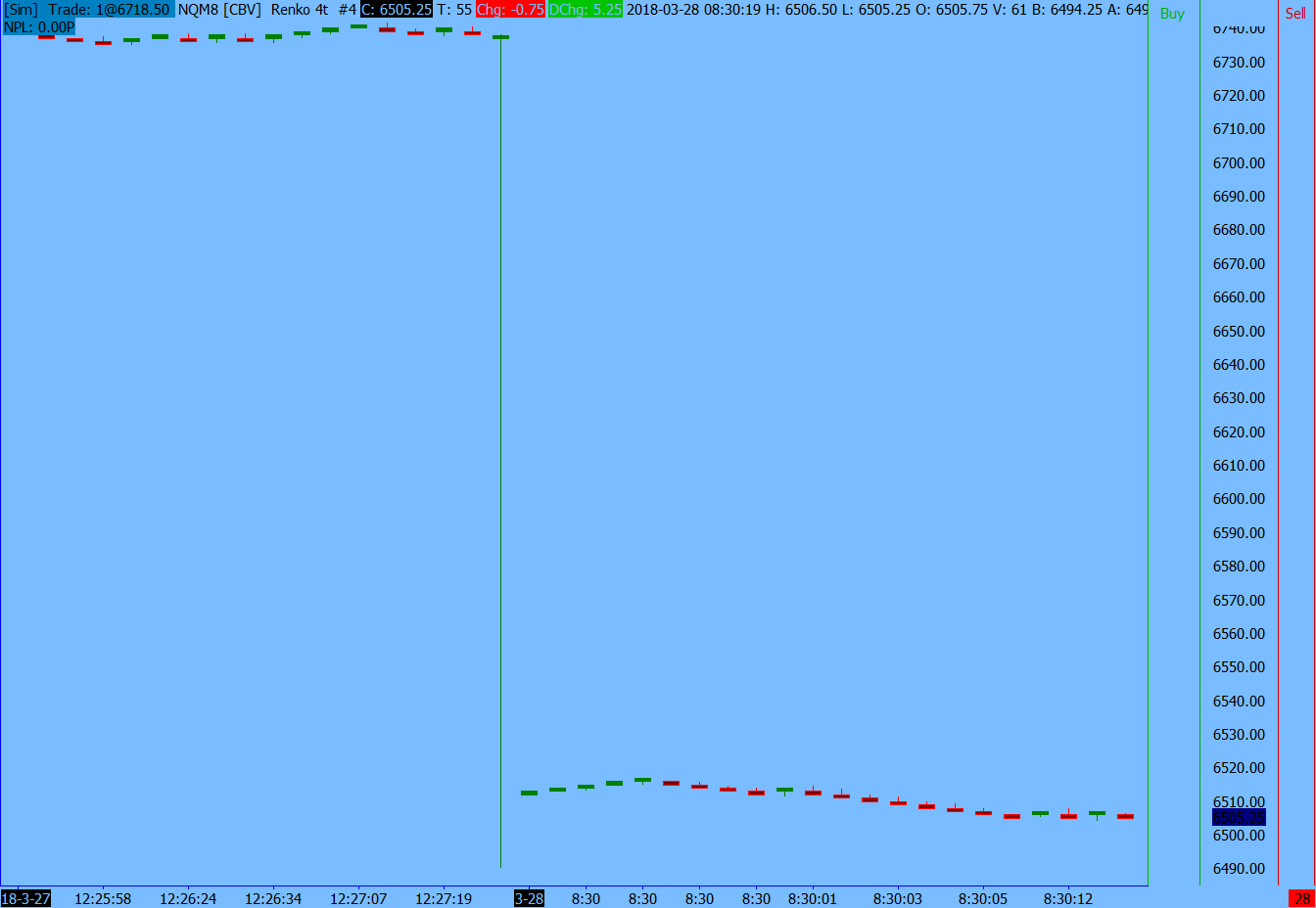

[2018-03-28 12:58:21]

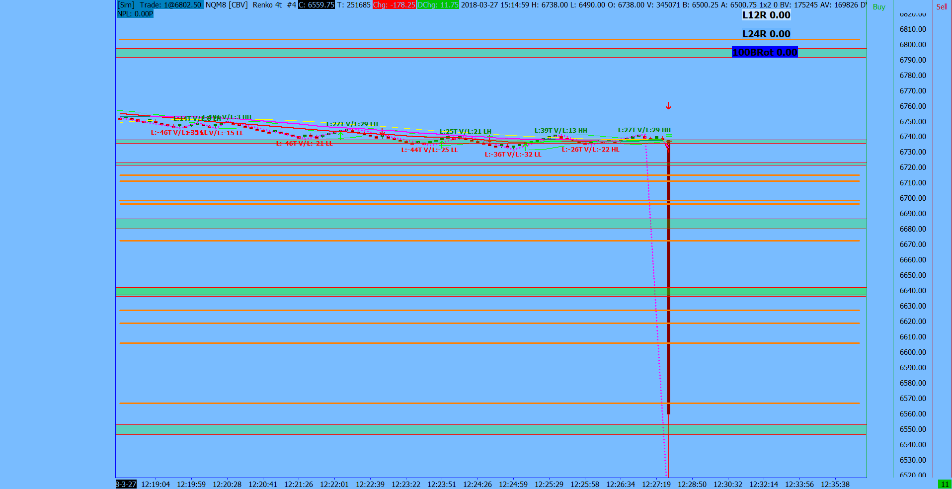

the renko bar issue seems to have reappeared.
http://www.sierrachart.com/image.php?Image=152224184319.png
i did delete and download data from before the bar before sending this.
Date Time Of Last Edit: 2018-03-28 12:59:06

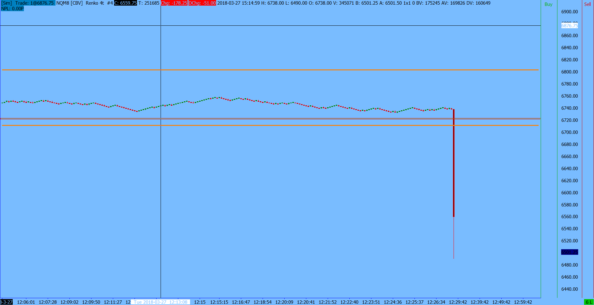

[2018-03-28 13:16:18]
Sorry, i didn't notice this before sending that last post.
my chart from yesterday is stopped at this bar that started at 12:27 central.
i have done the delete and download.
http://www.sierrachart.com/image.php?Image=1522242968637.png
and just an FYI, if i switch the chart to a 6-tick Renko, it looks to be fine. when i switch back to 4 tick, it reverts back to this long bar.
Date Time Of Last Edit: 2018-03-28 13:32:50

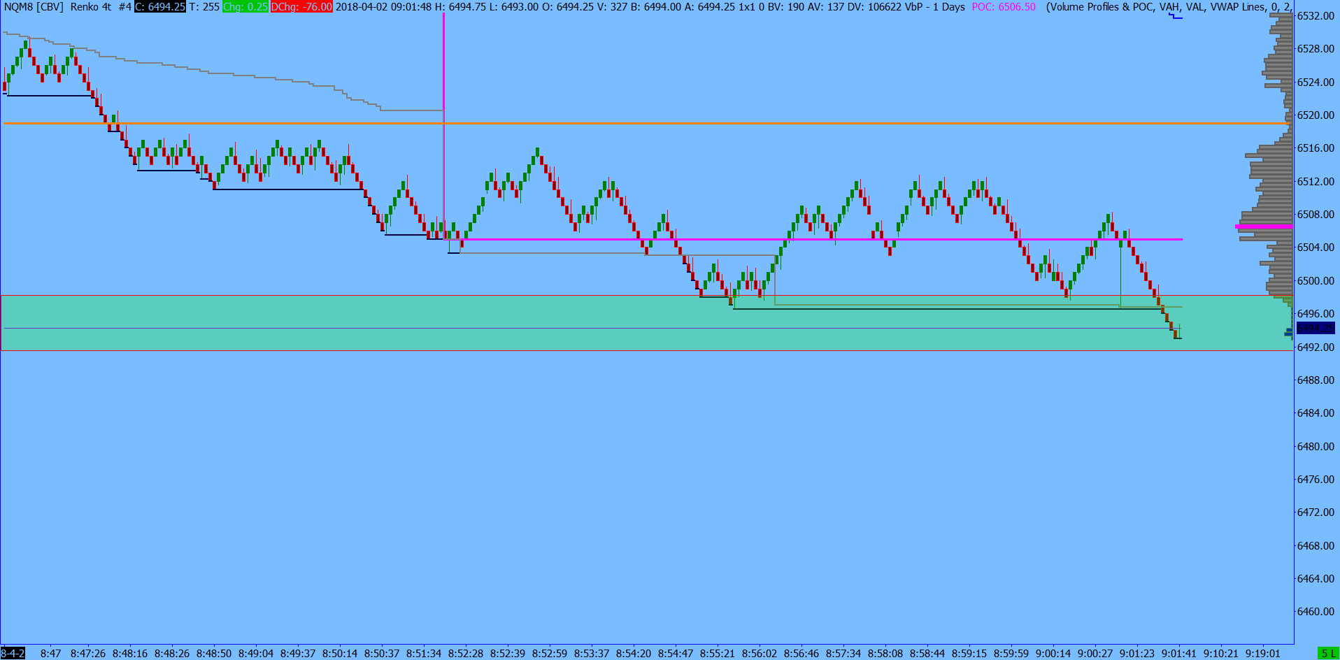

[2018-04-02 14:09:32]
The 4-tick renko bar problem has reappeared. please refer to the bar at 09:01:22 on the attached chart.
http://www.sierrachart.com/image.php?Image=1522677709178.png
Date Time Of Last Edit: 2018-04-02 14:21:04

[2018-04-04 01:27:37]
We tried to reproduce the problem using TransAct data and could not. The reason for the problem previously was very obvious. There was a very clear coding error which caused a problem when using the Renko mode which starts a new bar when the open is crossed. Now that is fixed, it is puzzling to us why this would still occur.
This is why we asked for the chartbook to try to reproduce it.
Date Time Of Last Edit: 2018-04-04 01:27:53

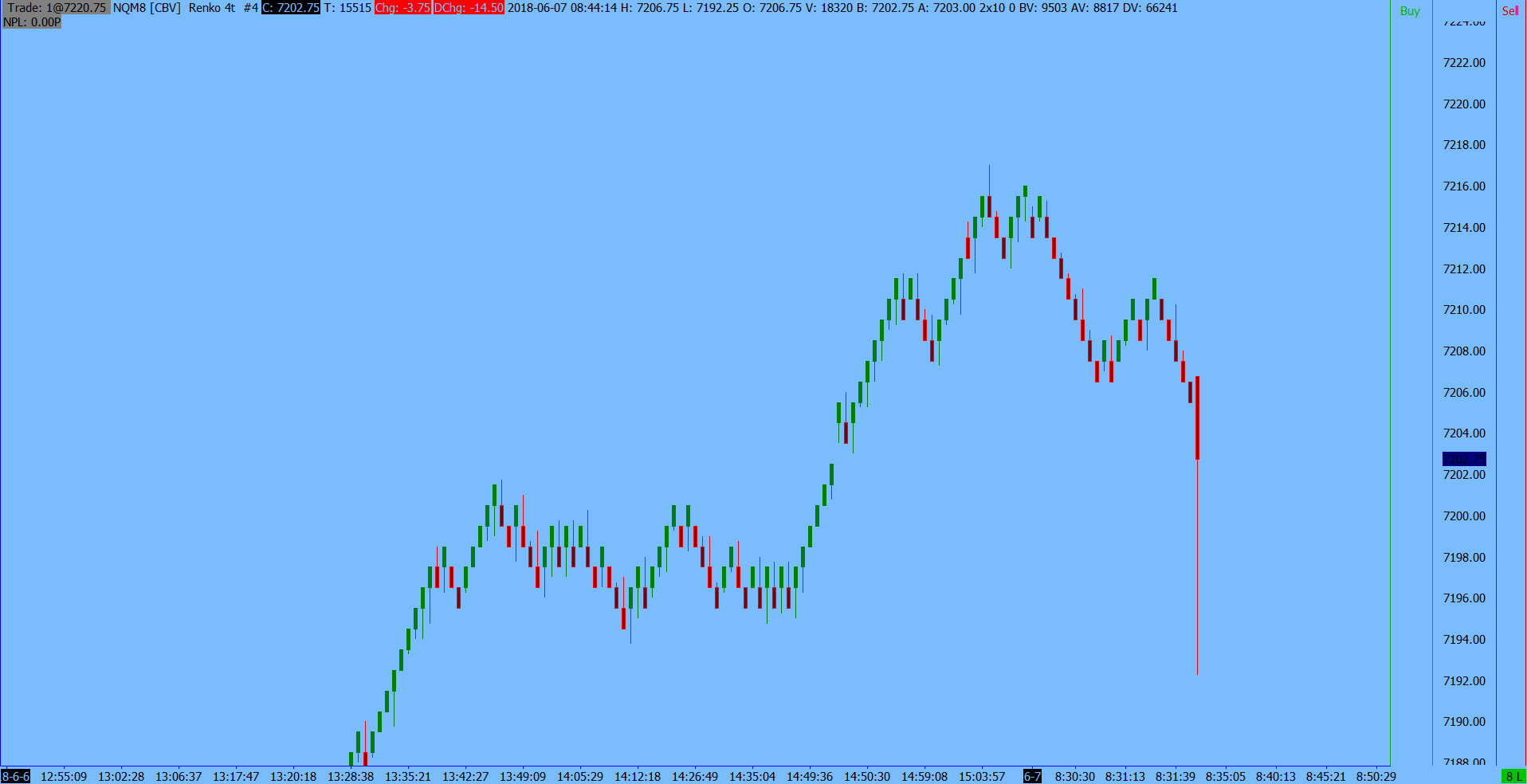

[2018-06-07 13:45:13]
This appears to be happening again.
The chart is on the June Contract.
i'm not sure if it is related, but i did recently upgrade to the latest version, 1750.
http://www.sierrachart.com/image.php?Image=1528379055951.png
Date Time Of Last Edit: 2018-06-07 13:45:58
