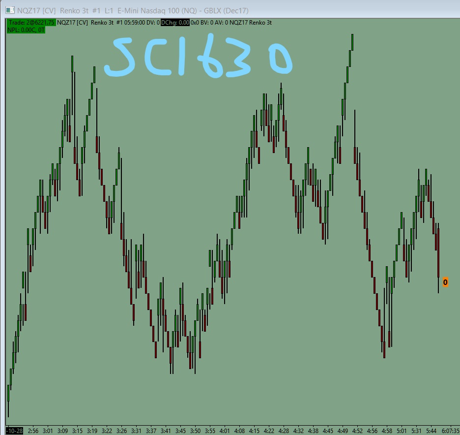

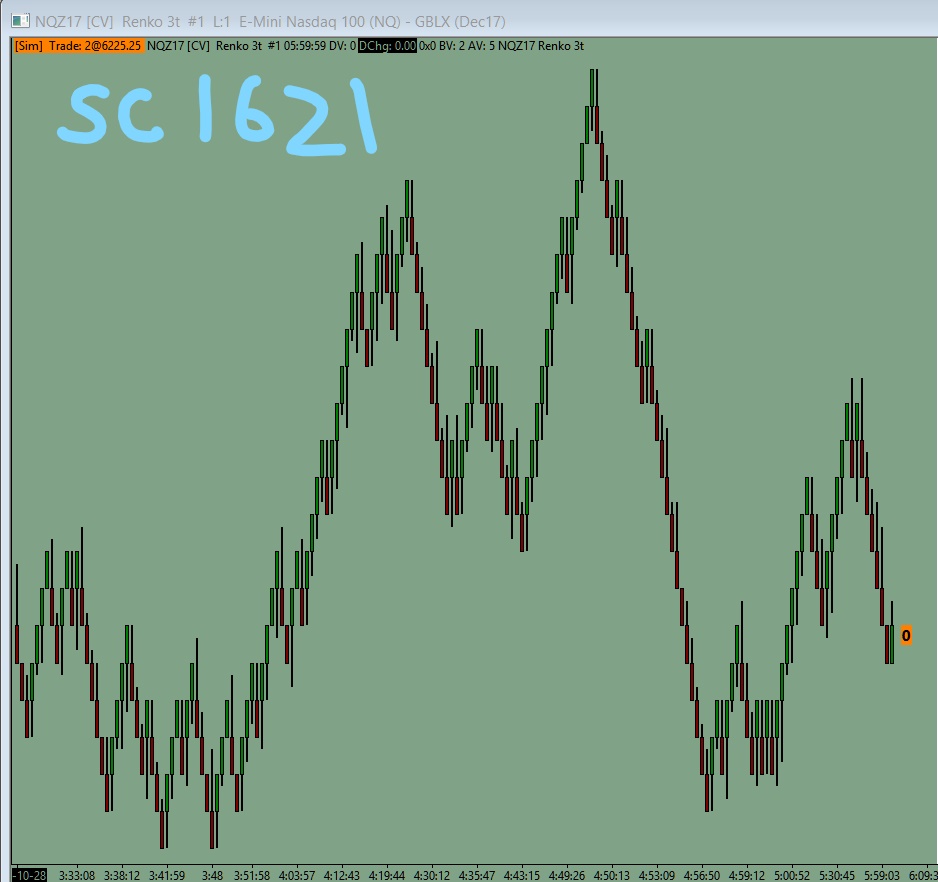

I've just updated to version 1630, and found out that the Renko bars are completely messed up. I have attached two pictures of the same chart from both 1621 and 1630, I believe the difference is rather unmistakable.

both charts are from exactly the same trading session, and with the same settings:
bar period type:
for version 1621 - Renko Bar (in ticks) - 3 - fill session gap not selected
for version 1630 - Renko Bar (in ticks) - 3 - none
Graph Draw Type - Renko bar with wicks

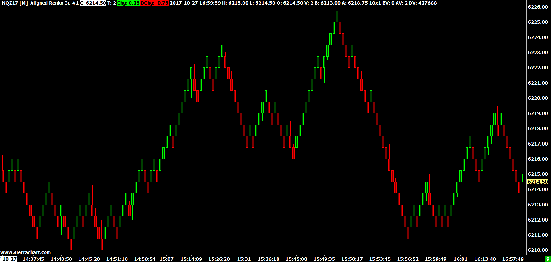

This is what we see on version 1630:
http://www.sierrachart.com/image.php?Image=1509265917566.png
This is using Aligned Renko and the Fill All Bar Gaps option.
There is no automatic gap filling unless you enable that option. Refer to:
Renko Bar Charts: Filling of Price Gaps with Renko Bars

Here is the documentation about the filling of gaps in Renko Charts:
Also it appears that the real problem is that there is missing data in the chart data file for that symbol:
https://www.sierrachart.com/Download.php?Folder=SupportBoard&download=14026
Follow the instructions here:
Or the Intraday Data Storage Time Unit is not set to 1 second or 1 Tick:
So as you can see, this claim is completely false:
Before you make such a claim, look at the underlying data and use common sense.
No, not at all. It should be obvious there is missing data. Also, you are just too used to the manipulations being done with Renko bars and accustomed to the nonsense. By default, the changes to Renko bars are going to represent the actual price activity as best as possible without gap filling or fake alignments.
