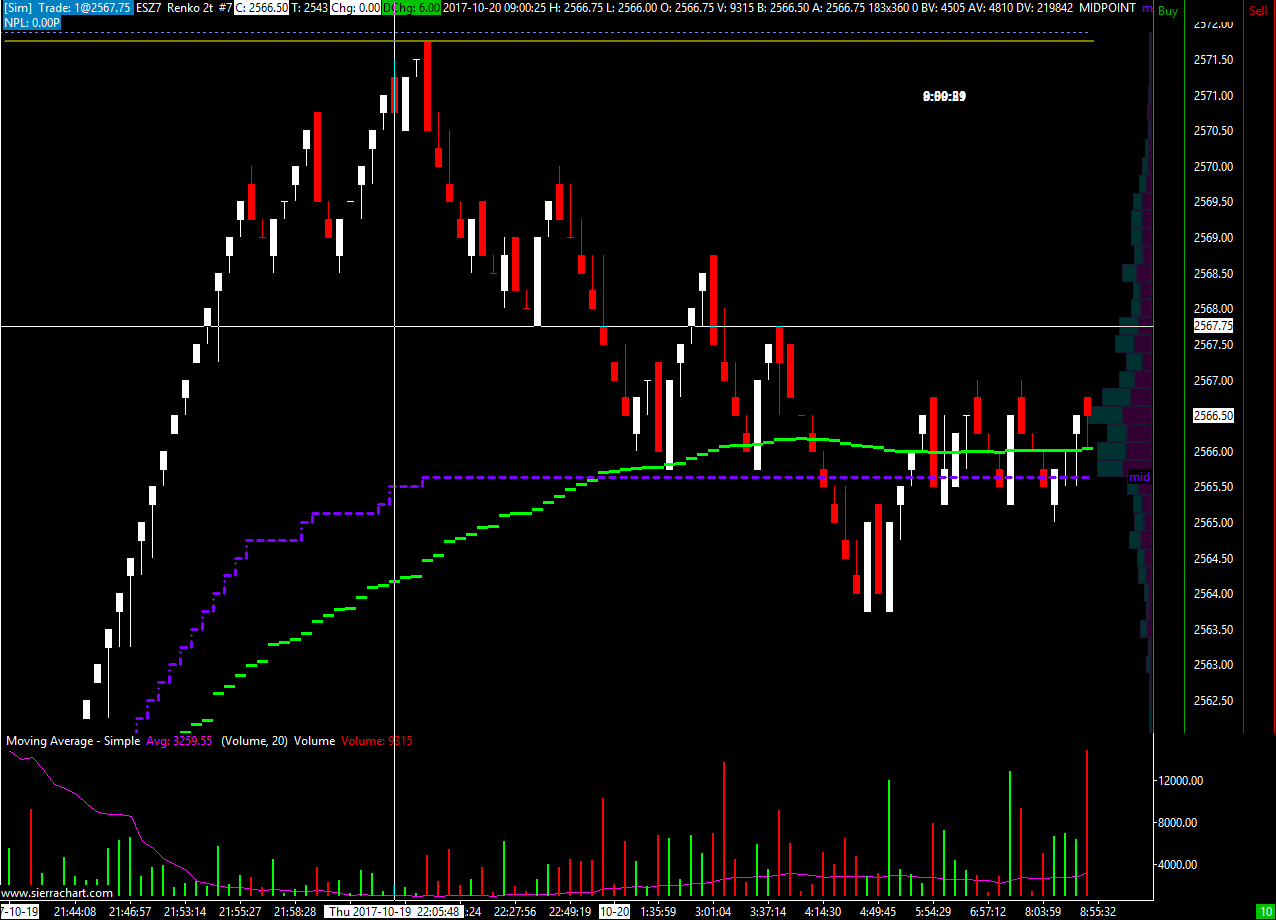

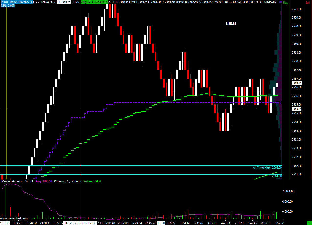

I downloaded the new version and still see a problem. I might be wrong, but I like renko bars because they are not based on time so a new bar changes after a set tic move in price. Candlesticks instead form a new bar after a set time interval. Anyways I attached chart with the two different versions, there is clearly a difference.
http://www.sierrachart.com/image.php?Image=1508504091598.png
http://www.sierrachart.com/image.php?Image=1508504427638.png

I noticed the same thing with the latest 1625 Pre-release. Since my thread was locked (after I was asked to try the recent changes), I guess I'll just chime in here. When Renko With Wicks was first removed you had to physically select Candlestick Bars to get the new Renko Bar and your old charts didn't update to it automatically. Then that was addressed with an update after it was brought to their attention and charts would default correctly and they fixed a bar width issue introduced with the new changes. NOW, with the latest update of 1625 and the re-introduction of Renko with Wicks, selecting Candle Stick Bars (as we were asked to try because this is a better implementation of Renko) now gets us a chart that looks like your second #....638 image.

In response to post # 11, in this chart:
What is Chart >> Graph Draw Type >> Candlestick set to? Also make sure you are on the current version. Follow the instructions here:
The new renko bars do not work as the traders here would like to see. I think that should be obvious at this point and of prime importance. Please adjust them back accordingly.
thank you
We have 0% idea what you are referring to here. And no, it is not obvious whatsoever to us. The only issue we have seen is for those who want to use Candlestick with Renko bars as it used to work before, that was not supported. It is now. You need to explain what the issue is. And provide a chart image and start a separate support request and do not post in this one, please.
