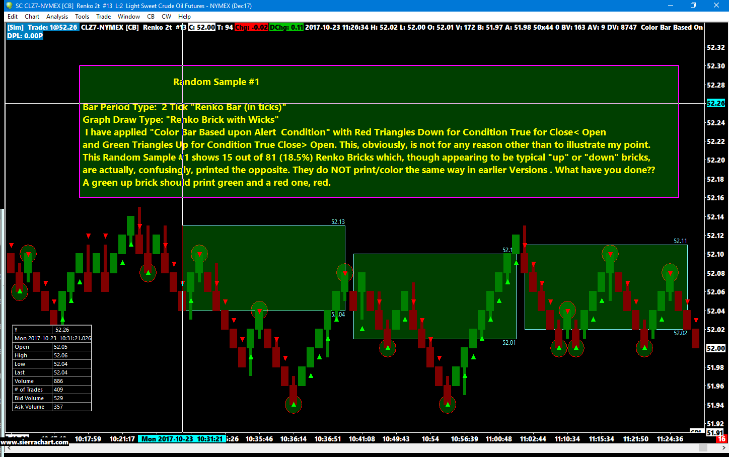

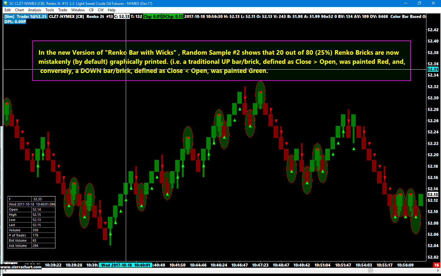

But to "deconstruct" the essence of traditional Renko up/down bricks to the point where those bricks are even "mis-painted" graphically, is hard to fathom. I present in the accompanying attached screenshots, two (2) Random Samples of 80 bricks apiece, of the basic Renko Bar/Renko Bricks with Wicks from new Version 1626. I have applied "Color Bar Based upon Alert Condition" with Red Triangles Down for Condition True for Close< Open and Green Triangles Up for Condition True Close> Open. This, obviously, is not for some "strategy", but only to demonstrate the following point:
This Random Sample #1 shows 14 out of 81 (17%) Renko Bricks which, though appearing to be typical "up" or "down" bricks, are actually, confusingly, the opposite. These errors actually occur precisely at many "swing" vertices!They do NOT print the same way in earlier Versions. What have you done?? A green up brick should print green and a red one red. In the new Version of "Renko Bar with Wicks" , Random Sample #2 shows that 20 out of 80 (25%) Renko Bricks are now mistakenly (by default) graphically printed(i.e. a traditional UP bar/brick, defined as Close > Open (alerted by green up triangle), was painted Red, and, conversely, a DOWN bar/brick, defined as Close < Open (red down triangle), was painted Green.
