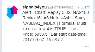

Autotrade8 - Posts: 26
I'm a little curious about the progress to be able to receive the tweets as a normal twitter message. The message I'm still receiving now as a DM Twitter there is a whole lot of text that I really don't want. Is there a way that I have any influence on that? Because it does not matter if I unchecked or checked the Include Alert Name and / or Alert comment boxes. I want only the name of the underlying asset, Price, Time and LONG or SHORT. That's all. All the other is irrelevant

[2017-09-08 18:06:52]
Currently there is no way to customize the particular Alert Message sent from a study.

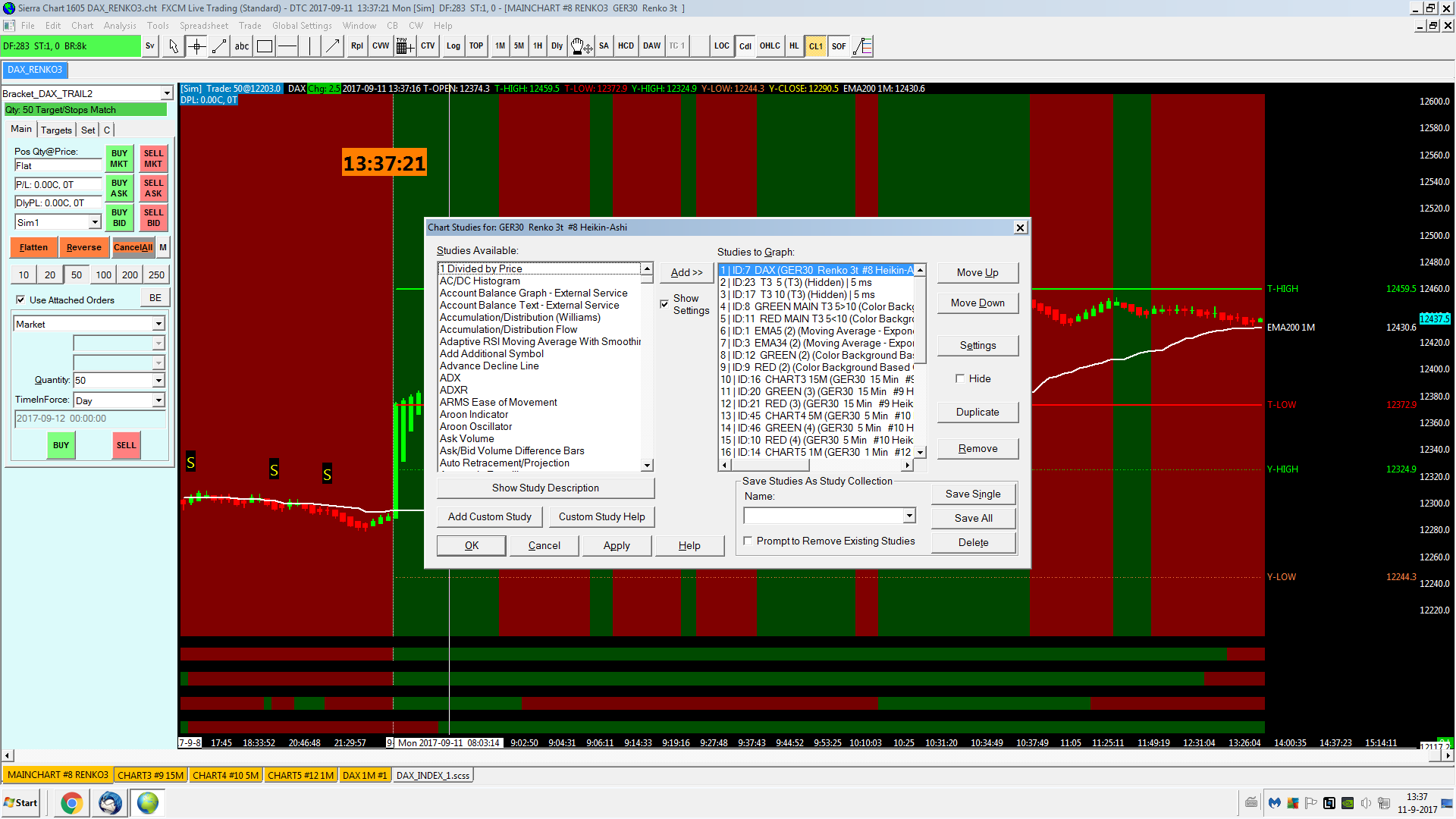

Maybe it is possible what I want but I have tried so many but I didn't succeed. Maybe you can help me? Please, look at the image. In the alert I am receiving I don't want the text "ID:7 DAX (GER30 Renko 3t #8 Heikin-Ashi)". I have tried in settings the Short name and I tried to change the name in cell A1 of the spreadsheet but that's not allowed....
imageDAX_STUDY_RENAME.png / V - Attached On 2017-09-11 11:44:14 UTC - Size: 140.97 KB - 582 views
[2017-09-11 16:13:40]
OK, we will just include the short name only for the study name in the alert message.
