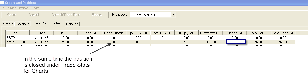

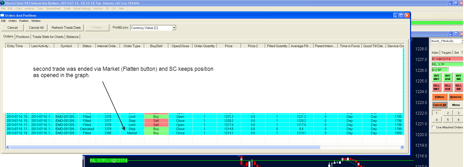

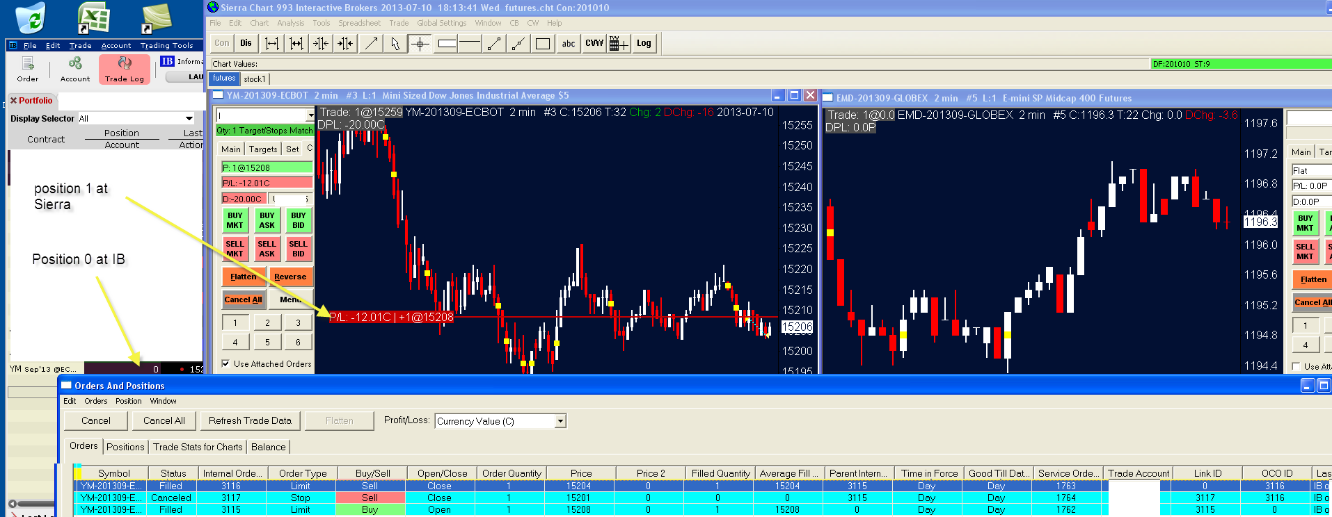

Have a look at included screenshots:
Sierra prints the nonexisting short positions in the Positions tab (altough in IB the position is already flat), but in the same time Sierra is flat under Trade stats for Charts!
If I refresh the tab via „Refresh Trade Data“ nothing happens. I have to get rid of the position only via menu Position > Clear Selected Position Data.
Please send me en email If you want to check it remotely. But how can you check it? This only happens while realtime trading ....
