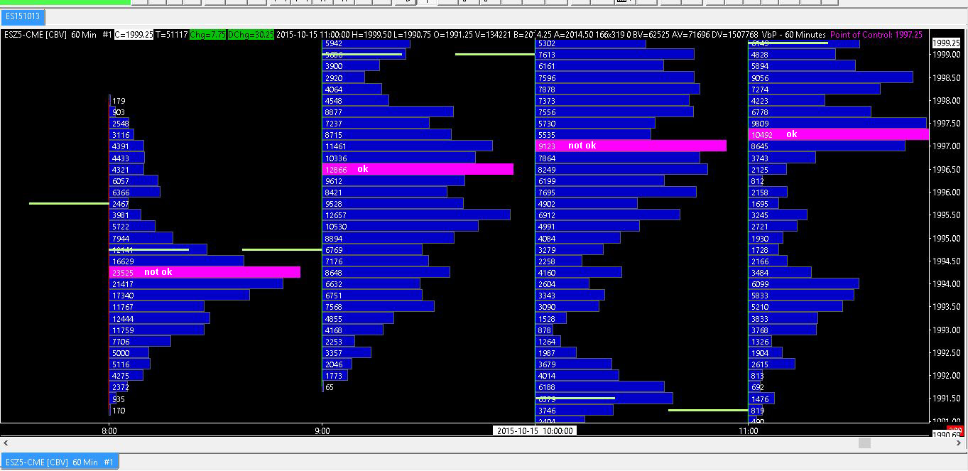

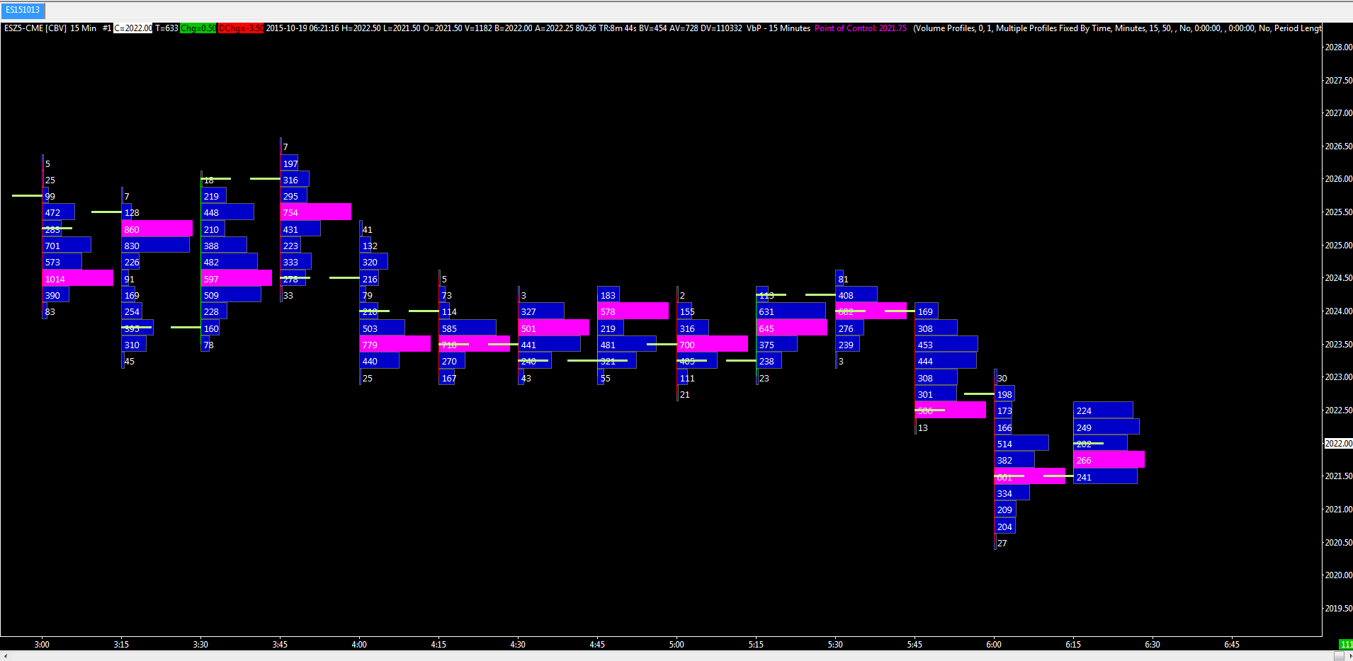

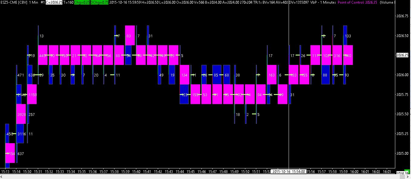

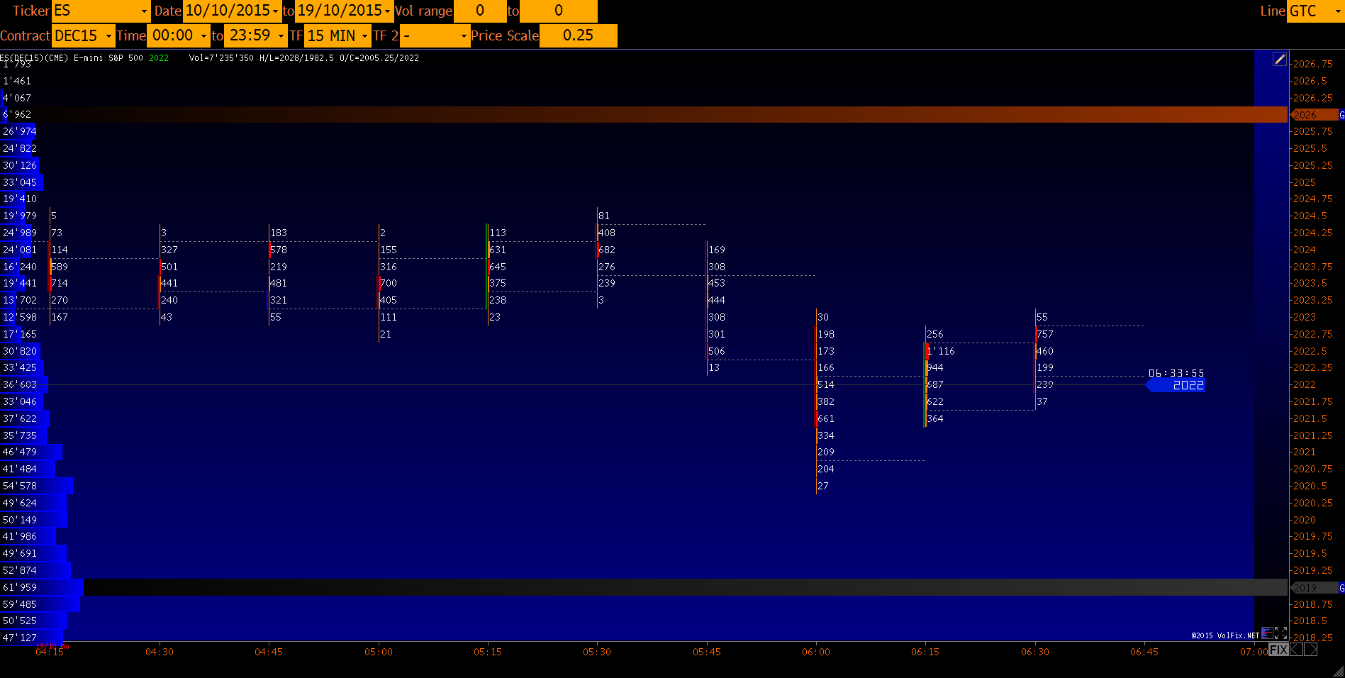

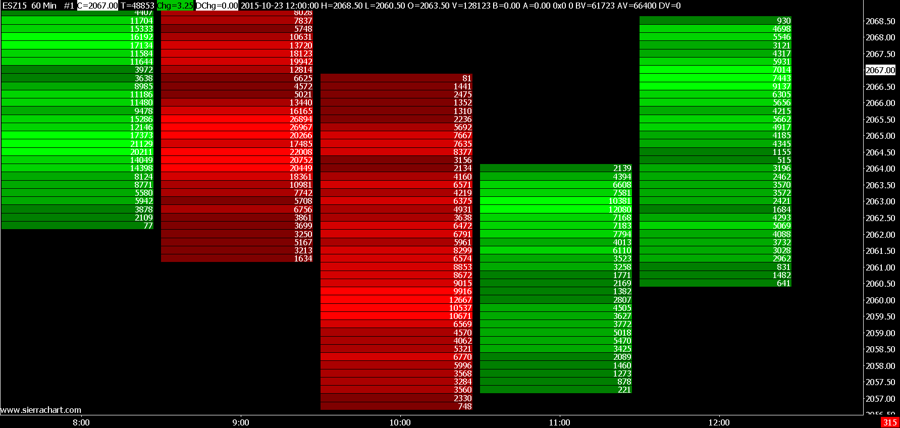

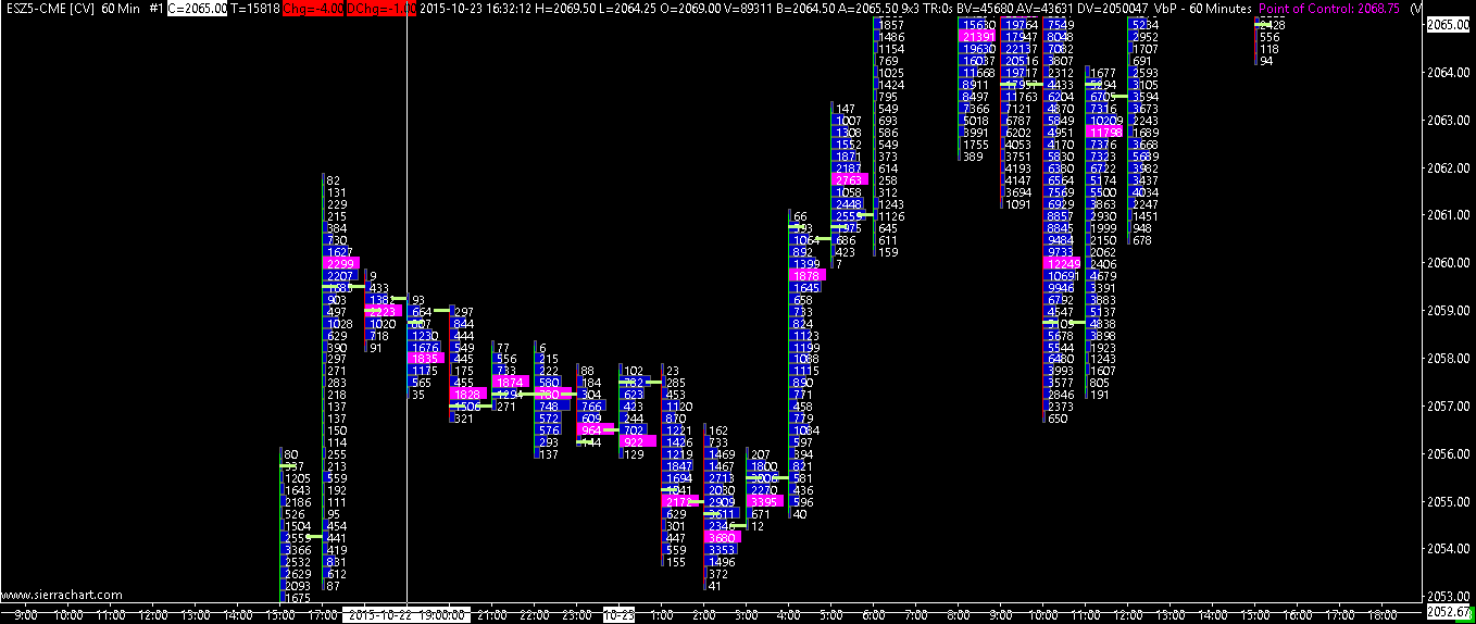

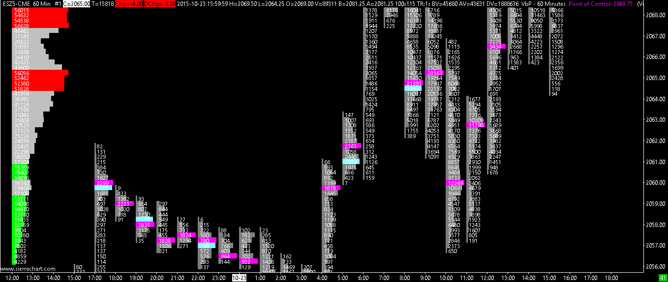

My Volume by price results from SierraChart differ form other trading platforms volume by price results. Live results are identical, but little back are different. Somebody knows why? Somebody compare VBP results from different trading platforms?
imagepic2.jpg / V - Attached On 2015-10-15 15:11:52 UTC - Size: 150.98 KB - 534 views
imagepic1.jpg / V - Attached On 2015-10-15 15:12:08 UTC - Size: 136.09 KB - 539 views
imagepic3.jpg / V - Attached On 2015-10-15 15:12:16 UTC - Size: 145.08 KB - 530 views

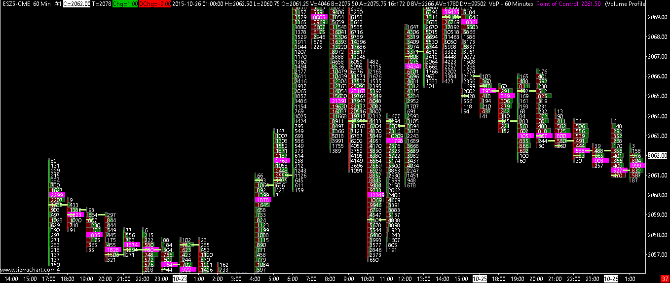

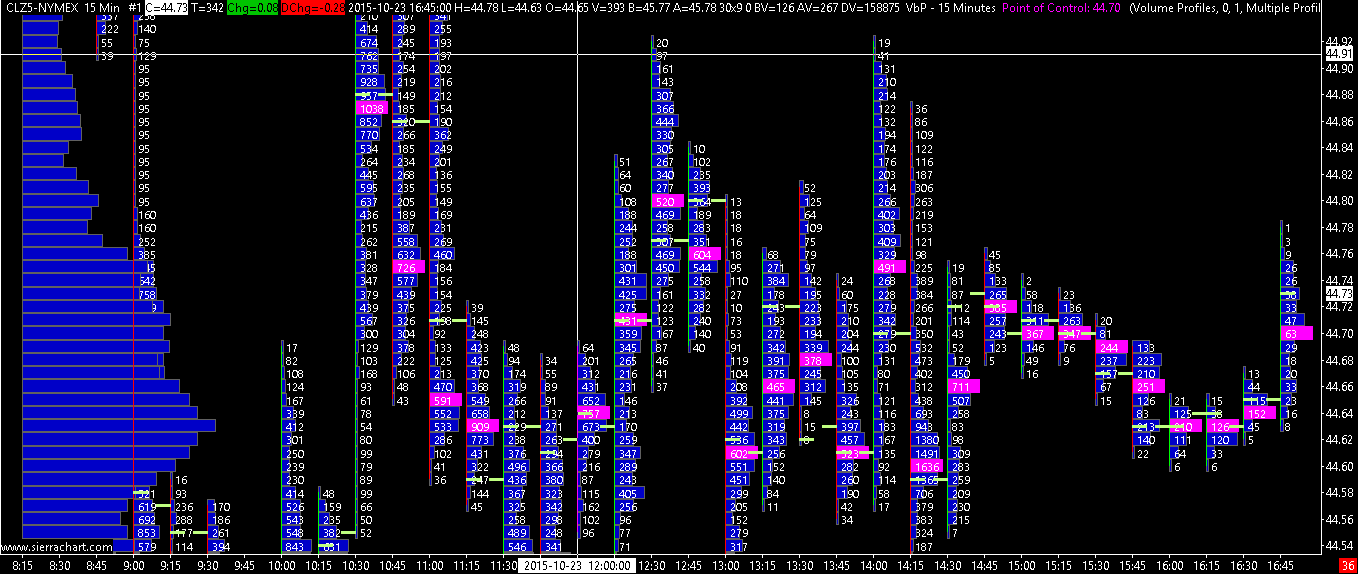

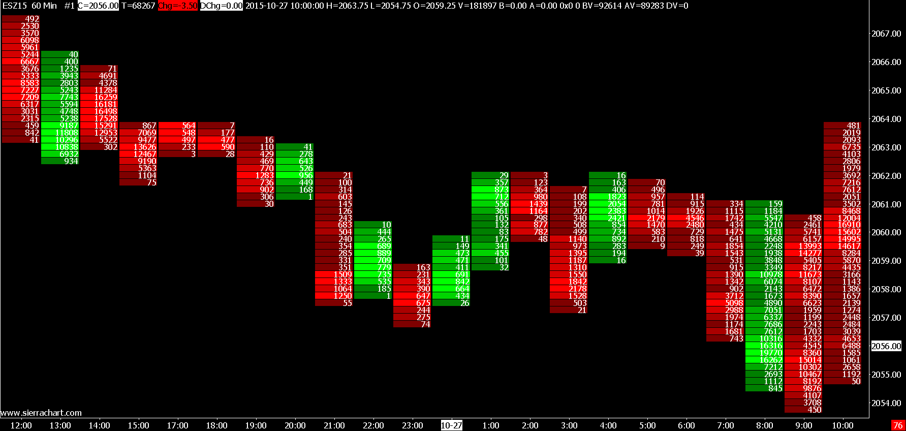

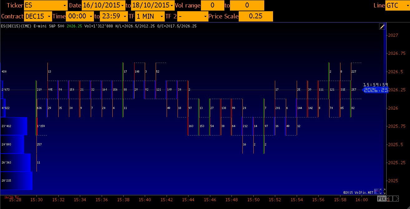

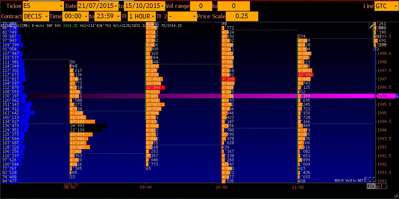

[2015-10-15 19:43:23]
User503358 - Posts: 50
today's data
imagepic6.jpg / V - Attached On 2015-10-15 19:42:49 UTC - Size: 226.29 KB - 575 views
imagepic5.jpg / V - Attached On 2015-10-15 19:42:56 UTC - Size: 160.56 KB - 495 views

[2015-10-15 20:24:33]
why?
[2015-10-15 20:31:33]
ganz - Posts: 1048
User503358
these guys are not pedantic
[2015-10-15 20:41:51]
I don't have other way to check results.

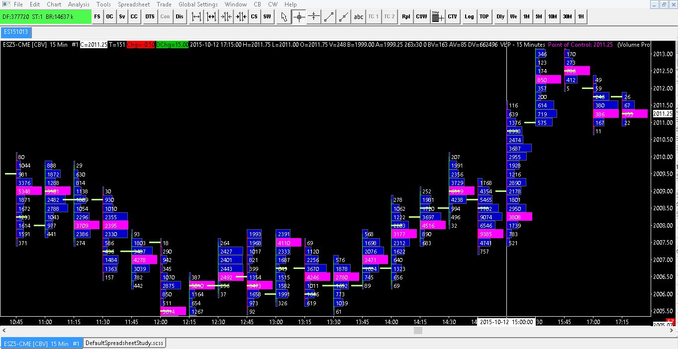

[2015-10-18 22:05:29]
Last 30 minutes distribution: total volume exactly the same for every bar, price count for every bar is identical, but volume distribution between prices is differ. what do you suggest to check?
imagepic7.jpg / V - Attached On 2015-10-18 22:04:55 UTC - Size: 101.87 KB - 578 views
imagepic8.jpg / V - Attached On 2015-10-18 22:05:02 UTC - Size: 95.25 KB - 573 views
[2015-10-18 22:27:01]
As long as you have a tick by tick data configuration:
You can be assured that the volume of each price level is correct.

[2015-10-22 16:24:37]
check this volumes please.

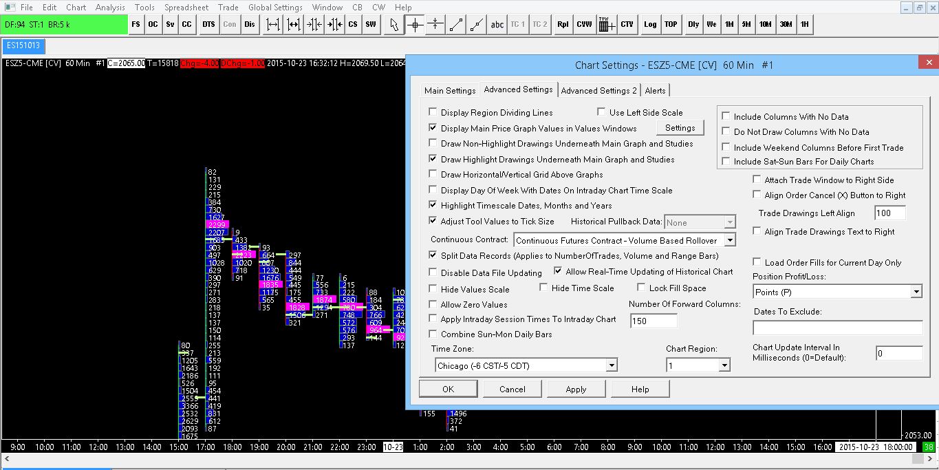

[2015-10-24 04:28:18]
We apologize for the delay. We need to know what that Time Zone you have Sierra Chart set to, and the Session Times settings in Chart >> Chart Settings.
Also post an image of the chart contain the Volume by Price study by following these instructions here:
We will compare to the data we have on the server.
Date Time Of Last Edit: 2015-10-24 04:29:21

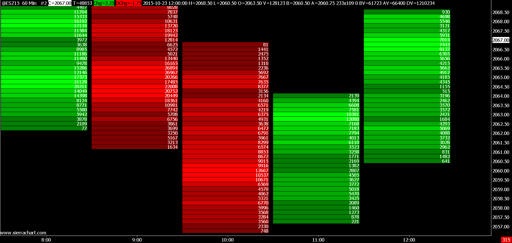

[2015-10-27 20:12:21]
First we want to apologize for the long delay with this.
We are quite busy. We needed to have the time to examine this closely.
We have now done that. We have only examined one of the charts and that is the chart in post #16. We will not examine any other charts. We can see that the volume at price levels are significantly inaccurate in that chart.
This is what you should see for 2015-10-23:
http://www.sierrachart.com/image.php?l=1445976552303.png (IQ Feed)
http://www.sierrachart.com/image.php?l=1445976642993.png
(SC Historical Data)
All times are US central time.
If you re-download the data in the chart by following the instructions here:
You should get a match to what we show.

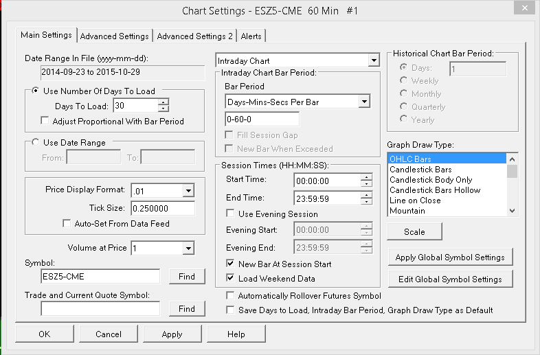

[2015-10-29 10:14:41]
I performed full reset. nothing changes.
http://www.sierrachart.com/image.php?l=1446113090349.png

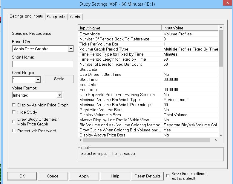

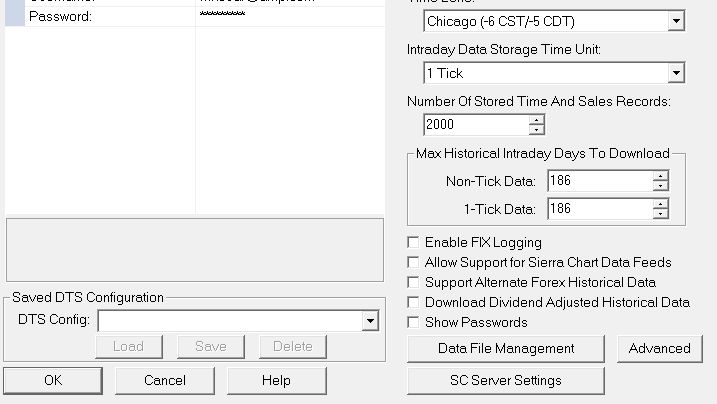

my configurations is here:
imagepic11.jpg / V - Attached On 2015-10-29 10:13:35 UTC - Size: 90.95 KB - 460 views
imagepic12.jpg / V - Attached On 2015-10-29 10:13:45 UTC - Size: 96.02 KB - 528 views
imagepic13.jpg / V - Attached On 2015-10-29 10:13:53 UTC - Size: 48.01 KB - 532 views
imagepic14.jpg / V - Attached On 2015-10-29 10:14:07 UTC - Size: 103.97 KB - 519 views

Socket (0) | Resolved address ds6.sierracharts.com to IP 8.18.161.131 | 2015-10-31 16:53:12
Socket (5) | Connected. | 2015-10-31 16:53:12
HD Request # 2 | Sending historical data logon request message. | 2015-10-31 16:53:12
HD Request # 2 | Requesting Intraday data. Start Date-Time: 2015-10-30 15:59:59. Record interval: 1. Symbol: ESZ15 | 2015-10-31 16:53:12
HD Request # 2 | Decompressing data. | 2015-10-31 16:53:12
HD Request # 2 | Receiving Intraday data for ESZ5-CME starting at 2015-10-30 15:59:59 | 2015-10-31 16:53:12
HD Request # 2 | Timestamp of first Intraday data file record written: 2015-10-30 15:59:59 | 2015-10-31 16:53:12
Socket (5) | Shutdown and closed. | 2015-10-31 16:53:12
The network socket for historical data has been closed. | 2015-10-31 16:53:12
HD Request # 2 | Received 1 record from 2015-10-30 15:59:59 to 2015-10-30 15:59:59 (0.0 seconds) and wrote 1 record for ESZ5-CME | 2015-10-31 16:53:12
HD Request # 2 | Intraday download COMPLETE for ESZ5-CME. Completion time: 0s. Unique request ID: 1 | 2015-10-31 16:53:12
Removed historical data download ID 1 | 2015-10-31 16:53:12
Real-time Intraday chart data file updates started for ESZ5-CME | 2015-10-31 16:53:12
Intraday data recording state for symbol ESZ5-CME is set to download 'Pending'. | 2015-10-31 16:53:12
HD Request # 3 | Downloading Intraday chart data for ESZ5-CME to the file ESZ5-CME.scid. Service: rim | 2015-10-31 16:53:12
HD Request # 3 | Download start Date-Time: 2015-10-30 15:59:59.000 | 2015-10-31 16:53:12
HD Request # 3 | Sending historical data request. Start Date-Time: 2015-10-30 15:59:59. Record interval: 0. Symbol: ESZ5-CME | 2015-10-31 16:53:12
Rithmic Trading | Requesting historical Tick data. | 2015-10-31 16:53:12
HD Request # 3 | Error downloading historical Intraday data for ESZ5-CME. Error downloading historical Tick data. Error: no data | 2015-10-31 16:53:12
HD Request # 3 | Received 0 records from 00:00:00 to 00:00:00 (0.0 seconds) and wrote 0 records for ESZ5-CME | 2015-10-31 16:53:12
HD Request # 3 | Intraday download COMPLETE for ESZ5-CME. Completion time: 0s. Unique request ID: 3 | 2015-10-31 16:53:12
Removed historical data download ID 3 | 2015-10-31 16:53:12
| Reloading chart. | 2015-10-31 16:53:26
ESZ5-CME 60 Min #1 | Reloading chart. | 2015-10-31 16:54:00
Requesting symbol settings for ddf. Overwrite = on. | 2015-10-31 16:55:29
HTTP connection to www.sierrachart.com:80 (0) | Resolved address sierrachart.com to IP 5.9.8.236 | 2015-10-31 16:55:29
HTTP connection to www.sierrachart.com:80 (7) | Connected. | 2015-10-31 16:55:29
Symbol settings received. | 2015-10-31 16:55:32
Processed received symbol settings | 2015-10-31 16:55:32
HTTP connection to www.sierrachart.com:80 (7) | Closed. No error. | 2015-10-31 16:55:37
HTTP connection to www.sierrachart.com:80 (7) | Shutdown and closed. | 2015-10-31 16:55:37
Requesting symbol settings for rim. Overwrite = on. | 2015-10-31 16:55:51
HTTP connection to www.sierrachart.com:80 (0) | Resolved address sierrachart.com to IP 5.9.8.236 | 2015-10-31 16:55:51
HTTP connection to www.sierrachart.com:80 (8) | Connected. | 2015-10-31 16:55:51
Symbol settings received. | 2015-10-31 16:55:51
Processed received symbol settings | 2015-10-31 16:55:51
HTTP connection to www.sierrachart.com:80 (8) | Closed. No error. | 2015-10-31 16:55:56
HTTP connection to www.sierrachart.com:80 (8) | Shutdown and closed. | 2015-10-31 16:55:56
Intraday data recording state for symbol ESZ5-CME is set to download 'Pending'. | 2015-10-31 16:56:07
Reloading all charts with filename: ESZ5-CME.scid | 2015-10-31 16:56:07
HD Request # 4 | Downloading Intraday chart data for ESZ5-CME to the file ESZ5-CME.scid. Service: cme | 2015-10-31 16:56:07
HD Request # 4 | Download start Date-Time: 2015-04-28 16:56:07.000 | 2015-10-31 16:56:07
HD Request # 4 | Using server: scdf2.sierracharts.com port 10149 | 2015-10-31 16:56:07
Socket (0) | Resolved address ds7.sierracharts.com to IP 8.18.161.133 | 2015-10-31 16:56:07
Socket (9) | Connected. | 2015-10-31 16:56:07
HD Request # 4 | Sending historical data logon request message. | 2015-10-31 16:56:07
HD Request # 4 | Requesting Intraday data. Start Date-Time: 2015-04-28 16:56:07. Record interval: 1. Symbol: ESZ15 | 2015-10-31 16:56:07
ESZ5-CME 60 Min #1 | Reloading chart. | 2015-10-31 16:56:07
Currently no data in file to display. Will start historical data download and real-time updates. File: D:\SierraChart\Data\ESZ5-CME.scid | 2015-10-31 16:56:07
HD Request # 4 | Decompressing data. | 2015-10-31 16:56:07
HD Request # 4 | Receiving Intraday data for ESZ5-CME starting at 2015-04-28 23:52:30 | 2015-10-31 16:56:07
HD Request # 4 | Timestamp of first Intraday data file record written: 2015-04-28 23:52:30 | 2015-10-31 16:56:07
Socket (9) | Shutdown and closed. | 2015-10-31 16:56:37
The network socket for historical data has been closed. | 2015-10-31 16:56:37
HD Request # 4 | Received 1429337 records from 2015-04-28 23:52:30 to 2015-10-30 15:59:59 (184.7 days) and wrote 1429337 records for ESZ5-CME | 2015-10-31 16:56:37
HD Request # 4 | Intraday download COMPLETE for ESZ5-CME. Completion time: 30s. Unique request ID: 4 | 2015-10-31 16:56:37
Removed historical data download ID 4 | 2015-10-31 16:56:37
Real-time Intraday chart data file updates started for ESZ5-CME | 2015-10-31 16:56:37
Intraday data recording state for symbol ESZ5-CME is set to download 'Pending'. | 2015-10-31 16:56:37
HD Request # 5 | Downloading Intraday chart data for ESZ5-CME to the file ESZ5-CME.scid. Service: rim | 2015-10-31 16:56:37
HD Request # 5 | Download start Date-Time: 2015-10-30 15:59:59.000 | 2015-10-31 16:56:37
HD Request # 5 | Sending historical data request. Start Date-Time: 2015-10-30 15:59:59. Record interval: 0. Symbol: ESZ5-CME | 2015-10-31 16:56:37
Rithmic Trading | Requesting historical Tick data. | 2015-10-31 16:56:37
HD Request # 5 | Error downloading historical Intraday data for ESZ5-CME. Error downloading historical Tick data. Error: no data | 2015-10-31 16:56:38
HD Request # 5 | Received 0 records from 00:00:00 to 00:00:00 (0.0 seconds) and wrote 0 records for ESZ5-CME | 2015-10-31 16:56:38
HD Request # 5 | Intraday download COMPLETE for ESZ5-CME. Completion time: 0s. Unique request ID: 5 | 2015-10-31 16:56:38
Removed historical data download ID 5 | 2015-10-31 16:56:38
Real-time Intraday chart data file updates started for ESZ5-CME | 2015-10-31 16:56:38
[2015-11-01 00:51:39]
As we indicated in post #10 and #18 you need to set Sierra Chart to a tick by tick data configuration as explained here:
Also the documentation we linked you to in the beginning did state this as well. This is the problem:

[2015-11-02 07:37:15]
Yes, I see, that I can't download tick by tick data. I set 1 tick data, but download failed and SC shows me 1 second data. What is the problem? Rythmic? What to do?
[2015-11-02 07:54:38]
Yes actually that is true and that is a detail we overlooked. The problem is you are on Sierra Chart service package 3.
You will need to contact your broker and have them put you on service package 5.
