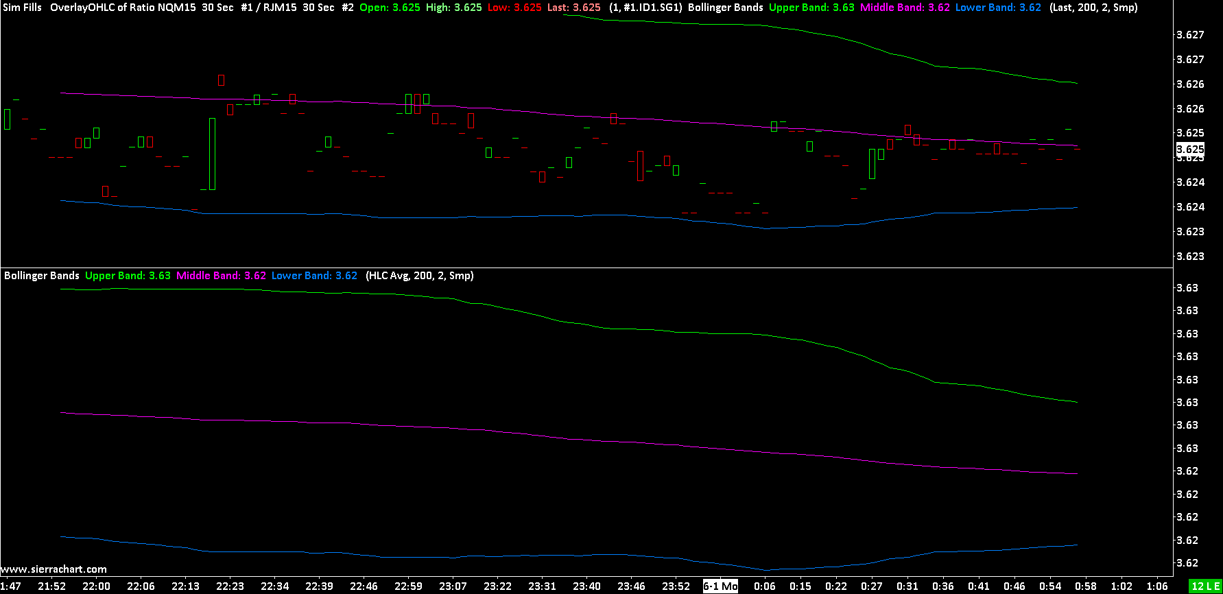

Only open, high, low, or last settings work. Use of anything involving the remaining 4 common settings (of which the default is HLC average) causes the bands to explode.
imagesc_ohlc_overlay_bb_0.png / V - Attached On 2015-05-18 06:56:40 UTC - Size: 94.71 KB - 773 views
imagesc_ohlc_overlay_bb_1.png / V - Attached On 2015-05-18 06:56:50 UTC - Size: 78.9 KB - 682 views

This is a BUG. The study is simply not working correctly using a data source that I'm following YOUR directions on for setting up a high precision spread.
How the heck am I even supposed to make this work with the normal HLC average setting?!! You can see it right there with the screen captures that its blowing up when I use the most basic default BB setting. It's not even remotely logical or normal tbat the BB study should do this nor is it even an issue with zero values or anything like that. You can see the OHLC values right on the chart.

All I'm basically doing is adding a bollinger band to a "high accuracy" spread as per the instructions offered on the Sierra Chart website. In my particular case the input to the OverlayOHLC study is a Spread - Butterfly study but it'll act exactly the same using Diff (single line).
It's basically the OverlayOHLC study with bollinger bands. I'm also having another issue seemingly related to this where I have an alarm on a horizontal line within the region that has an OverlayOHLC study and it keeps getting triggered every single new bar with values of 0.00000 crossing the line (which is obviously not the case). It triggers the alarm like clockwork, every new bar. I feel these two issues are connected.
This most definitely resembles a bug. I'll upload both chartbooks in a bit.

#3: Two 1m OverlayOHLC studies, input is #1:ratio, one region with BB using last value and another region with BB using the default HLC average (which doesn't work). There's two regions just to show what I'm talking about.
I don't normally use these in 30s/1m timeframes, but reduced the time window to demonstrate the alarms firing off all the time. I have a feeling that this general issue is related to the OverlayOHLC study using a spurious value of 0.0 somewhere internally (which is why it fires phantom alarms and possibly why the BB study freaks out). I also considered that the BB study with the default HLV average as input might have issues in general with any kind of line chart - but then I tested it with a simple price chart using a line for the graph draw type and it had no problems. It's specifically with the OverlayOHLC study that it has problems.
I also uploaded a capture of the alert window. Note: the alerts with reference to 60m are from the chartbook I actually use but the ones below which are 5m and 1m are from this chartbook I made just to demonstrate the issue.

OK we see why this happens. It is now fixed:
http://www.sierrachart.com/image.php?l=1433135841138.png
There was a problem setting the average values for the last array elements for the Overlay OHLC study.
