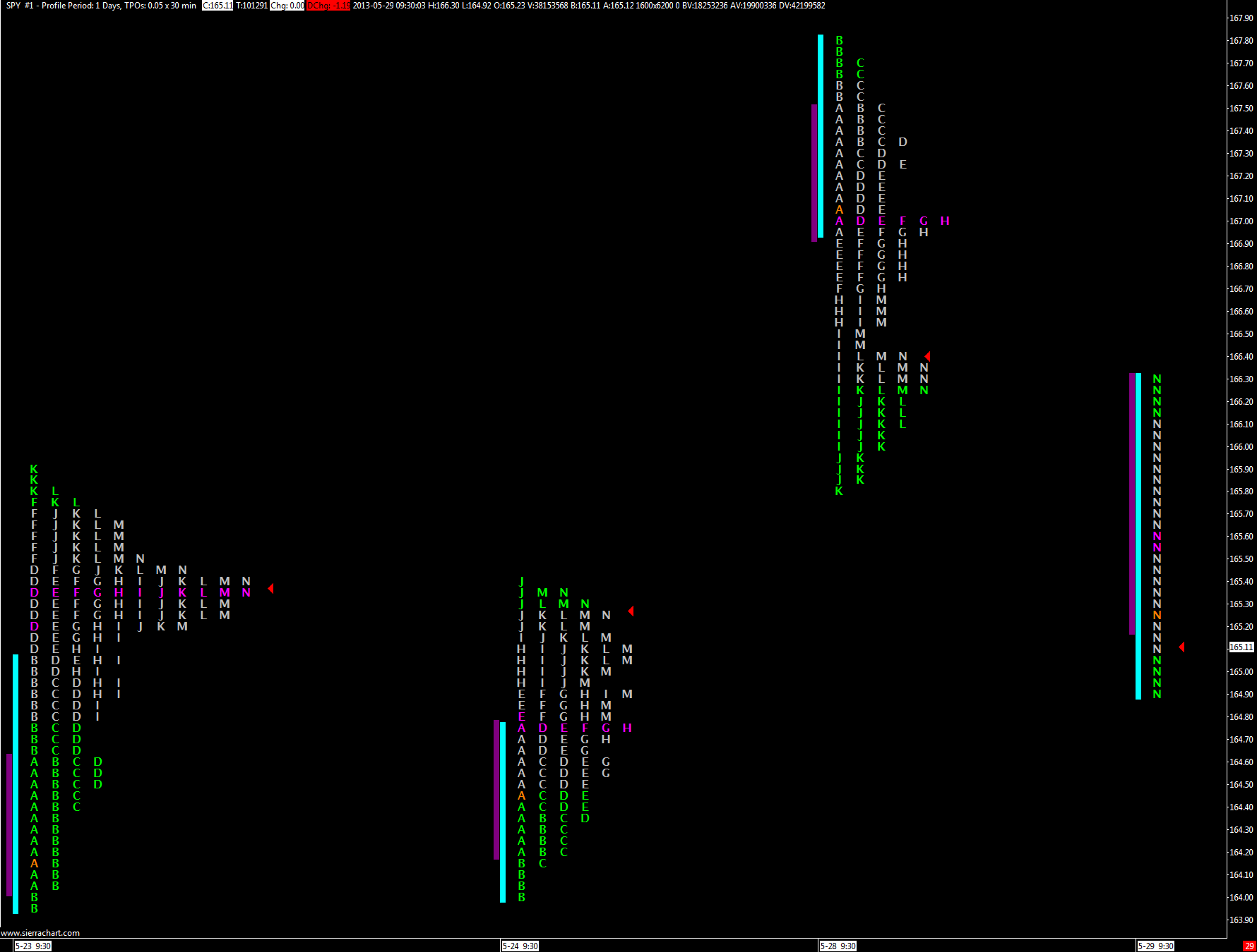

I have been using this study for the last couple weeks without any issues. However, this morning the letters associated with TPO are not behaving as expected despite unchanged settings.
1) Chart Settings for SPY are 09:30 - 16:00 without Evening Session
2) Study Settings are many so I attach screen shots of what I'm using. I have NOT customized TPO letters as per TPO Setting #4 attachment.
As can be seen from chart screen shot, the TPO profiles always start with the letter A but this morning it is starting with the letter N.
http://www.sierrachart.com/image.php?l=1369838215468.png
Furthermore, the TPO profile is stuck on the letter N and should have proceeded to the third letter because the time is 10:35am and we are into the third 30min period of the session.

We know exactly what the problem is. IQ Feed is sending incorrect timestamps with a timestamp value of 16:00. This is going to cause this kind of trouble.
This study is very sensitive to incorrect timestamps.
As we understand, IQ Feed has released a new client software program that solves this. You need to contact them and get that. Once that is done and installed and you are connected, right click on the chart before the last profile and select Delete and Download Data.

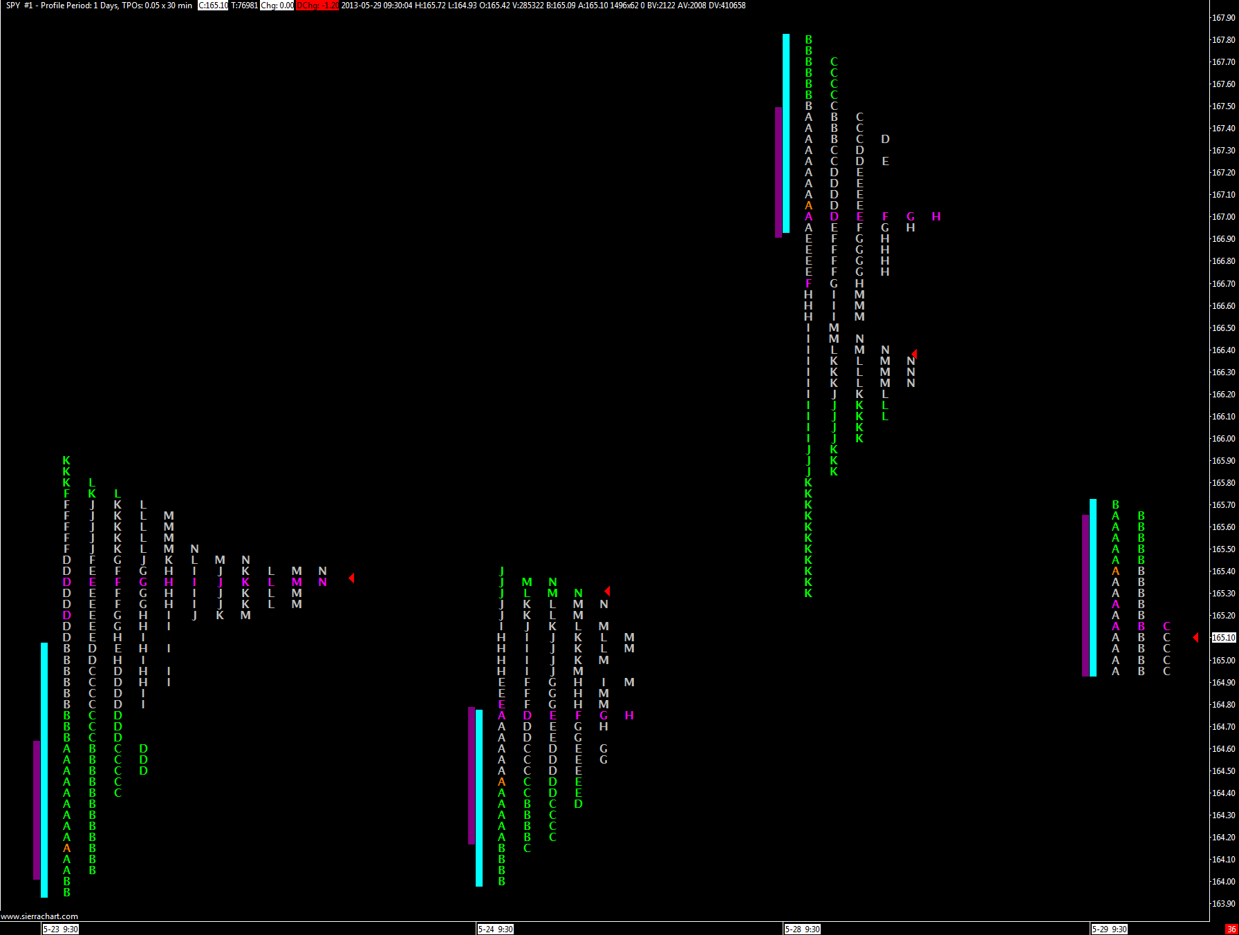

I just tried a different symbol (C) on the same chart and it seems to be working fine.
http://www.sierrachart.com/image.php?l=1369839709424.png
However, the chart for SPY is still problematic.
http://www.sierrachart.com/image.php?l=1369839857294.png
I think it must be related to the data file, and I just spotted this in the message log. I have underlined the relevant section. Think I'm getting closer to source of the problem if you could advise on best solution. I would prefer not to delete the file as I have a full 120 day history of tick data for SPY. Thank you.

[2013-05-29 15:19:30]
Please see post #2. For now right-click before the last TPO profile in the chart and select Delete and Download Data.
