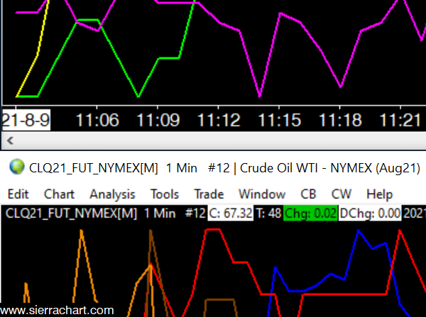

redneck4Christ - Posts: 12
Apologies for another post. I forgot to add that I have several line charts overlaid. This is 1 of 4 combined.
http://www.sierrachart.com/image.php?Image=1628533720186.png

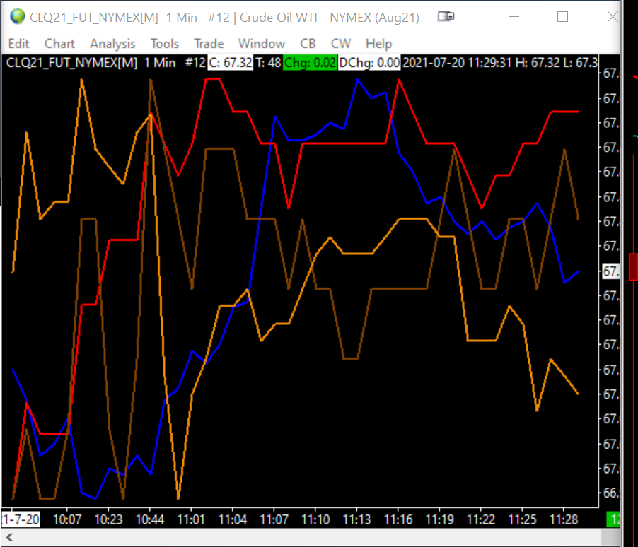

[2021-08-09 18:45:39]
This is what it should look like.
image2021-08-09_11-26-48 to SC suppport.png / V - Attached On 2021-08-09 18:45:30 UTC - Size: 103.8 KB - 374 views

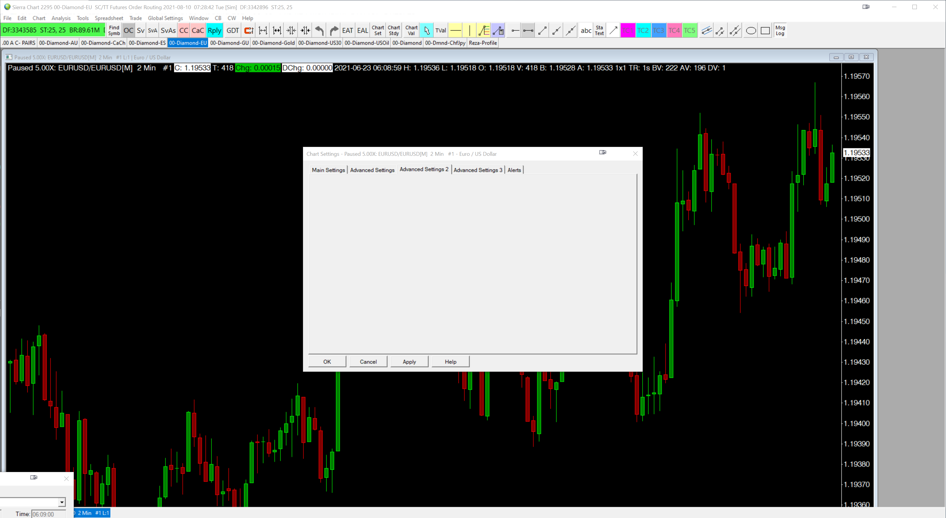

[2021-08-10 15:02:20]
I think my problem was not enough virtual memory. Task Manager showed all other memory less than 50% usage. I increased my virtual memory allocation after getting what you see attached and then trying to launch a browser and no browser would launch. Also, I was not able to make Chart Settings changes with the whole Chartbook (12 sets of multiple charts) open. I had to open individual chart groups to make any changes.
After increasing Win10 virtual memory, the Chart Settings works properly and I was able to launch this browser. If I crash again, I will try SC Safe Mode per your instructions. Thanks again.
