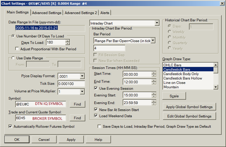

jivetrader - Posts: 410
help, i am still not getting any T&S info. please see my attached Chart Setup.
imageSIERRA SOURCE & DESTINATION COPIES DATA SHARING CHART CONFIG.png / V - Attached On 2015-01-21 22:17:03 UTC - Size: 48.76 KB - 532 views

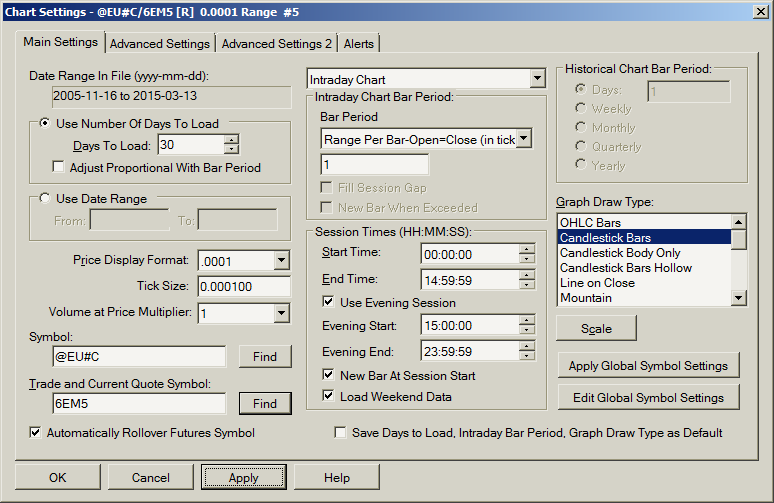

i have been through DTN support, s5trading support, and everyone agrees this is a Sierra issue. i have followed your directions on setting up my 2 copies of Sierra for DTN and OEC data, and everything works except i am not getting T&S prints transferred from the bkgd copy of SC to the main copy of SC.
Time & Sales window shows that the prints are in fact coming through to the T&S window, but not to the chart. so the data is there, just not being displayed.
chartDOM colors are not the issue (i can see OEC prints just fine when hooked up to that feed).
this is a serious trading issue and i need some troubleshooting information that might reveal where the problem lies. what is different about printing T&S on a chartDOM vs on the T&S window? is the process somehow different to each window? is the data coming from the correct symbol for chartDOM ('Symbol' or 'Trade and Current Quote Symbol' in Chart Settings)?
my Chart Settings are attached. please think about this, s5Trading and DTN both want to see this solved.

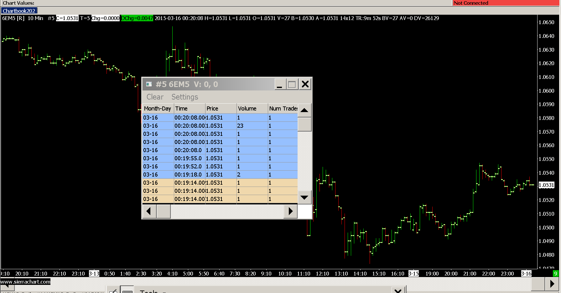

To prove the problem does not occur for us, refer to this image:
http://www.sierrachart.com/image.php?l=1426479624211.png
The data for the Time and Sales is coming from the remote instance and Use Non-Chart Data from Remote Instances is checked.
You can also consider using the Sierra Chart Exchange Data Feed instead of IQ Feed which will also solve this issue for you. It is also less expensive per month.

your chart image does not show a DOM thus it does not 'prove that the problem does not occur for you.' i also can see T&S prints for both feeds in my destination copy of sierra, but they do not show up on the DOMs. i would think this would help narrow down the problem.

The Time and Sales window for a Trading DOM works for us when using remote data:
http://www.sierrachart.com/image.php?l=1426484821648.png

ejtrader - Posts: 689
jivetrader - Based on the image you have posted earlier - data sharing btwn 2 copies of SC | Post: 51310 - Looks like you are using continuous contract from IQFeed. Have you tried using regular contract to see if it works?
