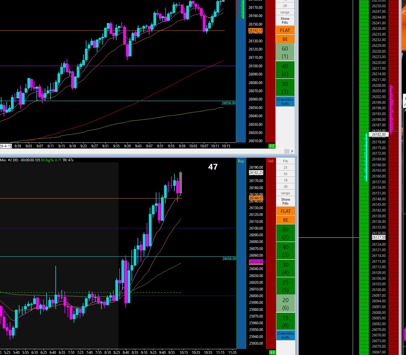

Hello, I recently updated to the latest release. I have my cursor set to go back to hand after use but after the update the crosshair is always on on the dom in the space where orders are. I use to be able to click in this area to turn on the crosshair and then click again to turn it off but now its just always on. Is there a fix for this?

I've attached an image where you can see the crosshair in the black area of the dom. I used to be able to click in this area to turn it on/off otherwise I just have the hand tool as default. Even when I manually select hand the crosshair is on on the dom and won't turn off. I'm not sure what you mean by workflow. I have a simple dom and some time charts is all.

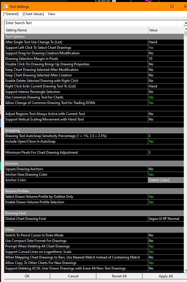

Its set to yes. I've attached a screenshot of my tool settings.

[2026-04-15 18:55:19]
When you have this issue - in the Trading DOM, what is the option under "Chart >> Tools" set to?
Also, when this occurs - if you left click in the Trading DOM does the crosshair actually show/hide as you expect? Or is it not doing anything?
Keep in mind, the Trading DOM has a limited set of tools available - you will see the list under "Chart >> Tools" for the Trading DOM itself. What should occur for the setup you have, is that if you select a tool that is not supported by the Trading DOM, then the Trading DOM will stay in the last mode it was set to. Once you select a tool that is common between both Charts and Trading DOMs, then the tool options will update in both locations.
