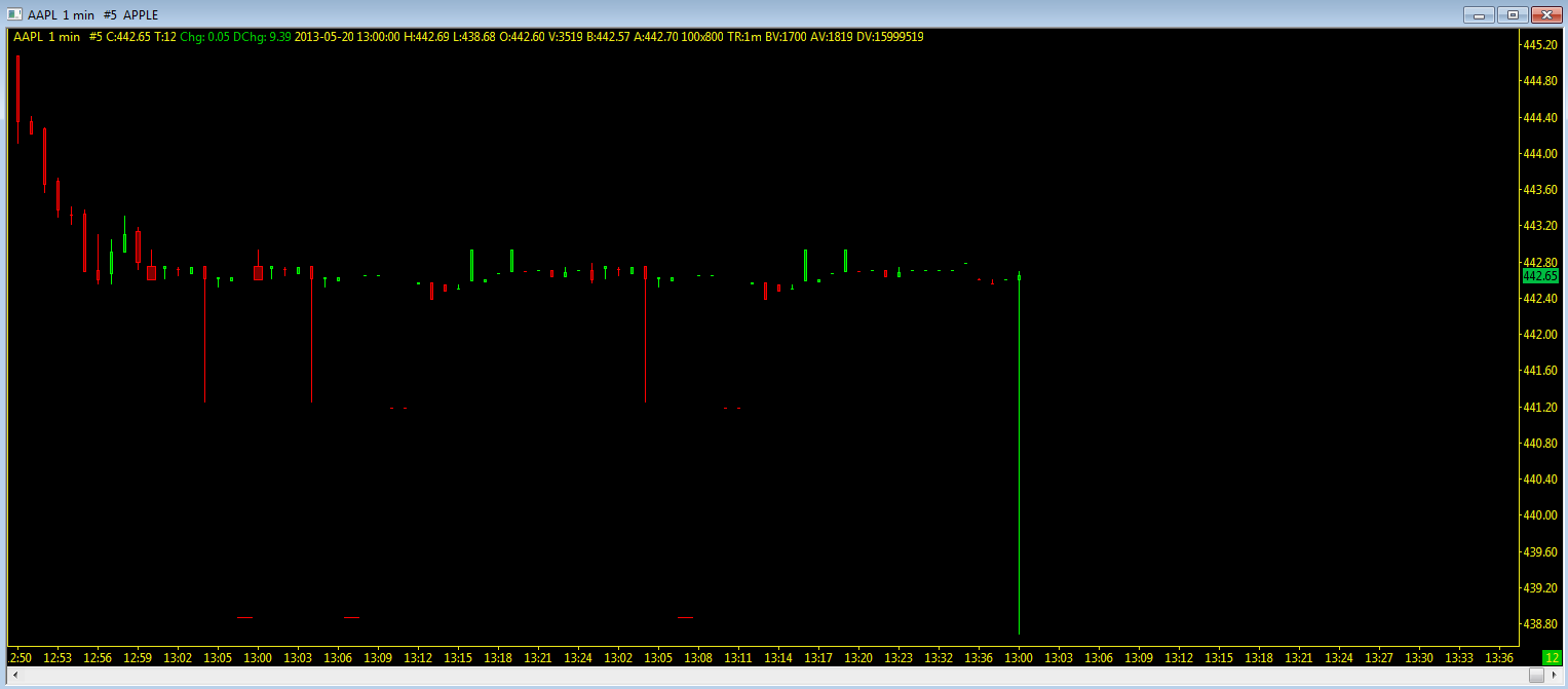

[2013-05-20 20:53:21]
ged - Posts: 233
As it turns out, the problem does manifest itself in new charts outside of the chartbook. Here is a screen shot of a simple, new 1 minute chart. Take a look at the Time Scale at the bottom of the chart. You will see that the scale repeats itself periodically by restarting at 13:00!

[2013-05-20 21:00:12]
This could be because you are sharing the same Data Files Folder between 2 copies of Sierra Chart. To see what the folder is set to select Global Settings >> General Settings. Each copy of Sierra Chart must use a different Data Files Folder.

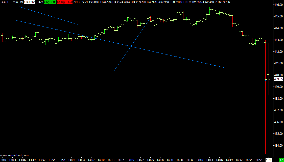

[2013-05-21 13:16:55]
LORENFOSTER - Posts: 1
I have some issues with a AAPL chart not going past 1500 . it stopped displaying data at that time and created a large bar
http://www.sierrachart.com/image.php?l=1369142145296.png

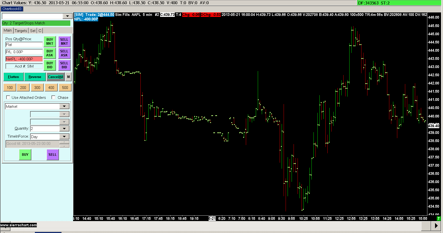

[2013-05-21 20:35:48]
We ran an Apple chart using delayed data but continuously streaming data, into the close and we did not notice any problems:
http://www.sierrachart.com/image.php?l=1369168425368.png
Despite that IQ feed does not see this issue with other programs, from what we are hearing and seeing from the images posted, this very obviously looks to us like there is something faulty with the IQ feed timestamps. That is quite clear. They should really look at the timestamp data they are sending and see why it is changing at the time you are noticing a problem. We never had a problem previously with IQ Feed timestamps and we have not touched our code that processes those.
Therefore, we ask IQ Feed to look at this closely at the timestamp data they are providing you at the time you are having a problem. Please provide them this message.
