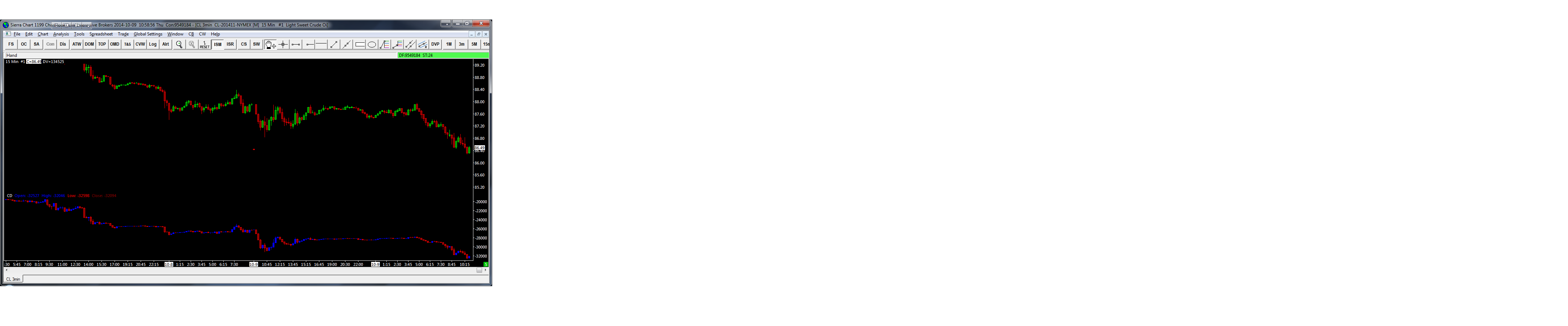

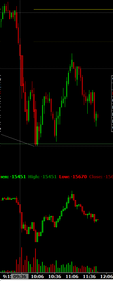

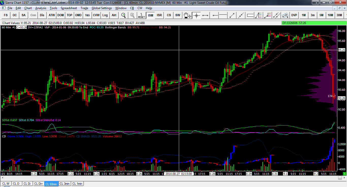

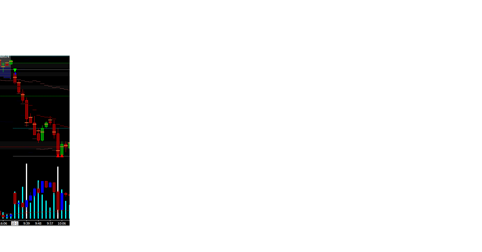

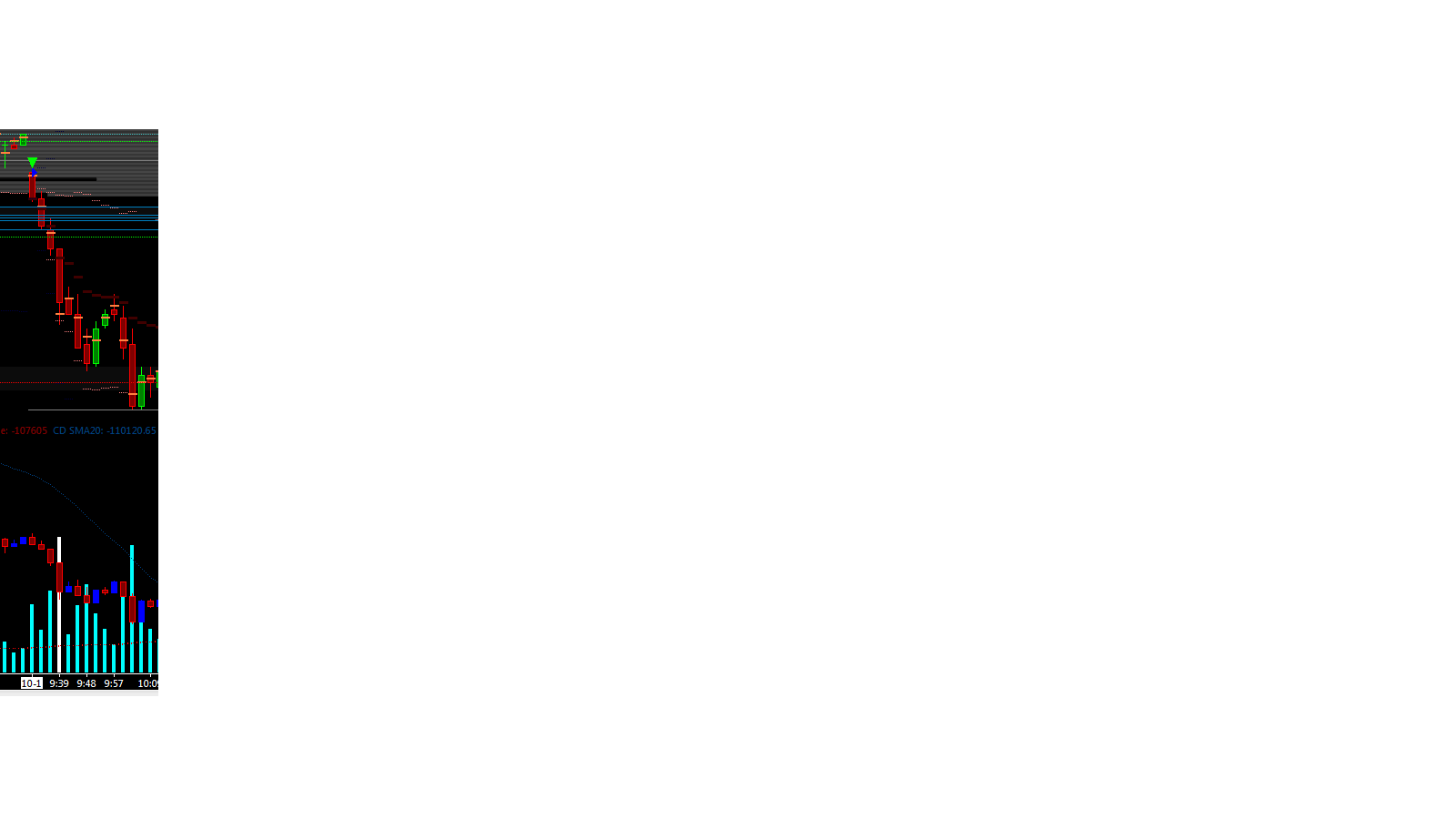

Today using the Sierra data feed the Sierra platform plotted the incorrect Cumulative Delta. The chart showed CD moving higher while price was ripping lower. That made no sense. So I checked with a Rithmic data feed, which showed both price and CD moving lower together. Then I went to Edit / Delete all data and download. And then Sierra plotted CD differently, this time moving together with price.
This is not the first time I experience this "divergence". Thanks god I don't trade Cumulative Delta divergences. I'm attaching a second example: CL Sep2.
I would appreciate your feedback on this.
Thank you,
K
imageES oct1 3min chart mkt open - Sierra data feed INCORRECT.png / V - Attached On 2014-10-01 23:56:03 UTC - Size: 18.03 KB - 669 views
imageES oct1 3min chart mkt open - Rythmic data feed.png / V - Attached On 2014-10-01 23:56:15 UTC - Size: 10.59 KB - 711 views
imageES oct1 3min chart mkt open - Sierra data feed UPDATED.png / V - Attached On 2014-10-01 23:56:25 UTC - Size: 15.17 KB - 628 views
imageCLV14 60minute chart INCORRECT.png / V - Attached On 2014-10-01 23:56:33 UTC - Size: 93.9 KB - 674 views
imageCLV14 60minute chart UPDATED.png / V - Attached On 2014-10-01 23:56:41 UTC - Size: 104.39 KB - 699 views

Did you care to read and/or note in the charts that the CL example is from one month ago? I do wonder because you checked the last three days. Your response reads like arrogant excuses. That's wonderful. Either your data feed or your platform have a serious problem. That is not wonderful. I would expect from a serious company an interest in solving problems, not disregarding them as non-applicable without even looking into them. That is not wonderful. This problem will happen again. I already provided you with the time-frame and the study of the two recorded cases.
[2014-10-02 17:19:12]
When we are bombarded with these kinds of images and they are not clear, then they are only confusing to us and not helpful.
If you are referring to data a month ago, then if there is a problem with that data, then re-download it.
We do not know the origin of that data and that is impossible for us to say from our perspective.
From what we can tell at this point, there is no problem to solve here. The data feed is working properly.

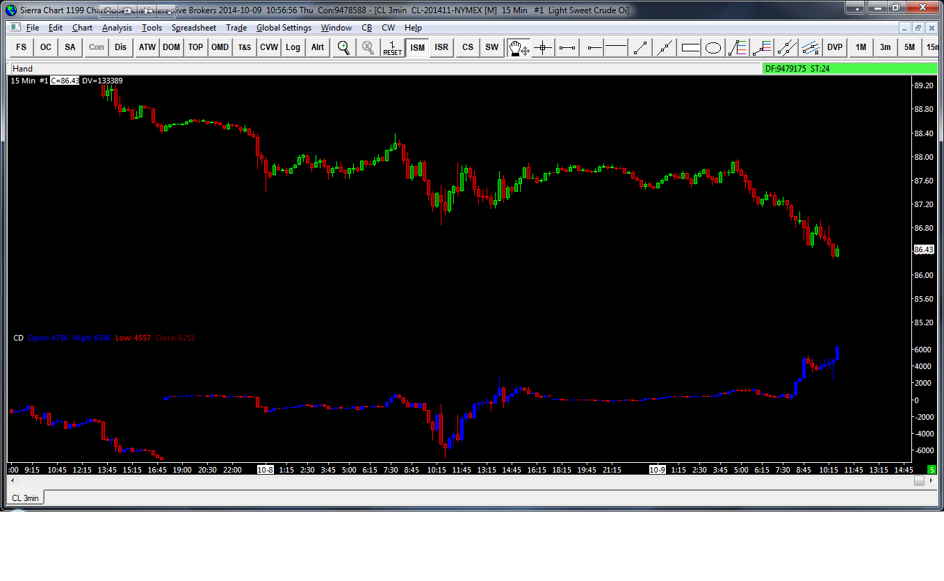

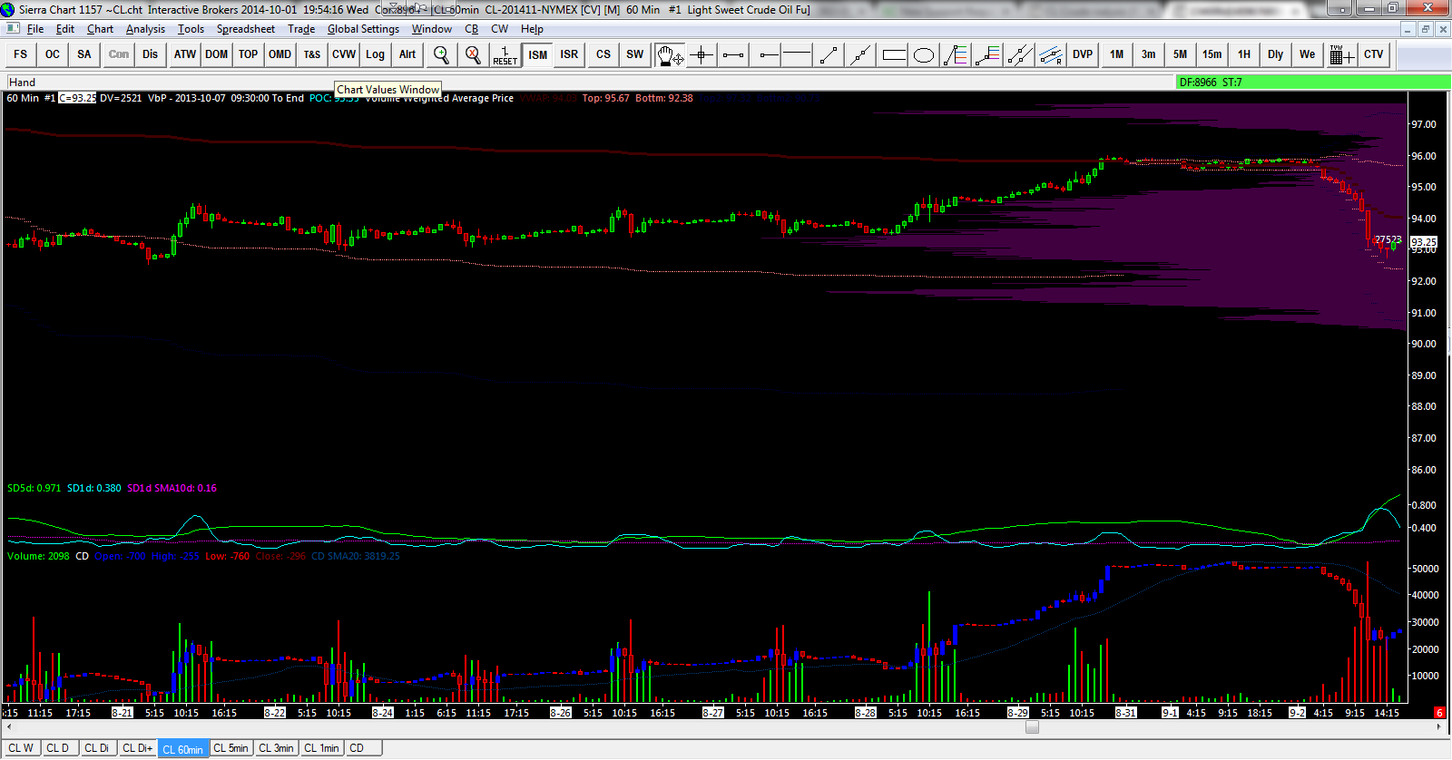

Today it happened again.
Instrument: CL
Data feed: yours (Sierra Exchange)
Time frame: all
Study: Cumulative Delta Volume Bars (rresetting start of day: yes)
Intraday Data storage unit: 1 tick
Attaching screenshot + chartbook of a 1min CL chart with only the CD study (1 pre reloading/recalculating chart, 1 post reloading/recalculating chart). Note both chartbooks will look the same. The screenshots do not.
Would you know what is going on? I can't reload charts every time I need to make a trading decision. Takes too long.
Thank you.
attachmentCL Post reloading.cht - Attached On 2014-10-09 15:06:37 UTC - Size: 28.98 KB - 811 views
attachmentCL Pre reloading.cht - Attached On 2014-10-09 15:06:49 UTC - Size: 28.98 KB - 616 views
imageCL Post reloading.png / V - Attached On 2014-10-09 15:06:59 UTC - Size: 95.96 KB - 690 views
imageCL Pre reloading.png / V - Attached On 2014-10-09 15:07:13 UTC - Size: 96.2 KB - 605 views
[2014-10-09 18:24:17]
Something is not right.
Notice in CL Post reloading.png , that 10-9 is repeating and it is not resetting every day. This is not making sense.
Do you have a data folder being shared by two copies of Sierra Chart?
[2014-10-09 19:17:30]
rhovega - Posts: 279
You are right, hadn't noticed that.
Yes I do have a data folder being shared by two copies of Sierra Chart.
[2014-10-09 20:28:34]
This has to be the source of the problem. Otherwise there is no explanation for this at all. There must be two copies of Sierra Chart writing to the same data file.
