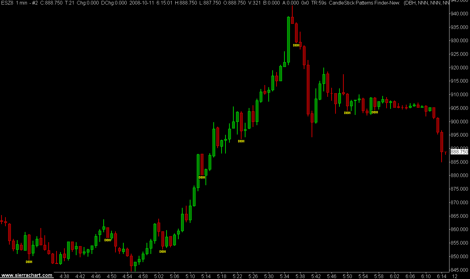

Copy TextThe Candlestick Patterns Finder study is a highly advanced study for identifying numerous candlestick patterns in a chart. The patterns are labeled with three letter codes.
You can search for up to six patterns per instance of the study. You can add multiple instances of this study if you need to detect lots of patterns. There are several inputs to customize the behavior of the study.
This study displays the numeric value of the pattern or the defined letter code of the pattern, when a positive pattern is found. To do this, it uses the values of Subgraph 1 for the characteristics of the numbers/letters that are drawn. Therefore, it is not possible to change the Subgraph Draw Styles for this study.

  5. On the Settings and Inputs tab use the 6 Pattern # inputs to select the candlestick patterns you want to look for. You need to set at least one. You do not need to set all 6 of them.
  6. Set other Inputs as appropriate. To increase the probability of seeing a candlestick pattern code for the selected patterns for a particular bar, set the Use Trend Detection Input to No.
  7. Select the Subgraphs tab. The foreground and background colors for the candlestick pattern detection text on the chart can be changed with the primary and secondary color buttons for the Pattern 1 Subgraph. The Size setting for the Pattern 1 Subgraph controls the font size of this text in points.
    If you wish to see how the internal trend detection is working, then set the Draw Style for the Trend Up subgraph to Arrow Up and the Trend Down subgraph to Arrow Down . This will allow you to see arrows indicating the detected trend for any bar in the chart. The indicated trend is the trend over the prior 4 bars, by default. It does not include the bar where the arrow is displayed. Normally you will not show the arrows unless you always want to see the trend detection.
