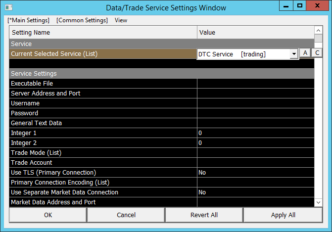

  4. Select Global Settings >> Data/Trade Service Settings on the Sierra Chart menu.
  5. Set the Service to DTC Service. This fully supports the DTC Protocol as a Client and can be used to establish a connection to a DTC Protocol compliant Server for testing.
  6. Set Connection Details >> Server Address to the IP and port number of the DTC Server. Format: Address:Port. Multiple addresses can be separated by a comma (,) and at every connection the next address in the list will be used.
    The Port number is required when connecting to a remote server. The port number is optional when connecting to a local server which is started as an executable program. If a port is specified, that will be a port which is used to connect to the Server whether it is local or remote. If the Port is not specified, then Sierra Chart will determine a Port when connecting to a local server executable program and pass it to the program on the commandline as a parameter. Example: /Port:1234.
  7. The Sierra Chart Test Client supports non-TLS and TLS connections. TLS connections use Open SSL. Set Connection Details >> Use TLS to True to use a TLS connection. TLS version 1.2 is used. This is supported in version 1295 and higher of Sierra Chart.
  8. The Sierra Chart Test Client does not support ZLib compression for historical price data on the primary DTC Protocol connection used for market data or trading. It is necessary to use a separate historical data connection for compression. In this case set Use Separate Historical Data Connection to True to use a separate connection.
  9. Set the Primary Connection Encoding to the encoding that you want to use for the primary connection.
    If the DTC Server is going to only support one encoding and both the client and server can agree ahead of time on that encoding, then enable Skip Encoding Request for Primary Connection (version 1769 and higher). In this case, the server does not need to support the DTC Encoding Request message.
    Otherwise, it is necessary that the Server has implemented support for the Encoding Request message.
  10. If the server does not require a logon message, then enable Skip Logon Request for Primary Connection. This is supported in version 1769 and higher.
  11. Set the other Service Settings as required.
  12. Connection Details >> Executable File: If you want Sierra Chart to run a server executable file upon connection, then specify the path and filename to the server executable in the Connection Details >> Executable File box. The Server program will need to listen for a network connection on the specified Port.
    The format is: [absolute or relative path to executable server program]/[filename.exe].
  13. Press OK.
