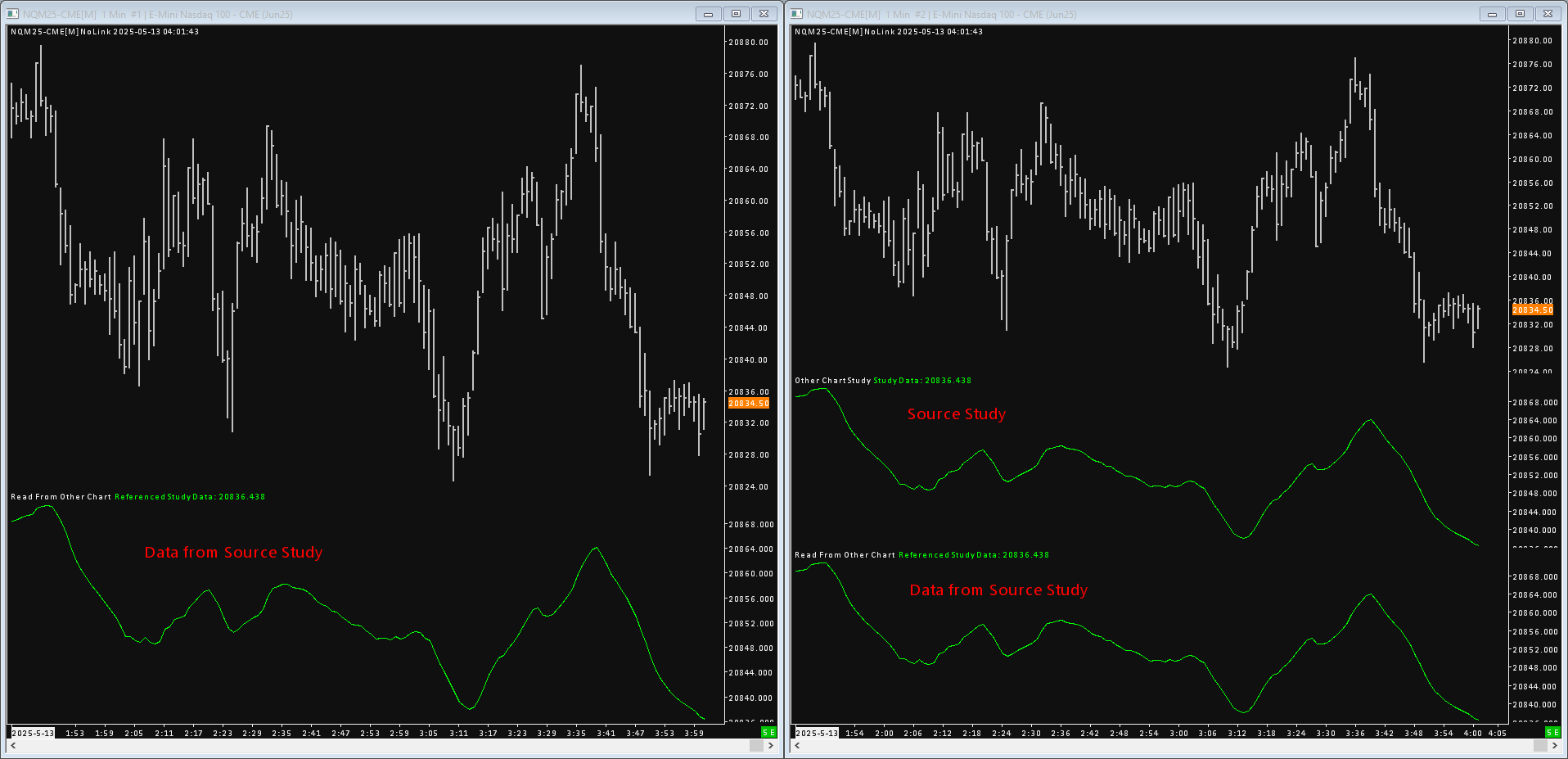

Super basic working example attached.
imagedatafromchart.png / V - Attached On 2025-05-13 09:36:48 UTC - Size: 84.68 KB - 269 views
attachmentReadFromOtherChart.cpp - Attached On 2025-05-13 09:37:07 UTC - Size: 2.16 KB - 346 views
