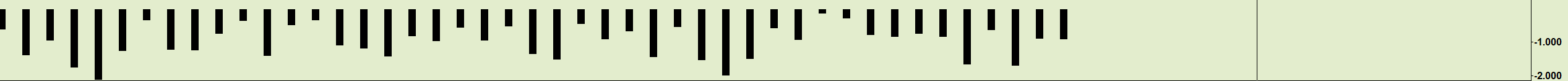

thank you sir, but I found the Study Subgraphs Divide/Ratio display strange, it's always negative, although readable but unconfortable
image屏幕截图 2025-04-30 235231.png / V - Attached On 2025-04-30 15:52:47 UTC - Size: 3.14 KB - 347 views

That would only occur if one of the data points is negative, which would not be the case if you are using the Bid Volume and Ask Volume.
What are your entries for "Input Study 1" and "Input Study 2" in the "Study Subgraphs Divide/Ratio"?

ok I have make it right
