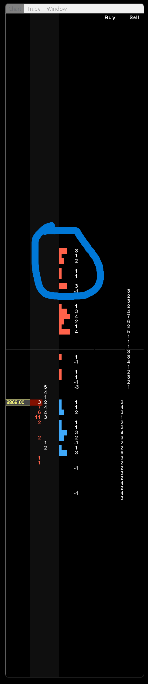

hello, yesterday after changing my DOM tick size back down to 0.25 from 1 my pull/stack volume bars broke.
when negative the volume bar does not go away i tried deleting the DOM i have and remaking it but still have the same issue
attached image for reference
ps. the pull (numbers)on my dom are colored same color as background to be invisible. none numbered cells with volume bars are pulls
how to fix

Sébastien - Posts: 156
Same problem here.
Now negative pull/stack numbers cast a bar. It didn't do that before.
Negative number casting a bar could be a good thing if we are able to use another color for the negative bars, to differentiate them from the positive bars.
But for now it's not possible. Positive and negative bars have the same color... so it's kind of a mess.

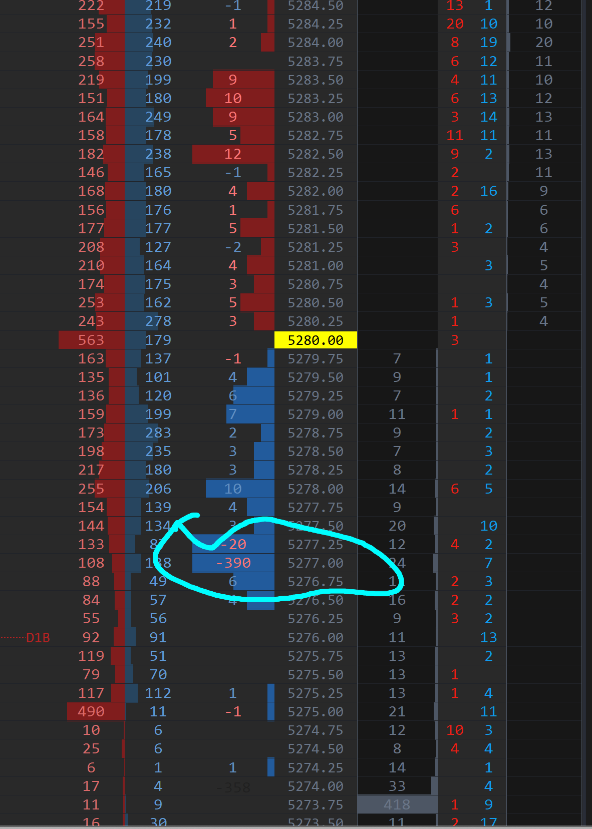

User398084 - Posts: 4
I just came across a similar issue — really hope this gets addressed soon. The pull/stack volume bar shouldn’t reflect negative values, unless there’s an option to display them using distinct colors.

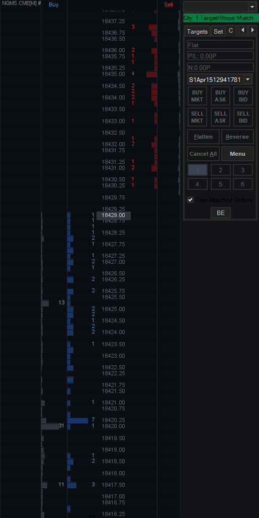

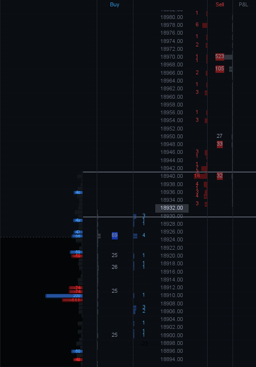

Good morning,
I updated to 2756 and run some tests with the Pull/Stack.
It works better than before. The bug described in the post #14 is gone.
There is still a glitch when we use Maximum Market Depth Pulling Stacking Levels (0 = all levels) on a market that has Market Depth Combine Increment in Ticks > 1 AND Apply Combine Increment in Ticks to Other Market Data Columns activated.
If we set Market Depth Combine Increment in Ticks = 4, then the Ask side shows 4 times more levels than the Bid side.
See picture 1.
Another small glitch when we use Maximum Market Depth Pulling Stacking Levels (0 = all levels) alone (without combining ticks) : there is often a few more levels visible at the Ask side than at the Bid side. It varies with time. It's not always the case. It happens often on the NQ and YM, not so much on ES and RTY.
See picture 2.
