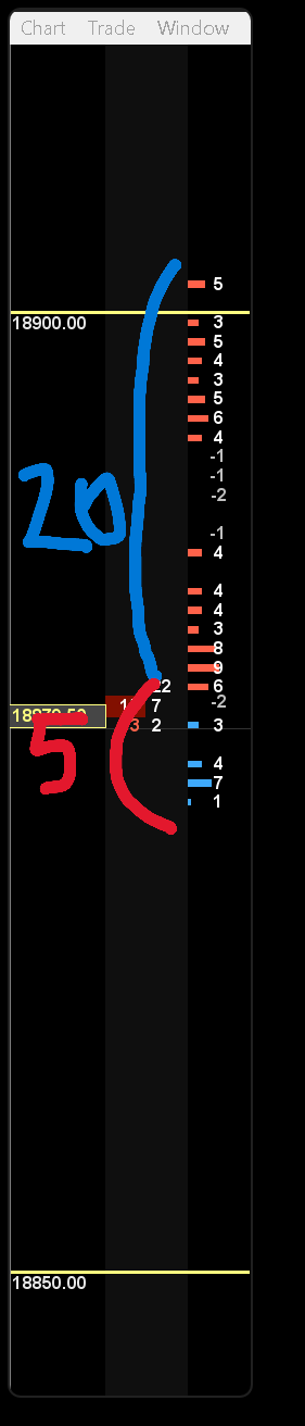

I updated to 2756 and run some tests with the Pull/Stack.
It works better than before. The bug described in the post #14 is gone.
There is still a glitch when we use Maximum Market Depth Pulling Stacking Levels (0 = all levels) on a market that has Market Depth Combine Increment in Ticks > 1 AND Apply Combine Increment in Ticks to Other Market Data Columns activated.
If we set Market Depth Combine Increment in Ticks = 4, then the Ask side shows 4 times more levels than the Bid side.
See picture 1.
