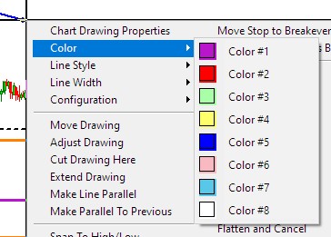

When right clicking on the Ray Line on a chart.
How do we add more colors to the color option drop down menu?
Picture of the the current default options attached.
imageNeed more colors.jpg / V - Attached On 2025-03-28 10:00:11 UTC - Size: 30.77 KB - 297 views
[2025-03-28 13:55:35]
You can not add more colors to that option - it is limited to those 8 items.
If you want to change those colors, then refer to the following:

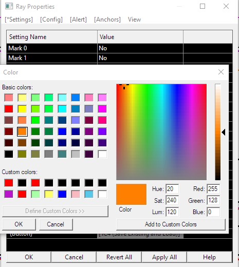

[2025-03-28 23:44:51]
Ticks - Posts: 212
Define Custom Colors button is grayed out.
imageNeed more colors2.jpg / V - Attached On 2025-03-28 23:43:41 UTC - Size: 63.53 KB - 316 views
[2025-03-31 15:07:57]
Per the documentation:
Press the Define Custom Colors button if the Color customization portion of the window is not already displayed.
The color customization is already displayed on the right, which is why you are not able to select that option.
