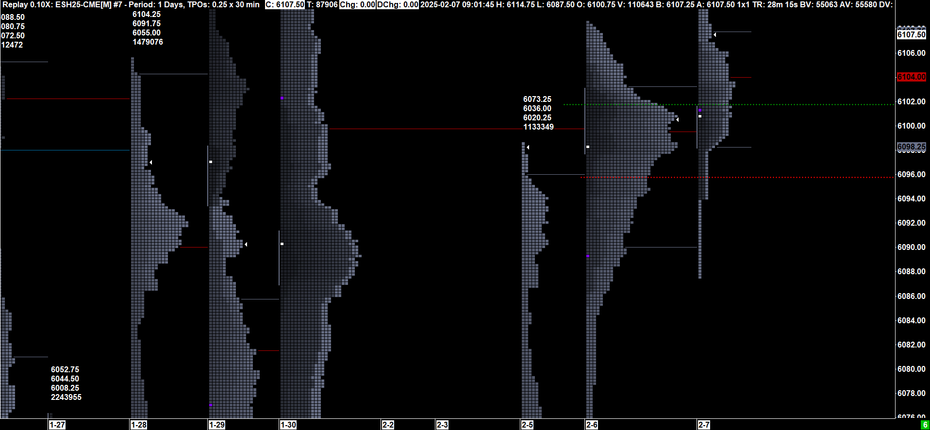

William Cline - Posts: 22
in the photo i marked with green and red lines the open at 9:00 and the close at 2:15pm the white arrow and bar that are supposed to mark out the open and close are misaligned and i wanted to know what setting i could change to make them line up with the correct times

[2025-03-21 21:09:46]
Your Session Times must not be set to have the Regular Session Hours from 09:00 to 14:15. Otherwise, the TPO open and close would match properly to the actual Open at 09:00 and the Close at 14:15. Refer to the following:
Is it possible to have daily the tpo represent the volume from 00:00:00 to 23:59:59 while having the session time set to 9:00 to 14:15. Because when I switch to those session times in chart settings the actual daily tpo candle itself changes.
I’m trying to set it up so the volume of the candle represents the full 24 hours but the open and close of the session are marked out with the arrows at 9:00 open to 14:15 close

[2025-03-21 21:47:27]
There is not a way to have the Session Times set as 09:00 to 14:15 and then have a TPO study that covers 00:00:00 to 23:59:59.
You would need to have the chart setup to have the session be from 00:00:00 to 23:59:59 to get the TPO correct. You can then use another chart to have session times from 09:00 to 14:15 and overlay the Open and Close prices from those times to the TPO Chart. The easiest way to do this would be to use the "Daily OHLC" study on the 09:00 to 14:15 chart and then use the "Study/Price Overlay" to overlay the "Daily OHLC" to the TPO chart (you can hide the High and Low if you do not want to see them).
Maybe I’m not explaining myself correctly, using the photo I posted at the beginning of the thread, the little white bar and white arrow that are used to signify the open and close of a session. I want to change that without altering the volume distribution of my daily tpo candle
[2025-03-24 14:44:22]
Those items are going to be the Open and Close for the 24 hour period that the TPO is made up of. There is no way to change those to a different time period.
