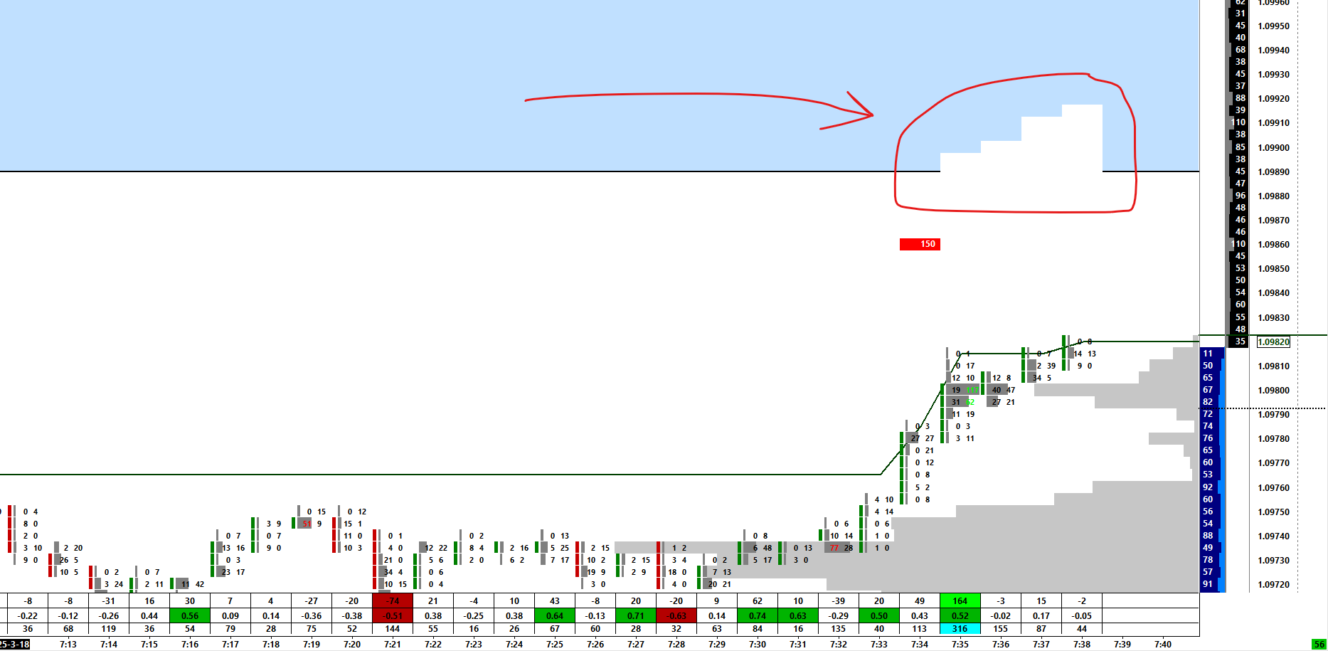

Hi guys,
The Blue box is a Rectangle zone marked out on an other chart and linked into this one.
I have the Market Depth Historical Graph on there as well, with the majority of Range Colours set to white so I only see the biggest size.
But as you can see those white selections start to cover the zone as they move toward it.
Any way of making them transparent, or making the zone sit above the study (bearing in mind its from the another chart)?
Thanks,
Stephen
imageScreenshot 2025-03-18 073935.png / V - Attached On 2025-03-18 07:52:32 UTC - Size: 78.2 KB - 266 views
[2025-03-18 15:26:56]
John - SC Support - Posts: 48139
Refer to the following:
Chart Studies: Study Display Order
[2025-03-18 16:21:54]
StephenL - Posts: 122
I don't think Rectangles from another chart are covered in that though? Unless I can't see it.
[2025-03-18 17:26:17]
Sorry, with regards to drawings, refer to the following and the item below it:
Chart Settings: Draw Highlight Drawings Underneath Main Graph and Studies (Chart >> Chart Settings >> Chart Drawings menu)
[2025-03-19 08:23:26]
That did it, thanks John!
