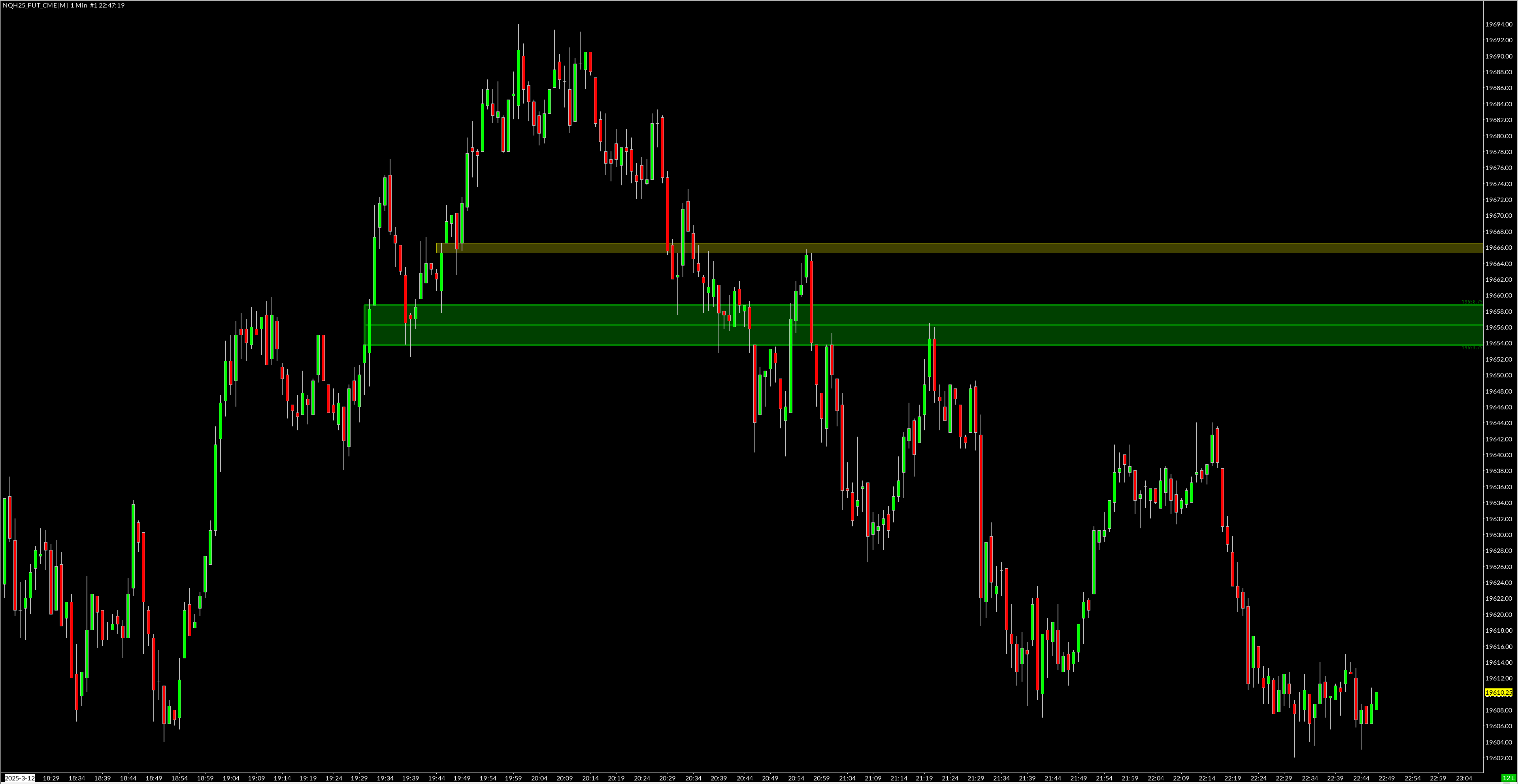

I would like to create alerts that show colored zones when they hit and extend the zone.
One would be for fair value gaps and 1m bar gaps from previous close to open. I've showed an example of a drawn extended rectangle when they hit here. Is there a way when color bar alert hits to color it from high to low value and then extend it till intersection?

You might be able to do this using the Spreadsheet Study, but there is not way to only extend to future intersection in this case.
We cannot give complete details on how to do this, as we have not done it. You would need to work it out.
But refer to the following for how to have a filled area between two subgraphs:
Chart Studies: Filling the Area Between Two Study Subgraphs within Same Study
