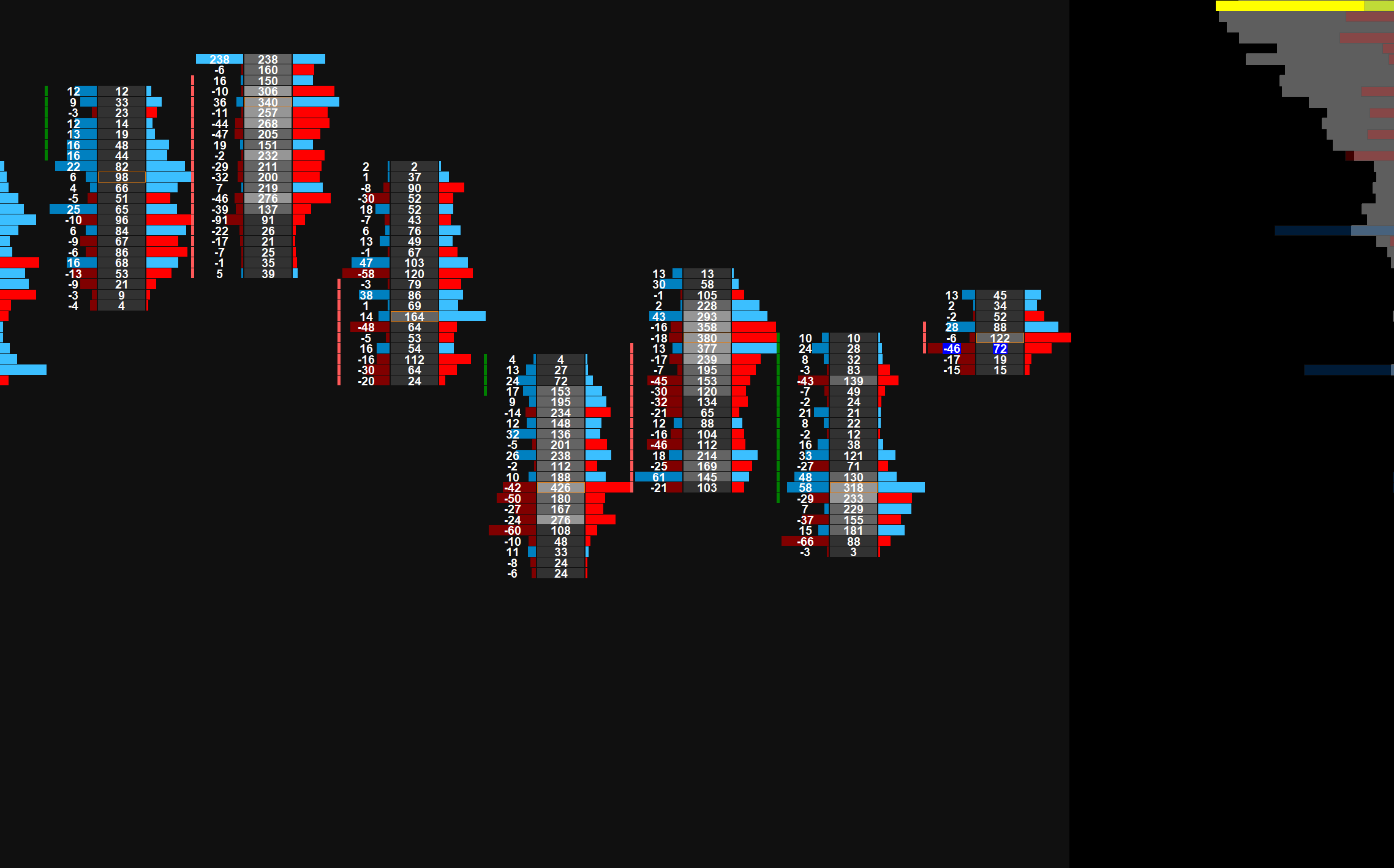

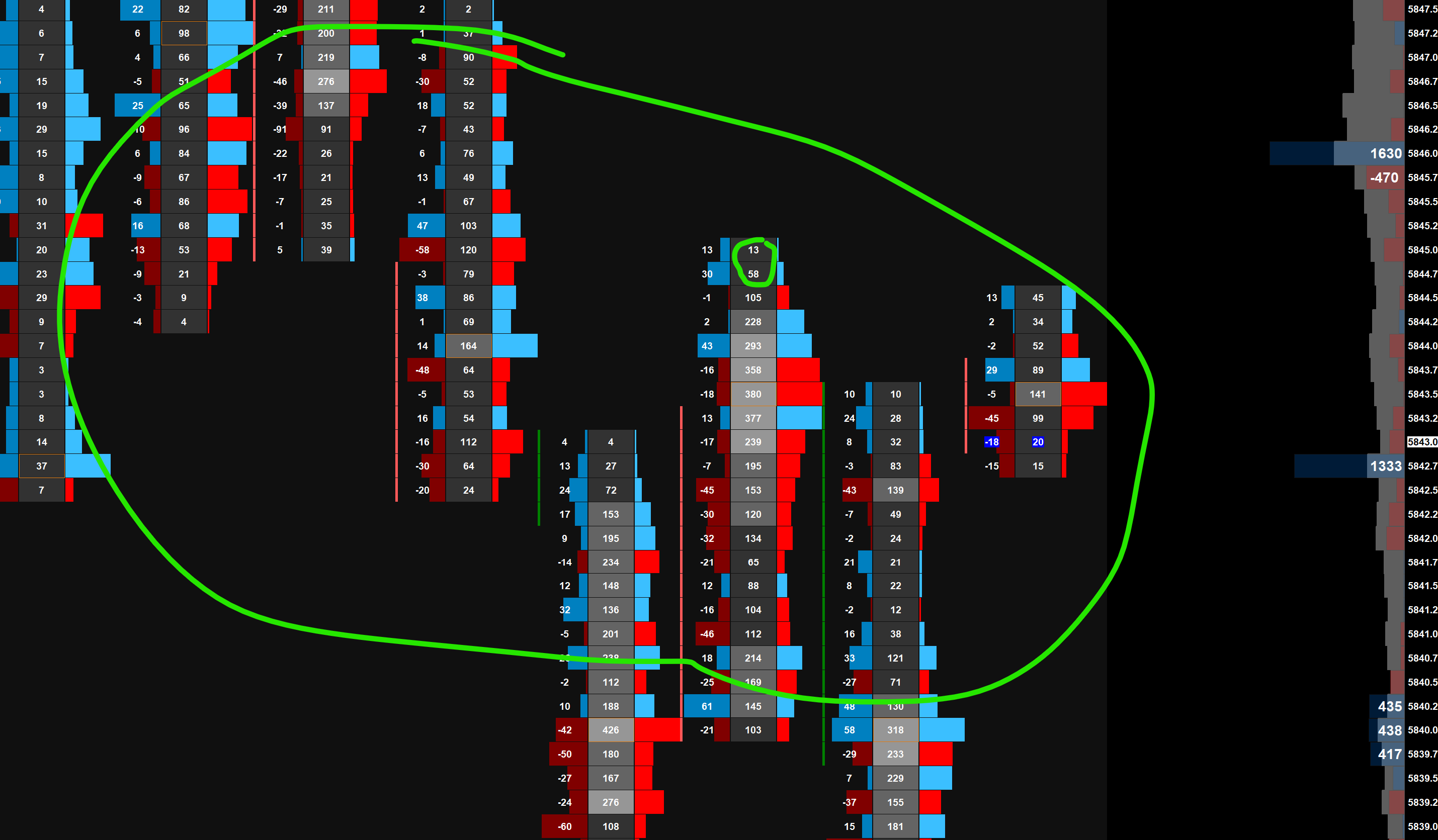

Hi, i dont know what setting within my footprint chart to increase the size of the numbers within there FP columns as i zoon in and out... i've been trying for months to figure it out and i dont know how to do it.
I know it can be done because im using the same FP chart as someone else that is able to zoom their numbers in/out as you zoom in/out the charts.. see screenshots attached.
my chart are screenshots 1 an 2... the 3rd screenshot shows is what im trying to accomplish but i dont know how to get my charts to look like this 3rd screenshot

Refer to the following:
Numbers Bars: Font Size Mode

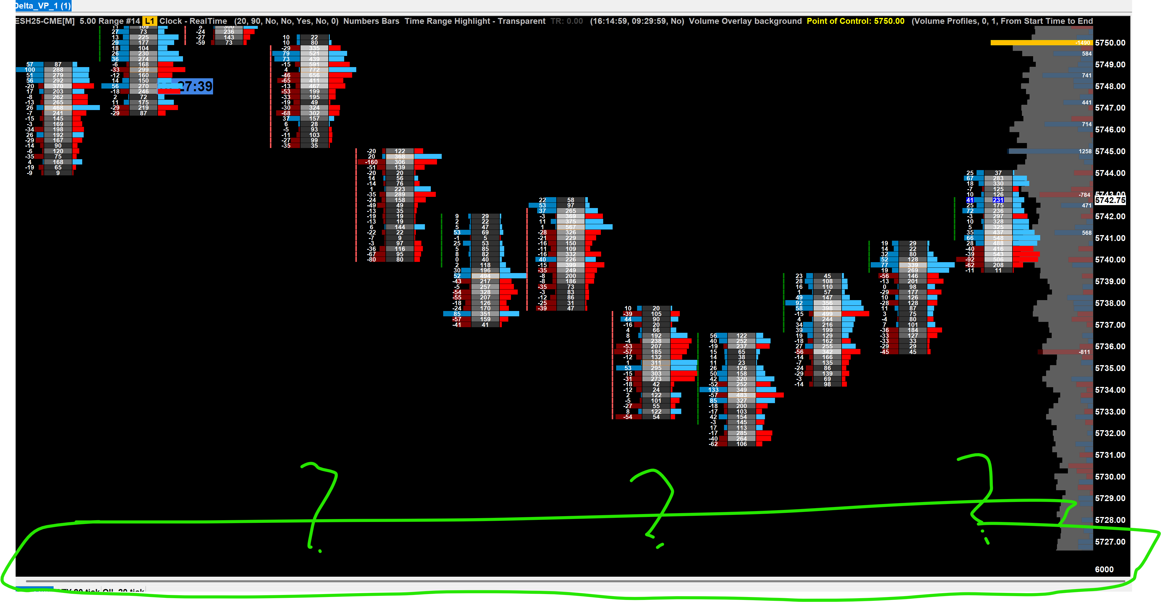

Now i notice my bottom scale for the time (left and aright) disappeared... (see screenshot)
How do i get back my left/right time at the bottom of my screen and remove this scroll bar that i dont need?
imageBottom scale axis disappeared pleas help restore.png / V - Attached On 2025-03-06 20:29:18 UTC - Size: 388.94 KB - 212 views
[2025-03-06 21:54:21]
John - SC Support - Posts: 48139
Offhand, it looks like your chart is not maximized. Rather, it has been sized to fit into the main window. Therefore, it looks like your time scale is simply displayed below the bottom of the main window. To verify this, make sure that chart is selected and then select "Window >> Maximize". If the time scale shows up properly, then what we stated is correct and you would need to adjust your windows based on this.
Otherwise, check the following setting:
Chart Settings: Hide Time Scale (Chart >> Chart Settings >> Scale menu))
If you do not want the horizontal scroll bar for a chart, then select that chart and then select "Chart >> Show Scrollbar" to remove the checkmark next to that item and remove the scrollbar. Refer to the following:
Chart Menu: Show Scrollbar (Chart menu)
