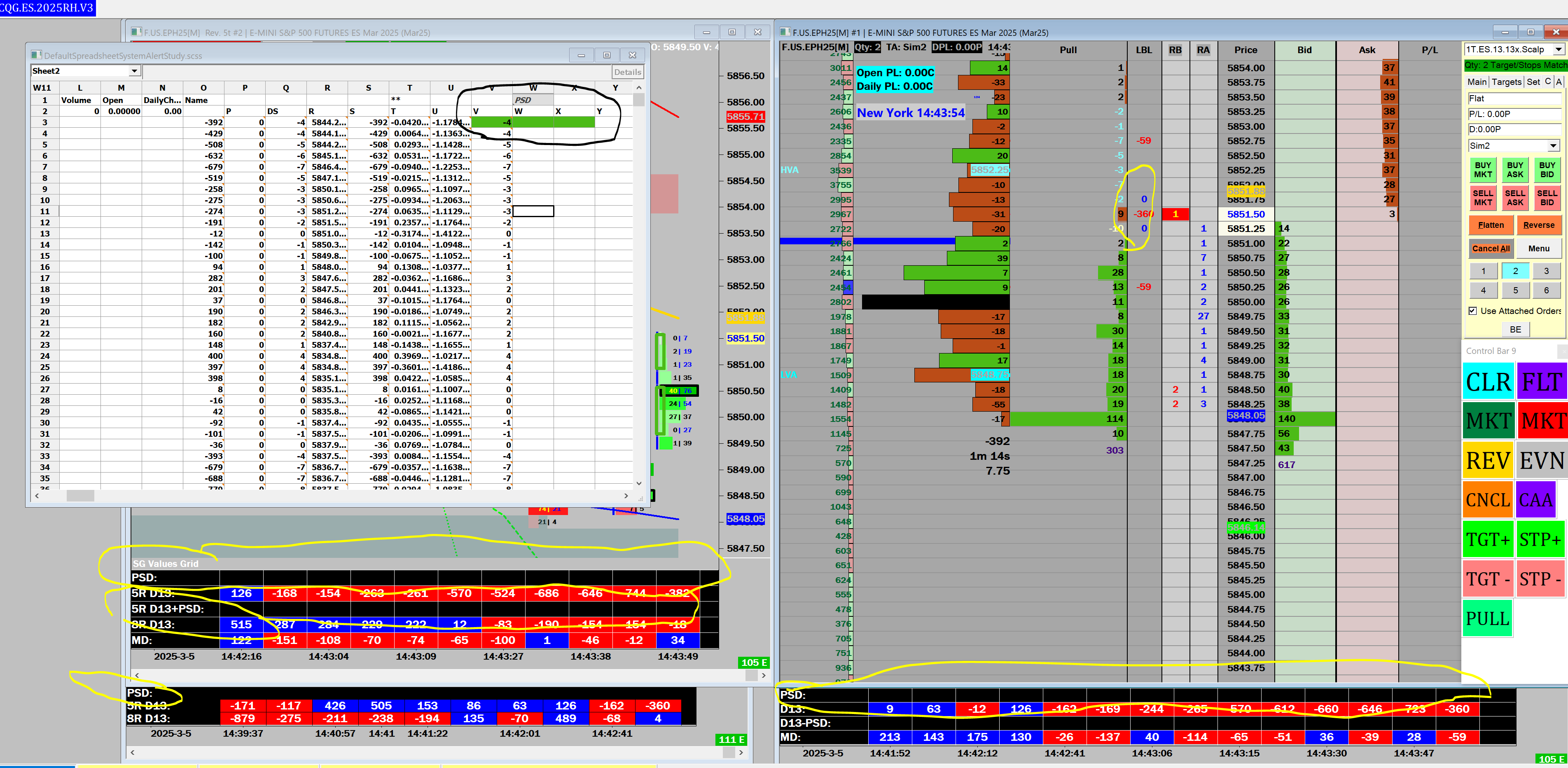

Today I added NQTV data, I used existing chartbook renamed it, changed symbols. I left all studies on original charts unchanged. When I reopened existing chartbook ( and 3 other older versions with nearly same settings, just window rearrangement) a few columns are now spitting blanks in my spreadsheet studies, which imported delta and pullstack difference values from charts to DOM and values grid beneath price. I have checked and all studies all still sending data to spreadsheet study, and of course no formulas were changed ( the data is also missing in the spreadsheet study of chartbooks that havent been opened in weeks)
any ideas on how to recoup?
I have exited and rebooted multiple times, and no changes

For that Spreadsheet Study, what is the Input for "Number of Formula Columns" set to?
[2025-03-06 02:32:31]
User993067 - Posts: 200
16 but did not touch that setting....data before and after the columns with missing data
[2025-03-06 03:56:32]
resolved....somehow column shifted left and formulas were building in an uncalled column....
assuming the spreadsheet does not operate like excel, in that if a column is deleted( or not sent to the spreadsheet study) everything must be realigned/recalculated?
This is why it is recommended to use this reference method instead of AlphaNumeric cell references:
Working with Spreadsheets: References to Study Subgraph Columns when using the Spreadsheet Study
If you use this reference method, you can do these actions and still maintain correct references:
- Insert/Delete Formula Columns.
- Increase/Decrease the Number of Formula Columns setting.
- Add/Remove/Rearrange studies in the Studies to Graph list.
