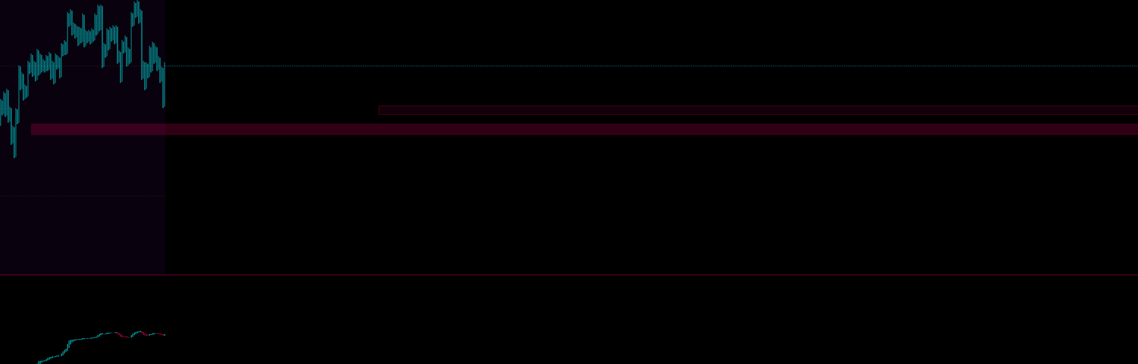

Hey Team.
I´m having trouble with my tool configuration. In the Screenshot you can see, that i have to rectangles. Both of them anchored at the same point but the lower one just randomly picks a different anchor point.
Hope i can bring the problem across.
Best
Tony
image1.png / V - Attached On 2025-02-26 14:25:34 UTC - Size: 33.59 KB - 243 views
[2025-02-26 16:43:39]
John - SC Support - Posts: 48308
How did you define the rectangles (how were they drawn)? Did you change the anchor values?
[2025-02-26 17:41:26]
Wernitschanton - Posts: 38
Hey John. I did not change anything. It´ll just automatically anchor the tool at a totally different point,
[2025-02-26 17:51:02]
How are you drawing the rectangles? Why are you expecting them to have the same anchor points?
[2025-02-26 17:55:17]
I expect them to anchor at the place where my cursor is. One og them does, the other doesnt
[2025-02-26 18:27:01]
Are you using different tool configurations for each of these rectangles when you draw them?
[2025-02-26 18:31:25]
Yes i do.
[2025-02-26 18:41:12]
You must have the option for "Use Start Time" set to "Yes" along with a specific "Start Time" set in the configuration for the rectangle that is jumping. Refer to the following:
Chart Drawing Tools: Rectangle | Extending Rectangle | Ellipse | Triangle Configuration
[2025-02-26 20:10:08]
So in order for the rectangle to start where i have my cursor, that option needs to be set to "No", correct?
[2025-02-26 20:12:33]
And one more question. I can´t set the outline of the rectangle to 0. How would i make the outline disappear?
[2025-02-26 20:23:35]
Correct. Or else the rectangle will be placed at the time that is entered.
There is no support for setting the outline to a zero width, or for removing it in general. The closest you can get to this would be to set the outline color to be the same as the background of your chart.
And you can hide the entire rectangle drawing.
[2025-02-26 20:28:24]
Alrighty, that´s all sorted. Thanks for your support John.
Tony
