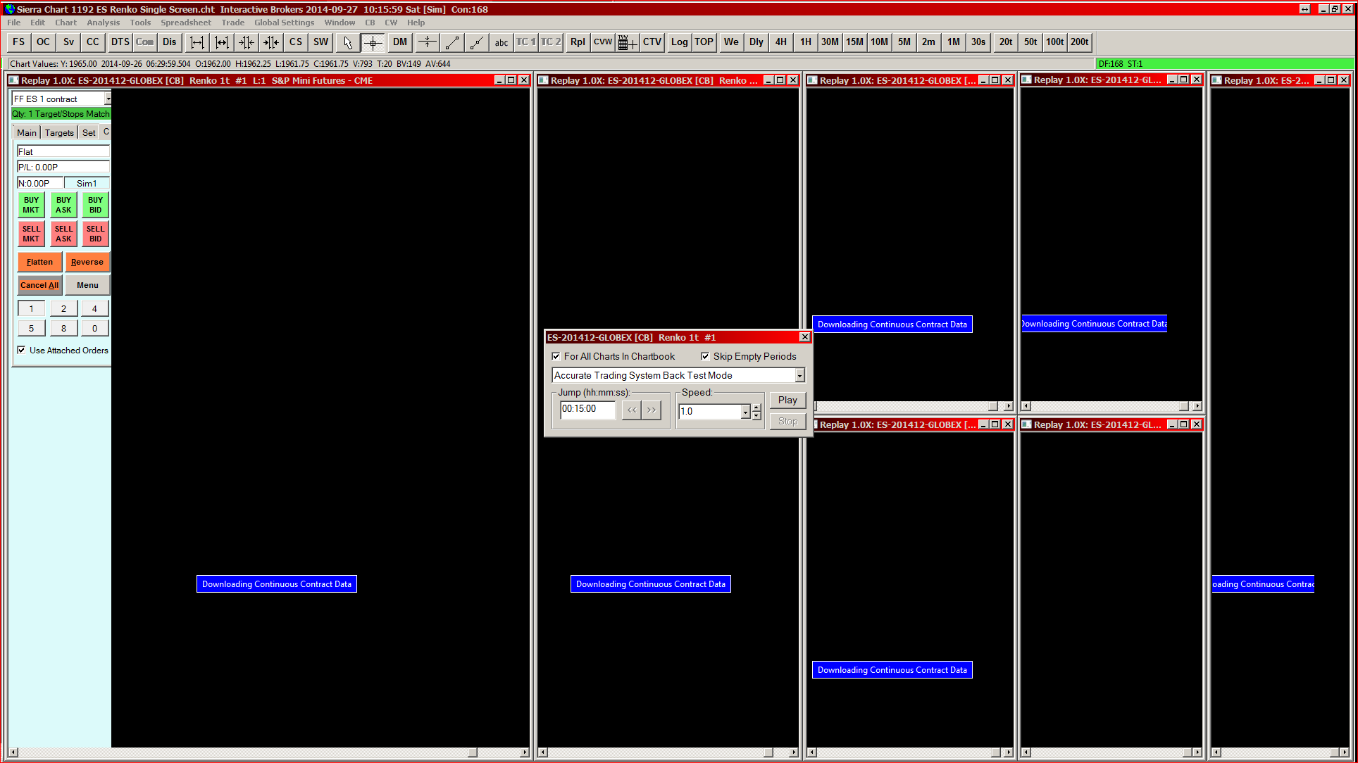

[2014-09-27 17:19:05]
FFTrader - Posts: 180
Here is what it looks like on my screen.
Data supplier is Interactive Brokers.
imageCapture SC.PNG / V - Attached On 2014-09-27 17:18:31 UTC - Size: 124.25 KB - 570 views
[2014-09-27 18:37:03]
There appears to be an IB issue with the downloading of historical data. Therefore, disable the Continuous Futures Contract option on the charts you are replaying.
Date Time Of Last Edit: 2014-09-27 18:37:14

[2014-09-27 20:53:00]
This is now fixed:
We do see an attempt to download historical daily data for the current futures contract under some conditions, on every reload of the chart and we will see why that is happening.
However, it does not make sense why it would manifest in an ongoing message that you saw on the charts indicating the continuous futures contract data is being downloaded.
There will be a new release out tomorrow.

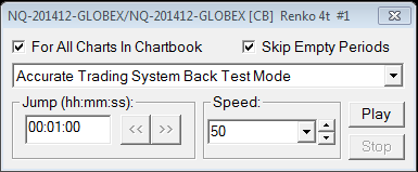

[2014-09-29 14:35:00]
ertrader - Posts: 698
There appears to still be an issue with replay. When I replay, the following picture appears until I exit Sierrachart
1) I am currently using Version 1196
2) This started a couple versions ago.. not sure which one but thought it would be fixed so did not bring it up
3) Happens whether I am connected to IB or not
4) Must restart SC to get back to normal
5) This happens with NO studies attached to the chart being replayed
6) I select replay all charts
7) My settings are below
8) There are no errors in the log file
9) Reproducible every time so replay is not functional at all
http://www.sierrachart.com/image.php?l=141200119654.png
Date Time Of Last Edit: 2014-09-29 14:45:29
imagereplay.png / V - Attached On 2014-09-29 14:36:52 UTC - Size: 31.1 KB - 579 views
[2014-09-29 14:46:47]
This means data is being downloaded . So the question is why is the download not completing.
Restart Sierra Chart, open only one single chart and no other charts. Start a replay of that chart and if you see that message on the chart window for more than a minute, then post a copy of the Message Log:
https://www.sierrachart.com/index.php?page=PostingInformation.php#log
Date Time Of Last Edit: 2014-09-29 14:47:57

NQ-201412-GLOBEX | 2014-09-29 10:58:23
Date rule based rollover from NQ-201409-GLOBEX to next contract occurs at 2014-09-11. | 2014-09-29 10:58:23
Date rule based rollover from NQ-201412-GLOBEX to next contract occurs at 2014-12-11. | 2014-09-29 10:58:23
Checking Intraday data file for symbol NQ-201409-GLOBEX for the date range from 2014-06-12 to 2014-09-11. | 2014-09-29 10:58:23
Checking Daily data file for symbol NQU14 for the date range from 2014-06-12 to 2014-09-11. | 2014-09-29 10:58:23
Checking Intraday data file for symbol NQ-201412-GLOBEX for the date range from 2014-09-11 to 0. | 2014-09-29 10:58:23
Checking Daily data file for symbol NQZ14 for the date range from 2014-09-11 to 2014-09-29. | 2014-09-29 10:58:23
Symbols used for NQ-201412-GLOBEX continuous contract chart: | 2014-09-29 10:58:23
NQ-201409-GLOBEX | 2014-09-29 10:58:23
HD Request # 3 | Downloading Historical Daily chart data for NQZ14. Starting date: 2014-09-26. Service: ib | 2014-09-29 10:58:23
HD Request # 3 | Requesting historical Daily data for NQZ14 starting at 2014-09-25 | 2014-09-29 10:58:23
HD Request # 3 | Receiving historical Daily data for NQZ14 starting at 2014-09-25 | 2014-09-29 10:58:23
Writing historical Daily data for NQZ14 to the file NQZ14.dly | 2014-09-29 10:58:23
HD Request # 3 | Received 3 records from 2014-09-25 00:00:00 to 2014-09-29 00:00:00 (5.0 days) and wrote 2 records for NQZ14 | 2014-09-29 10:58:23
HD Request # 3 | Daily download COMPLETE for NQZ14. Completion time: 0s | 2014-09-29 10:58:23
attachmentTest.cht - Attached On 2014-09-29 15:00:01 UTC - Size: 39.35 KB - 527 views

[2014-09-29 15:03:59]
Replay settings
imagereplay_Settings.png / V - Attached On 2014-09-29 15:03:50 UTC - Size: 7.71 KB - 573 views
