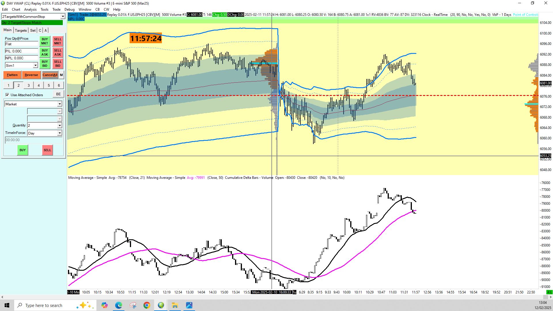

I have cumulative delta on a separate window and use moving averages. I would like to have an alert that is triggered when the cumulative delta value crosses either from above or below the moving average.
Please could you provide the line of code that would enable this?
I have attached an image of the setup.
Many THanks
Daniel
imageSierra Chart Support.JPG / V - Attached On 2025-02-12 13:08:38 UTC - Size: 251.51 KB - 203 views
[2025-02-12 17:32:39]
The general alert condition would be the following:
=CROSSOVER(ID1.SG4, ID2.SG1)
Where ID1 is the ID of the Cumulative Delta Study and SG4 is the Close subgraph of this study. ID2 is the ID of the Moving Average Study and SG1 is the Moving Average subgraph of this study.
Refer to the following for information on the CROSSOVER() function:
https://www.sierrachart.com/index.php?page=doc/SpreadsheetFunctions.html#CROSSOVER_Function
Date Time Of Last Edit: 2025-02-12 17:32:49
