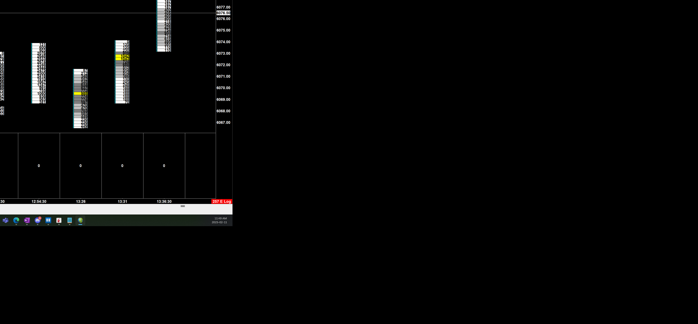

Hi, I am having trouble with the platform. Can I get help with this please? I am just looking to use a simple numbers bar/footprint through IBKR, however the numbers are glitchy and incorrect. I had it working fine for a week or so and then it just stopped. Can someone help please. Thanks

https://www.sierrachart.com/image.php?Image=1739292590138.png

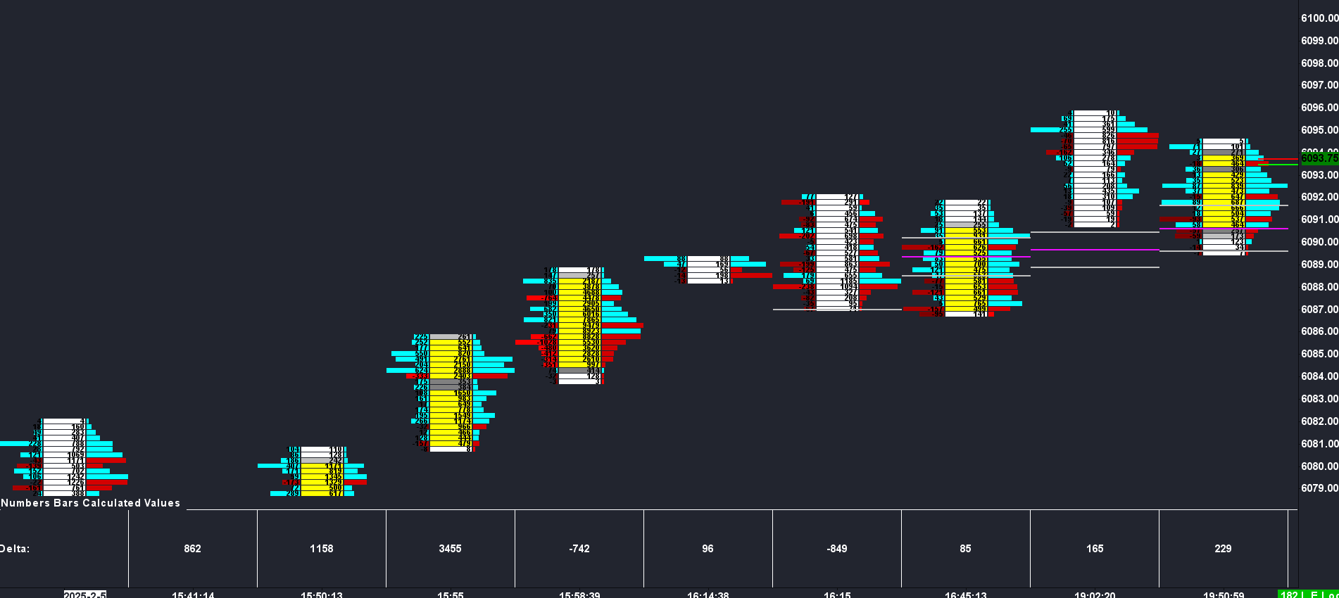

I have attached also a screenshot of when everything was working well. IBKR is set up as per your instructions and worked perfect for a couple of weeks. Hope to hear from you soon, John
imageSierra working well.png / V - Attached On 2025-02-11 16:52:36 UTC - Size: 97.75 KB - 246 views

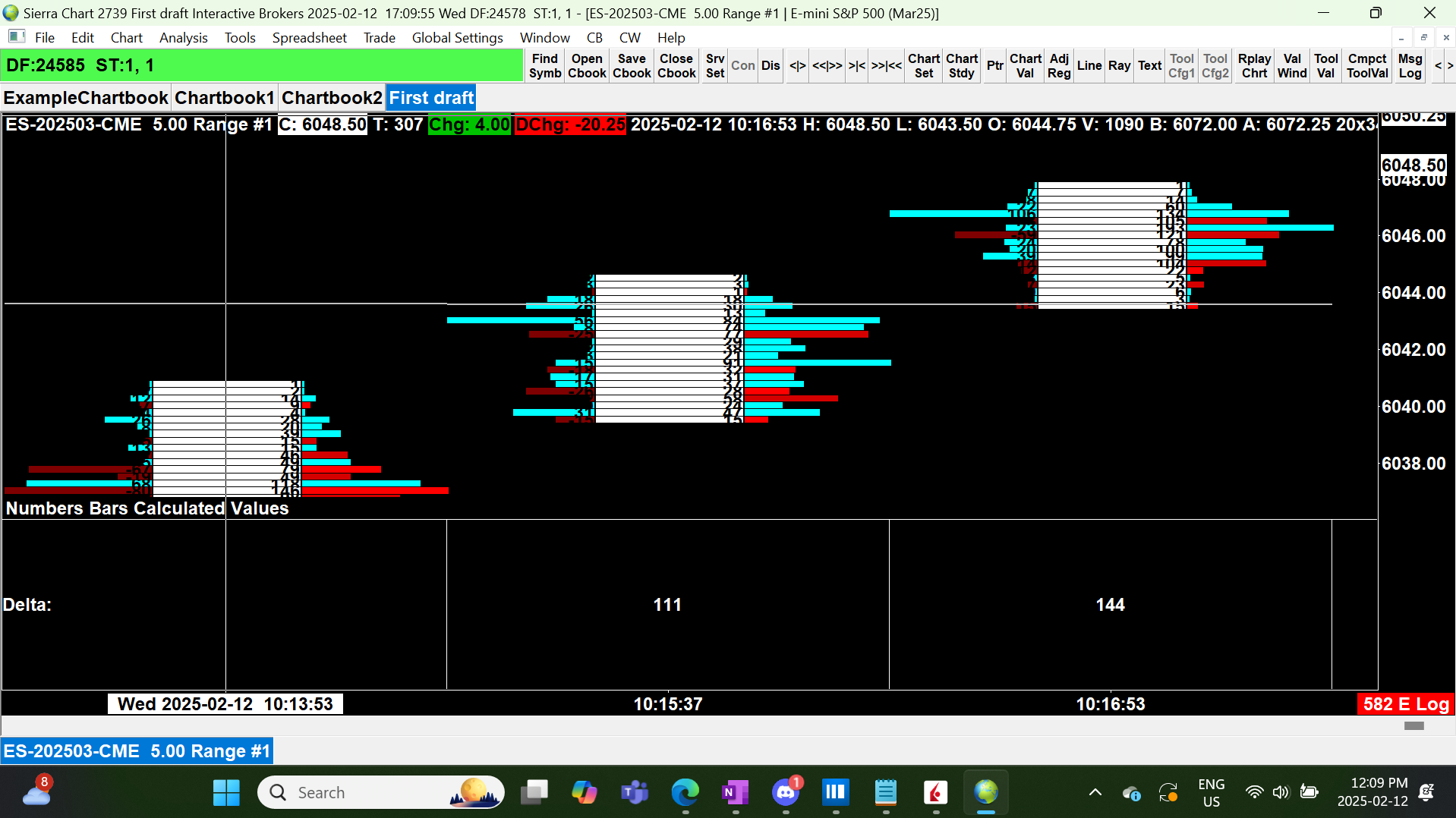

Yes. All I trade is ES from CME group. Nothing else. I have attached todays outlook. The data is incorrect showing a much lower number than what is accurate

[2025-02-12 17:55:59]
The display of the information looks good to us. We can not comment on the accuracy of the data as the data is coming from Interactive Brokers.
If you want to see what our data looks like in comparison, then install a second Sierra Chart and do not change any of the Data/Trade Service Settings. It will be setup by default to connect to our data. You will then be able to get the delayed streaming data in that installation for comparison. Just be aware that the symbol naming is different, so you will need to open the chart through File >> Find Symbol to make sure you get the correct symbol for the ES.
Refer to the following for how to install a second Sierra Chart:
Using Multiple Data and Trading Services at the Same Time: Step-By-Step Instructions to Install Multiple Copies of Sierra Chart
[2025-02-12 19:42:57]
You cannot use Interactive Brokers data for Numbers Bars.
And we do not provide any technical help at all for Interactive Brokers data. None.
