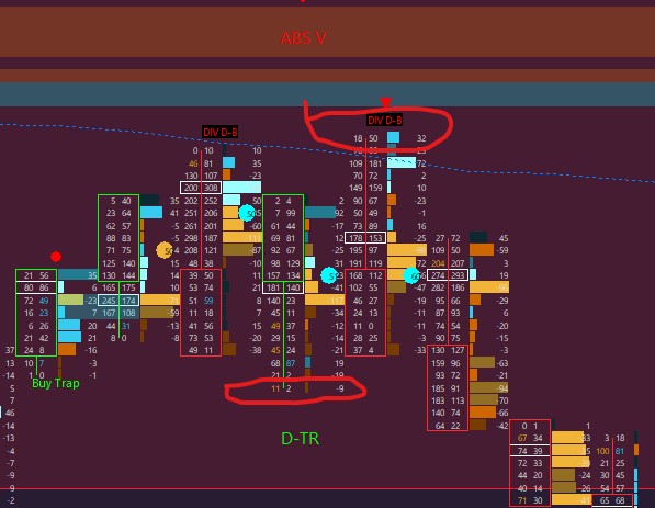

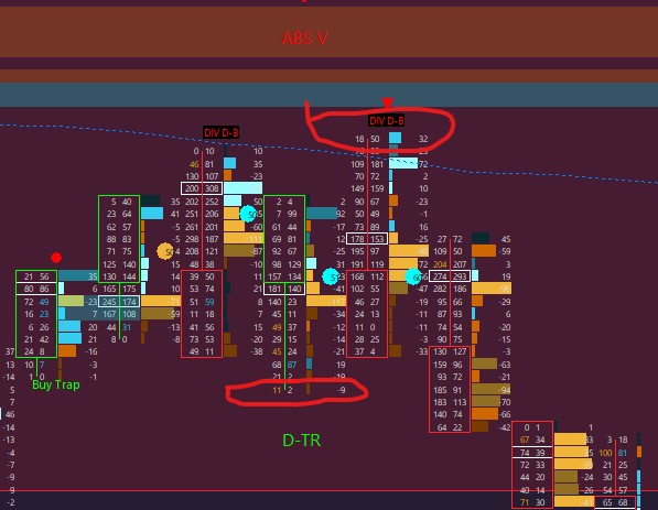

I have another issue, because, i am always trying to improve my FP renko 5T.
I am trying to code with (color bar based on alert condition) a delta tails with the following conditions:
For a Buying Delta Tails (Delta<0 at the very bottom of the bar, total delta of the bar > 0, and a bearish bar)
=AND(C < O, ID1.SG45 < 70, ID1.SG1 > 0)
For a selling delta Tails (Delta>0 at the very top of the bar, total delta of the bar < 0, and bullish bar)
=AND(C > O, ID1.SG46 > 70, ID1.SG1 < 0)
I have satiying results with that formula, but i am not sure if I used the right subgraph to determine accuratly the top and the bottom of the bar within my formula; (see the attached document)
Can you help me figure this out please?
Thank you for your time.

[2025-06-02 13:37:27]
What study is ID1 and what are SG1, SG45, and SG46 of that study?
[2025-06-02 14:24:54]
JabDouks25 - Posts: 22
ID1 (Number Bars calulates Values with delta stats) SG1 (DElta - Ask Volume Bid Volume Difference)
ID39 tNumber bars calculated values), SG45: Low bid Volume percent) and SG46 ( High Ask Volume percent)
I need to find the best subgraph to fin the top and the bottom of the bar if possible.
[2025-06-02 16:07:06]
The Alert conditions allow you to access the Total Volume, Bid Volume, and Ask Volume at each price level within a bar. Refer to the following:
Study/Chart Alerts And Scanning: Special Functions
Therefore, to get the delta (ask - bid) at the highest price point in the bar, you would use the following formula:
=AVAP(H, 0) - BVAP(H, 0)
And to get the same thing at the Low, you change the H for an L and get the following:
=AVAP(L, 0) - BVAP(L, 0)
So your total formula would look like the following:
=AND(C < O, AVAP(L, 0) - BVAP(L, 0) < -70, ID1.SG1 > 0)
