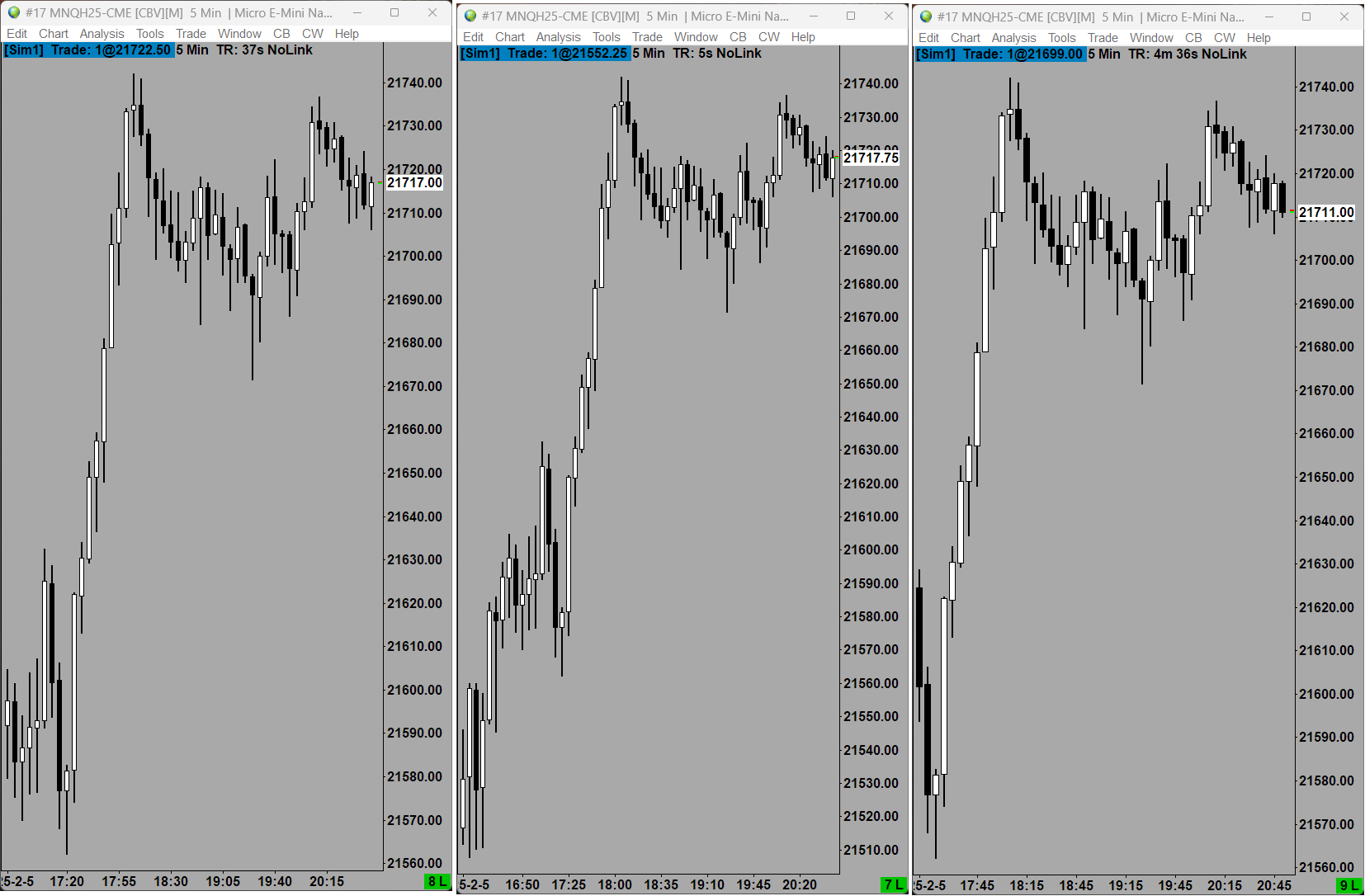

User535599 - Posts: 27
Thank you John,
I can not Increase space between the Bars. Only Decrease width wider bar. NinjaTrader looks better with larger space I do not know how can I solve it at SierraChart.
Date Time Of Last Edit: 2025-02-04 22:15:33
imageNinja_SC.png / V - Attached On 2025-02-04 22:13:52 UTC - Size: 128.32 KB - 340 views
[2025-02-04 22:35:41]
We are really not understanding what you are trying to do.
[2025-02-05 10:45:44]
Is it possible to increase the space between the CandleStick Bars size 8? I am afraid not because 6-7-8 bars size is same just the space is different between the bars. If it possible please show me how can I do it.

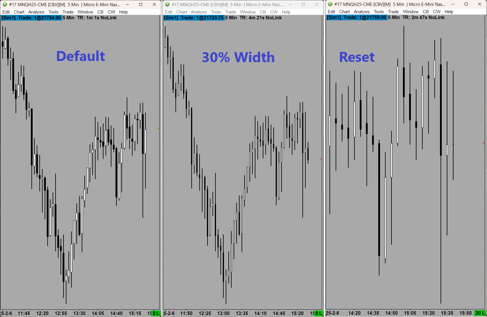

[2025-02-05 20:08:25]
I translated it.
I want to increase the distance between candles. A size 8 candle is fine, but the candles are too close together. At size 7, the candle is the same width as size 8, but the distance between the candles is smaller. At size 9, the candle is already too wide.
That's why I want to use a size 8 candle with more width between the candles.

[2025-02-06 13:54:15]
Sawtooth - Posts: 4361
Please show me which setting I can use to increase the distance between CandleStick Bars size 8
Try this:
1.
Go to Global Settings >> Graphics Settings - Global >> Other tab:
Set the Candlestick Width % to 30.
Set the Default Chart Bar Spacing to 20
2. Go to Chart >> Reset Bar Size/Spacing/Scale
3. Drag the Size to 20.
This will visually give you more space between candlesticks that appear to be similar to the former Size 8.
There is no other way to do what you want.

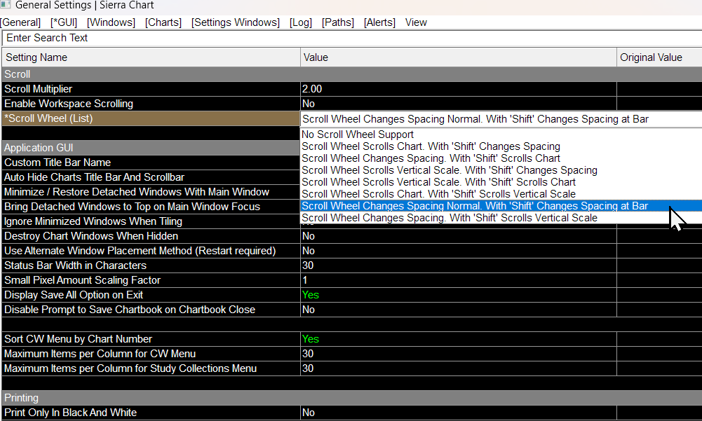

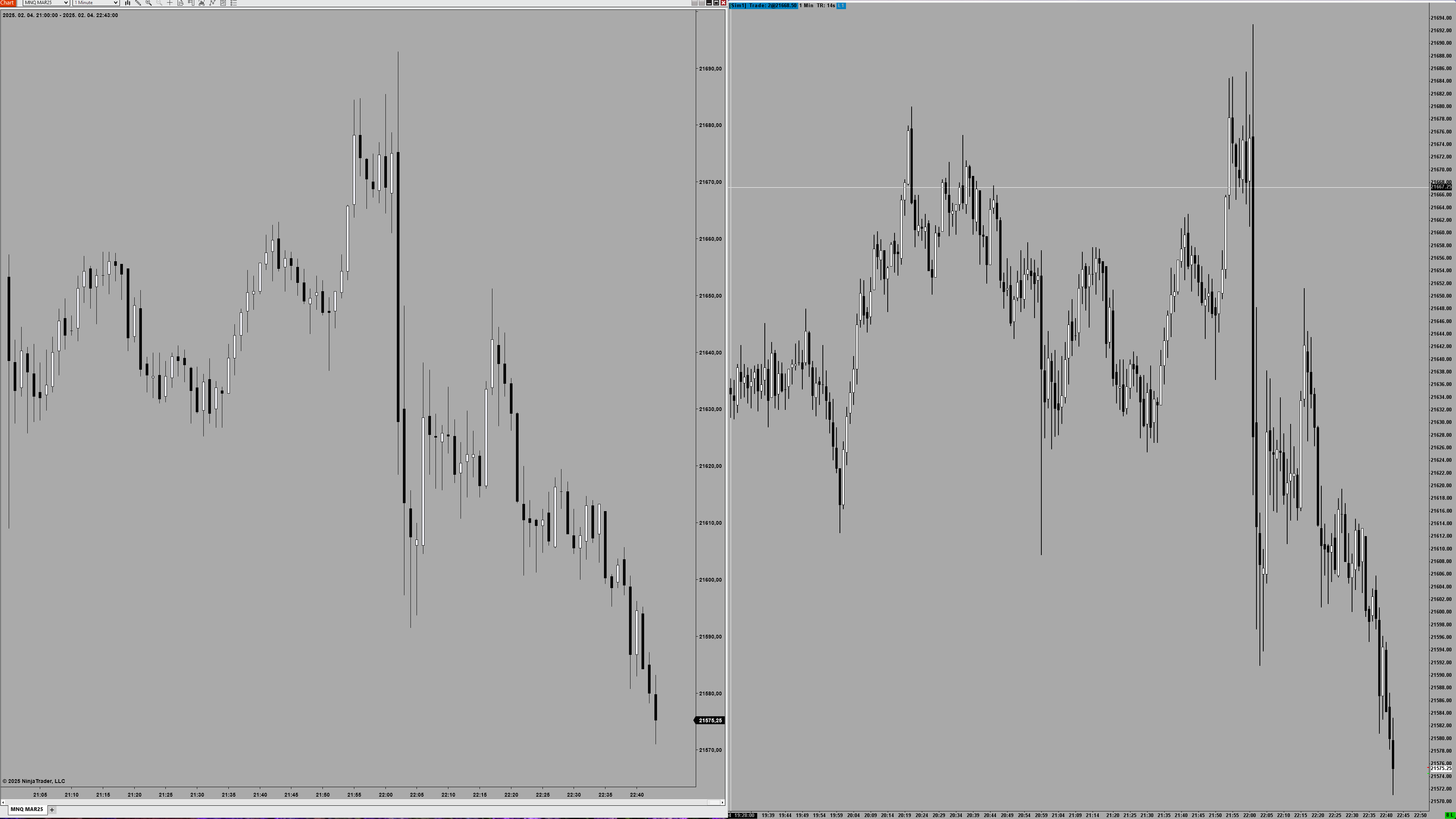

Dear Sawtooth,
Thank you for your help. Not possible to increase the space between the CandleStick Bars, just decrease bar Width. That is the problem. If it is possible please forward my request to SC developers. Maybe they can fix it in the next update. I thought in the Scroll Wheel menu was the solution, but unfortunately it isn't either.

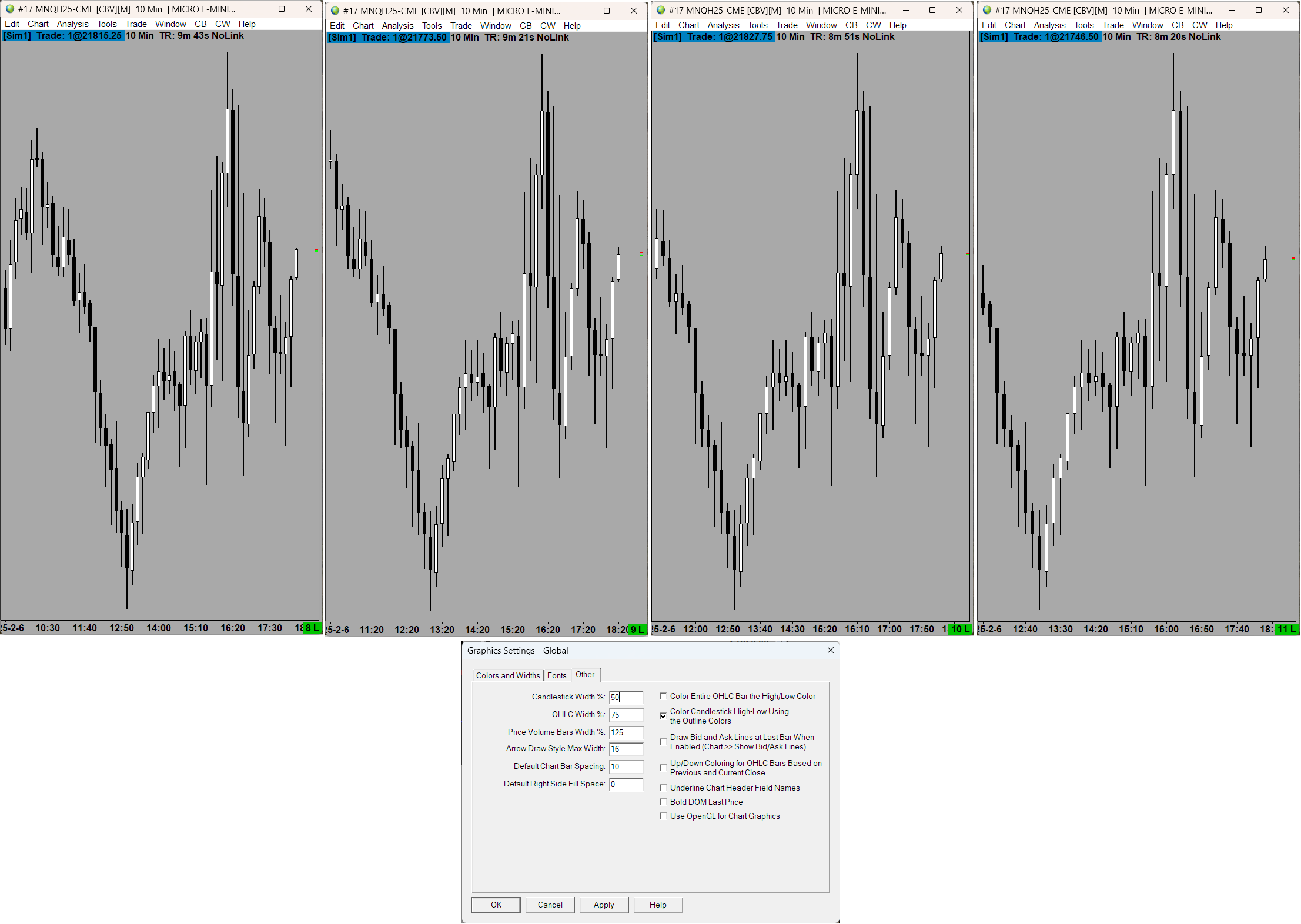

[2025-02-06 17:30:00]
With this settings 8-9-10-11 CandleStick Bars Width are same, space is different.
imagefinally.png / V - Attached On 2025-02-06 17:29:38 UTC - Size: 209.93 KB - 312 views
[2025-02-06 18:55:00]
Those two settings seem to interact with each other in unexpected ways.
It's a goofy workaround but that is as good as it gets.

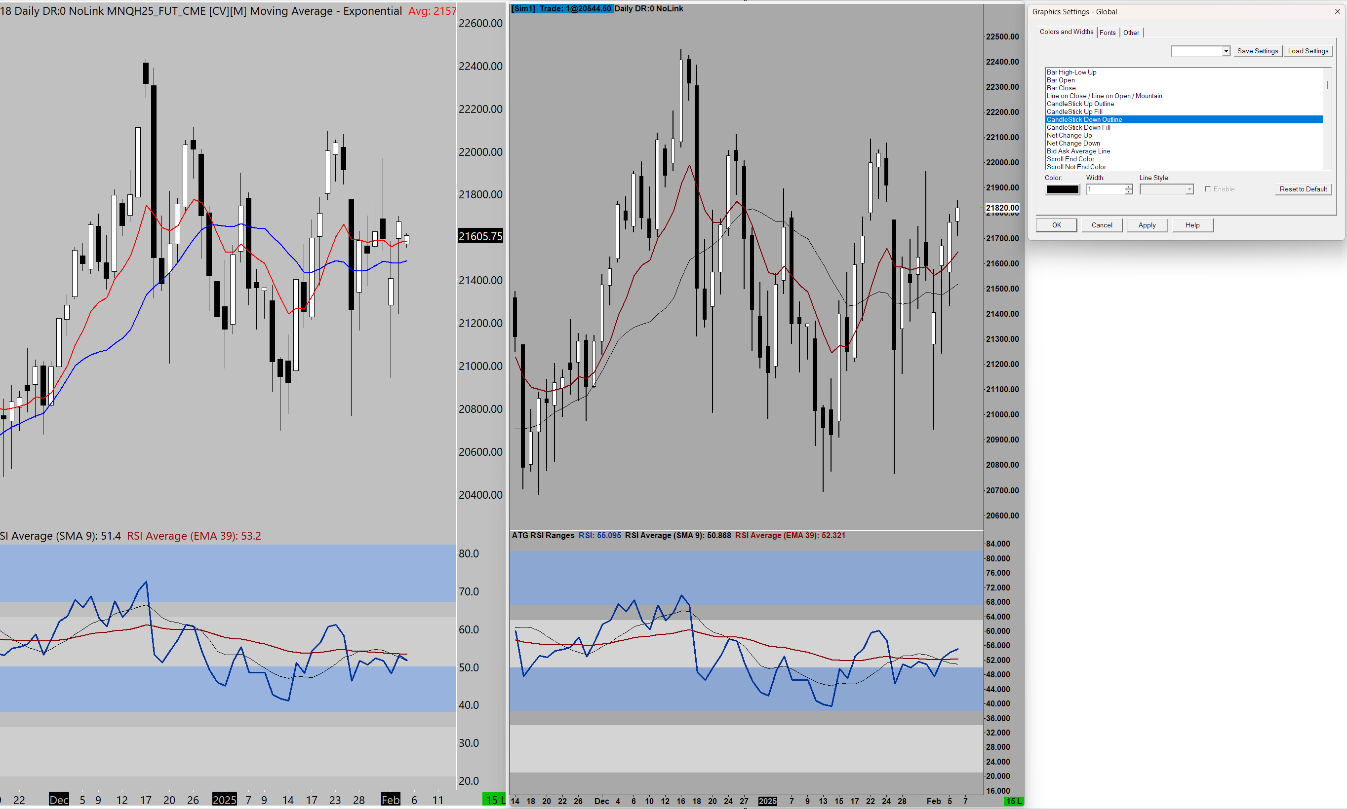

[2025-02-06 19:29:19]
Sorry, this is my last question in this treads. :)
My colleague SC Candlestick Wicks are thinner, they look better. How can I set it? We have same Outline Width:1.
imageCandlestick Wicks.png / V - Attached On 2025-02-06 19:28:06 UTC - Size: 149.23 KB - 254 views
[2025-02-06 20:01:07]
Go to Global Settings >> Graphics Settings - Global >> Colors and Widths tab >> Bar High/Low Down [and Bar High/Low Up]
and set the Width to your requirements
