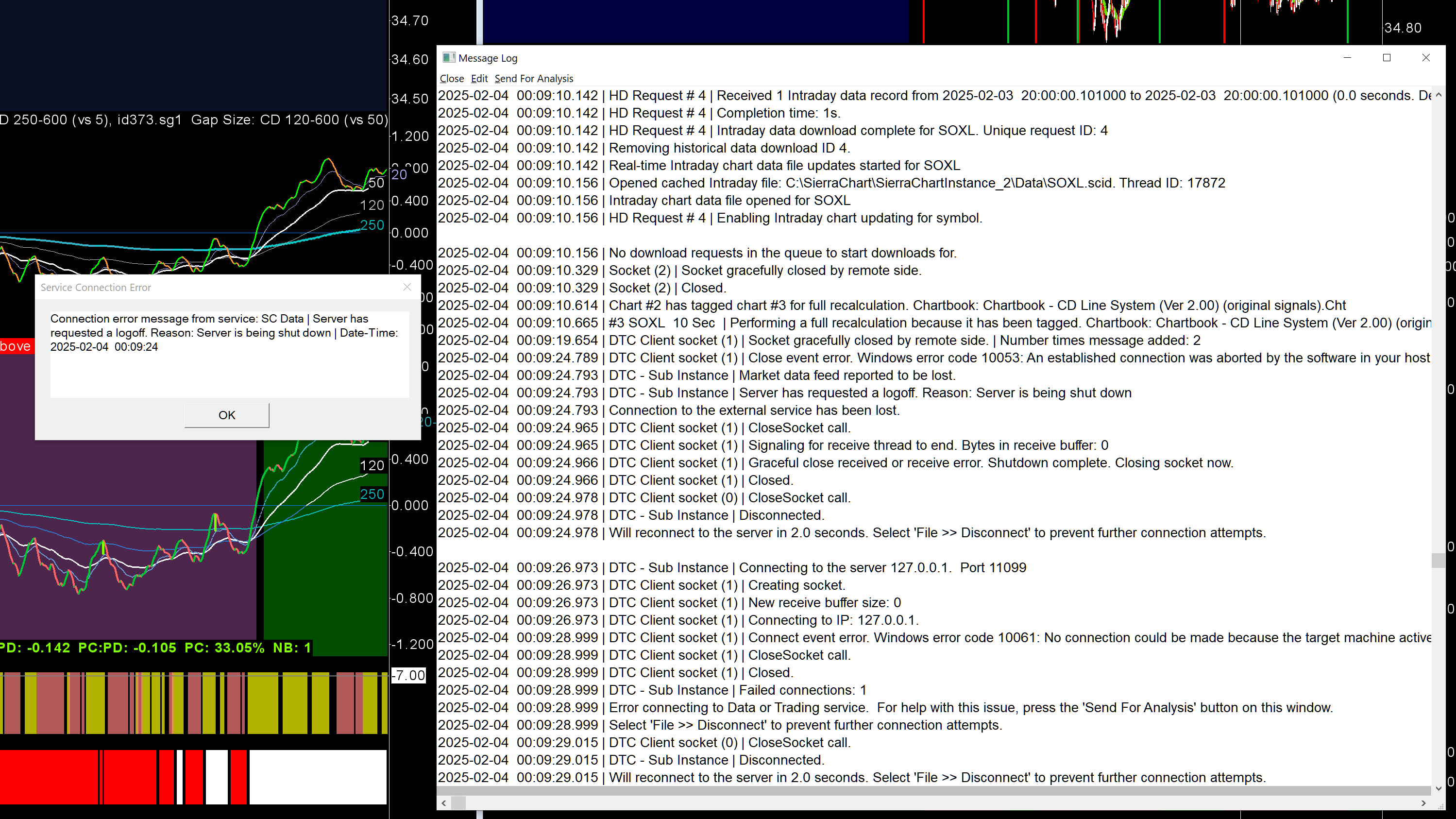

Not sure why it's acting like this now. Never had an issue before.
I updated all instances of SC to the most recent Current Version.
The only way I can connect to data on the sub-instance is by first connecting to data on the main instance.
Previously I didn't need to turn on the main instance and could just run the sub-instance independently.
When I disconnect from the data feed on the main instance, I get a popup error message on the sub-instance, which I took a screenshot of and attached.
imagesc error.png / V - Attached On 2025-02-04 05:12:36 UTC - Size: 367.53 KB - 243 views

This is how a sub instance works:
This is nothing new.
This would only occur if you actually completely exit from the main instance:

If that's the case, how can I make the sub-instance its own standalone instance
You cannot do it this way. You just need to set up a separate installation of Sierra Chart, set to a Service other than the DTC Sub Instance service.
Using Multiple Data and Trading Services at the Same Time
