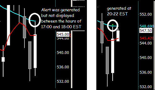

[2025-01-26 16:07:01]
User14953 - Posts: 268
Daily TMF[M] chart from Friday the 24th as viewed on Sunday.
Although a cross from below trigger posts in the Alert Manager window,
the alert's point on high is not displayed for the last daily bar after TMF close.
What is the remedy for the alert not displaying on the chart?

[2025-01-29 01:40:17]
Is the marker present prior to the close?
No.
An alert was generated but not displayed
between the hours of 17:00 and 18:00 EST while the market was closed.
The alert mgr was cleared and then
when reconnected at 20:22 EST an alert was generated and displayed.
imagesierrra image.png / V - Attached On 2025-01-29 01:39:34 UTC - Size: 13.28 KB - 254 views

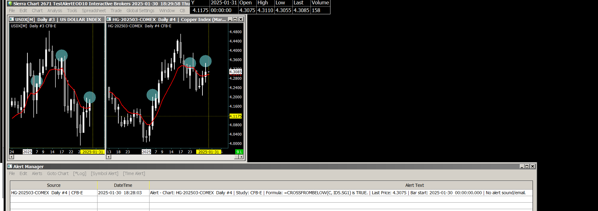

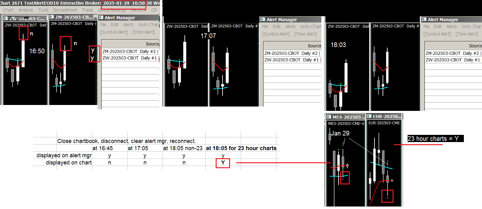

[2025-01-29 23:51:47]
"If it occurred when the market was closed"
No alerts occurred when the market was closed.
Is there a way to get an alert displayed on the chart after close, but before next bar start, in all cases?
After 18:00, 2 of 4 charts displayed alert markers on the chart and 2 did not.
The two that did also initiated the next bar.
In no case did the alert's point on high display for the last daily bar after close but before next bar start.
imagesierrra imageB.png / V - Attached On 2025-01-29 23:45:36 UTC - Size: 66.12 KB - 224 views

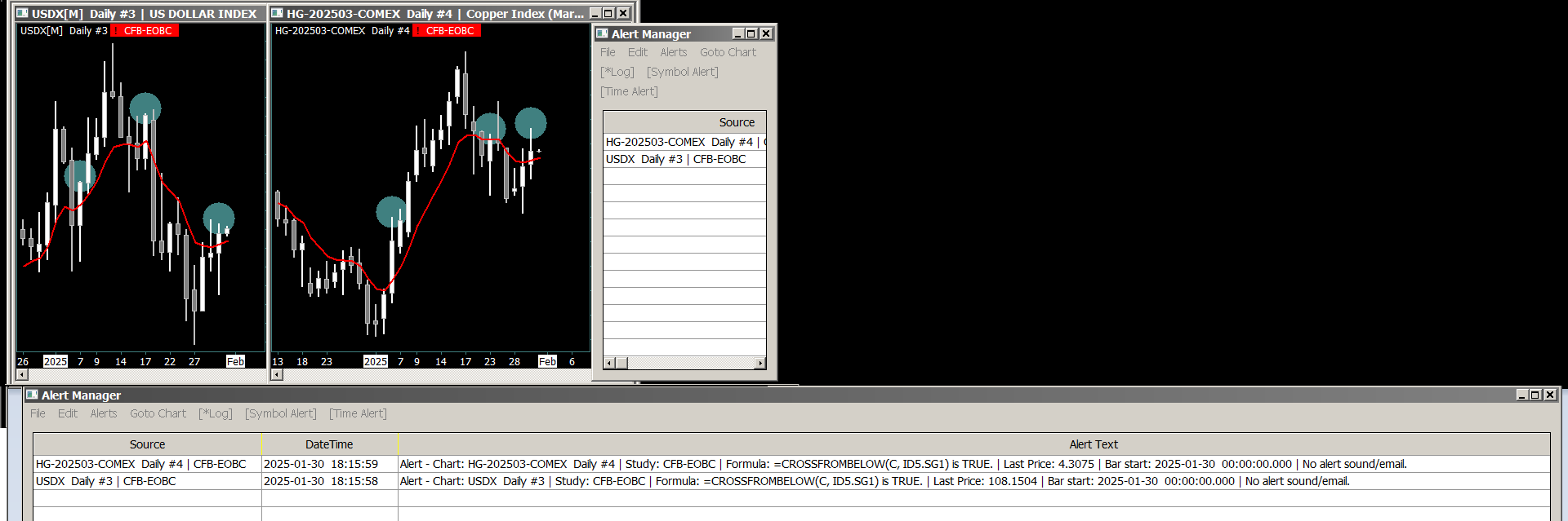

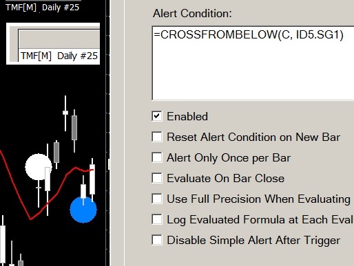

[2025-01-30 14:53:58]
We need to see the full text from the alert manager for the alert.
[2025-01-30 23:48:12]
"We need to see the full text from the alert manager for the alert."
imagesierrra imageC full text from the alert manager for the aler.png / V - Attached On 2025-01-30 23:47:15 UTC - Size: 81.75 KB - 251 views
imagesierrra imageD full text from the alert manager for the aler.png / V - Attached On 2025-01-30 23:47:27 UTC - Size: 56.44 KB - 230 views
imagesierrra imageE full text from the alert manager for the aler.png / V - Attached On 2025-01-30 23:47:35 UTC - Size: 61.08 KB - 205 views

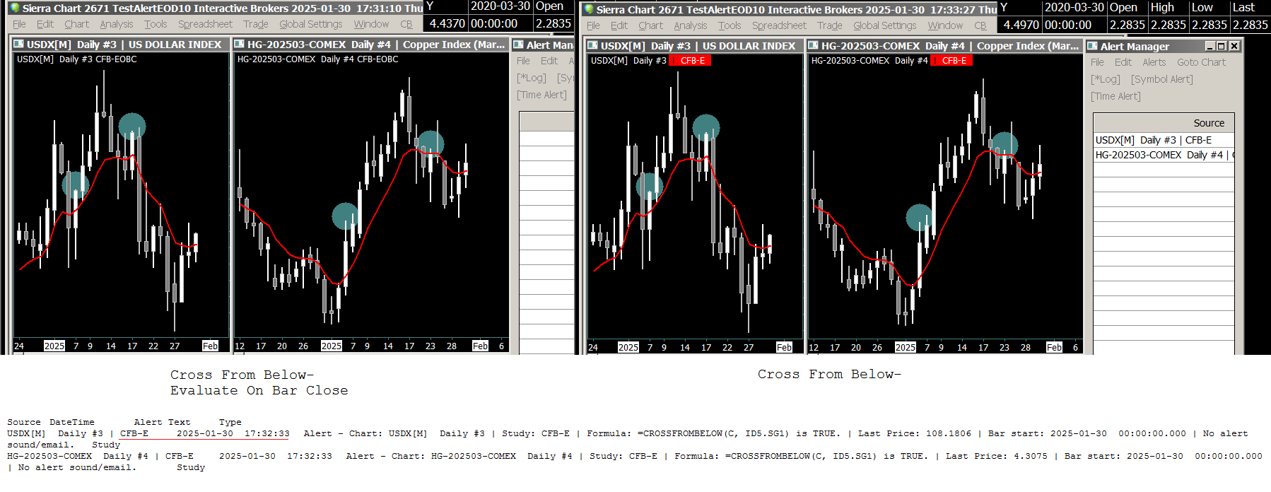

[2025-01-31 15:49:56]
We believe you have the "Enabled" option enabled on the Alert tab for the "Trading System Based on Alert Condition". In this case, the Alert itself will go off, even though the trading system is not set to make a trade at that time, as you have the Input for "Evaluate on Bar Close Only" set to "Yes".
This is also why you are not seeing the marker when the Alert is logged in the Alert Manager. These are two different things - the alert itself and the trading system. The Trading System will use the alert formula that is setup for it, but the notifications for the alert (from the Alert Tab) are separate.
If you want to make them match up, then you would need to enable the option for "Evaluate On Bar Close" on the Alert Tab as well.
