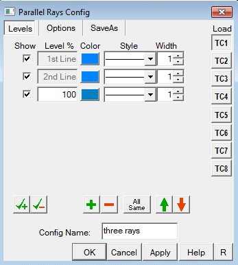

trader1 - Posts: 128
I tried that earlier and I have attached a screenshot of how I configured the settings, but I still get only two lines. Also will the parallel lines tool do the same thing?
imagesierrachart parallel rays settings.gif / V - Attached On 2014-09-18 13:57:02 UTC - Size: 13.78 KB - 506 views
[2014-09-18 18:23:33]
A 100% level will not show an additional line. That will be drawn right on top of the second line. The documentation does explain this.

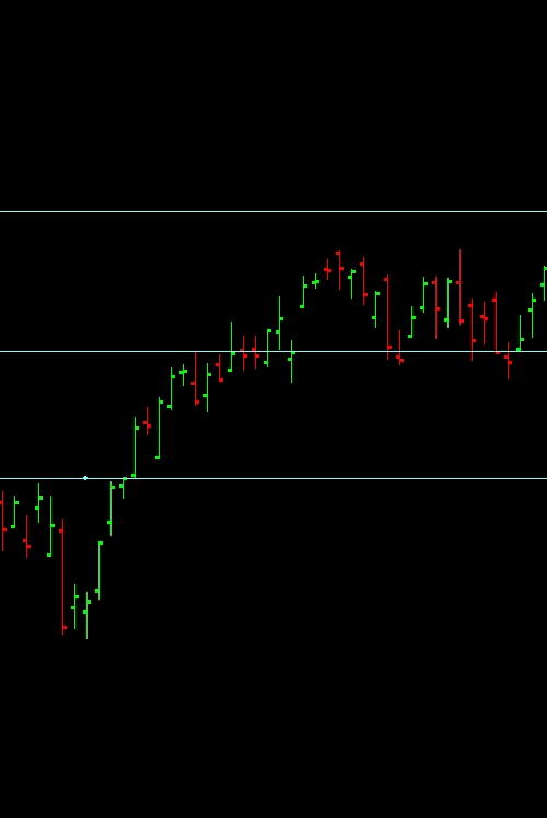

Actually, what I would like is three parallel lines equidistant from each other (i.e. one line five points above the middle line and another line five points below the middle line). I would also like these three lines to move as a group if I select "move drawing" from the menu.
Thanks.
imagesierrachart three parallel lines.jpg / V - Attached On 2014-09-18 19:02:36 UTC - Size: 31.07 KB - 511 views
[2014-09-18 19:09:24]
Set the third Level % to 200.
