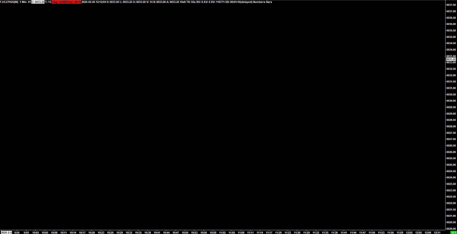

I just got my account running with sierra chart. I believe everything else is working except when i try to use the footprint/number bars it loads all the way up to 99% then i get this message log pop up 2025-01-22 17:19:29.198 | Loaded depth data records for F.US.EPH25 2025-01-22 from 2025-01-22 10:49:38.758000 to 2025-01-22 10:54:42.057023.
2025-01-22 17:19:29.209 | F.US.EPH25[M] 1 Min #1 | Chart data loading complete. 2025-01-22 17:19:53.461 | F.US.EPH25[M] 1 Min #1 | Reloading chart. 2025-01-22 17:19:58.448 | F.US.EPH25[M] 1 Min #1 | Caught an unhandled exception in c_Chart::WindowProc. Message: 15, wParam: 0, lParam: 0 * 2025-01-22 17:19:58.448 | F.US.EPH25[M] 1 Min #1 | Chart data loading complete. 2025-01-22 17:19:58.759 | F.US.EPH25[M] 1 Min #1 | Caught an unhandled exception in c_Chart::WindowProc. Message: 15, wParam: 0, lParam: 0 * 2025-01-22 17:21:52.406 | F.US.EPH25[M] 1 Min #1 | Caught an unhandled exception in c_Chart::WindowProc. Message: 15, wParam: 0, lParam: 0 | Number times message previously added: 21 * 2025-01-22 17:22:02.302 | F.US.EPH25[M] 1 Min #1 | Caught an unhandled exception in c_Chart::WindowProc. Message: 15, wParam: 0, lParam: 0 | Number times message previously added: 23 * Really need some help with this |

I am using ARM version of windows 11 on surface pro 11 with snapdragon x elite. Not sure if thats the issue but everything else works fine except the number bars study.
| [2025-02-04 23:46:59] |
| Sierra_Chart Engineering - Posts: 25441 |
That must be the issue. We are adding additional exception handling to further isolate the location of the problem.

2025-02-05 12:19:48.658 | No download requests in the queue to start downloads for.
2025-02-05 12:19:48.660 | F.US.EPH25[M] 1 Min #1 | DrawNumbersBarV2 exception. | Number times message added: 143 2025-02-05 12:19:48.669 | Socket (3) | Socket gracefully closed by remote side. 2025-02-05 12:19:48.669 | Socket (3) | Closed. 2025-02-05 12:19:48.771 | F.US.EPH25[M] 1 Min #1 | DrawNumbersBarV2 exception. | Number times message added: 1439 2025-02-05 12:19:52.880 | Opened cached Intraday file: C:\SierraChart\Data\F.US.EPH25.scid. Thread ID: 15228 2025-02-05 12:19:53.247 | F.US.EPH25[M] 1 Min #1 | DrawNumbersBarV2 exception. | Number times message added: 2303 2025-02-05 12:20:02.654 | ExtendTheFundedTradingAccountStatusExpirationDate: Sending request. 2025-02-05 12:20:02.835 | ExtendTheFundedTradingAccountStatusExpirationDate | Result: {"Result":"The Funded Trading Account Status Expiration Date is more than 25 days into the future. The Date is currently: 2025-03-04"}. Success=true 2025-02-05 12:20:03.036 | F.US.EPH25[M] 1 Min #1 | DrawNumbersBarV2 exception. 2025-02-05 12:20:12.778 | F.US.EPH25[M] 1 Min #1 | DrawNumbersBarV2 exception. | Number times message previously added: 2591 2025-02-05 12:20:22.586 | F.US.EPH25[M] 1 Min #1 | DrawNumbersBarV2 exception. | Number times message previously added: 2735 Says historical data download is complete and getting no alerts but chart is blank Date Time Of Last Edit: 2025-02-05 12:21:36
