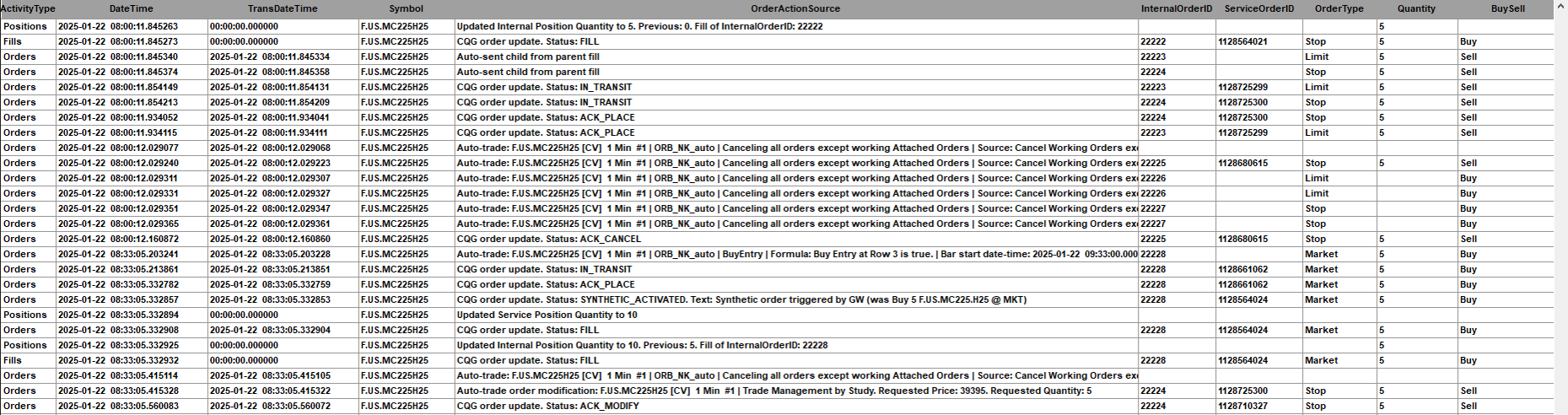

The TAL for the live session makes no mention of scaling in or changing child orders. However in the replay TAL there are two lines that do that... "Scale-In: Increasing quantity of child order by 5 due to order fill on the same side". There is one entry for the target and one for the stop loss. These entries do not exist in the live TAL. I have attached that Live TAL. The scale-in happened at 08:33:05

Hello, I was hoping this could be addressed. Scale-In adjustment of attached orders did not work in live trading, as per the attached trade activity log.

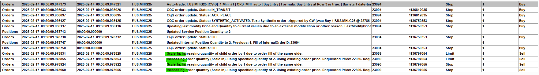

I have looked at the TAL for a session where Scale-In worked correctly. See attached "TAL_correct", these items in green are MISSING from the TAL for the session where the attached orders did not increase in quantity correctly. In the session where it didn't work, SC never sent the instruction for Scale-In and increase quantity of child orders - I had to increase the attached order quantity manually.

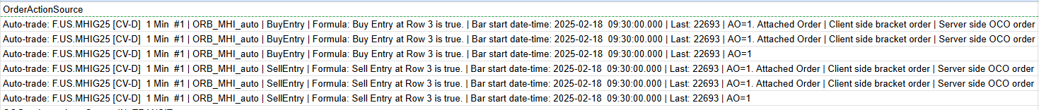

Yes, for the day where size was not increased for Scale-In, there is AO=1. Please see attached image.
What else might cause Scale-In to intermittently not work for attached child orders?

Sierra_Chart Engineering - Posts: 25484
Were those attached orders in the screenshot sent and became working orders?
We cannot tell why scaling in did not work but here are complete details of the required conditions:
Attached Orders: Scaling In
We are just getting little snippets of information. It is impossible for us to be analyzing this. We do not have the Trade Activity Log.

2. MHI_Correct_TradeActivityLog_2025-02-17 ... this is the TAL for a trade on Feb 17th where Scale-In worked correctly (as it usually does).
At 9:30:10 you see the second fill and the Scale-In comments in row 48 in a spreadsheet.
