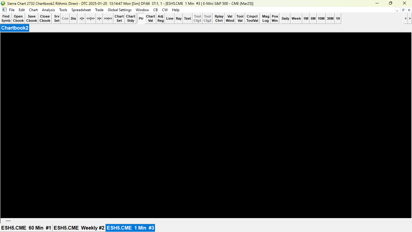

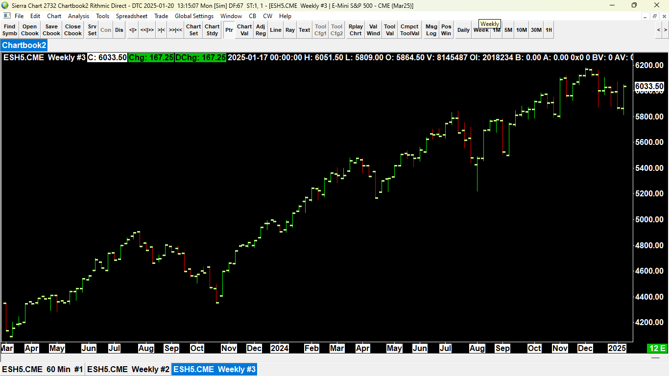

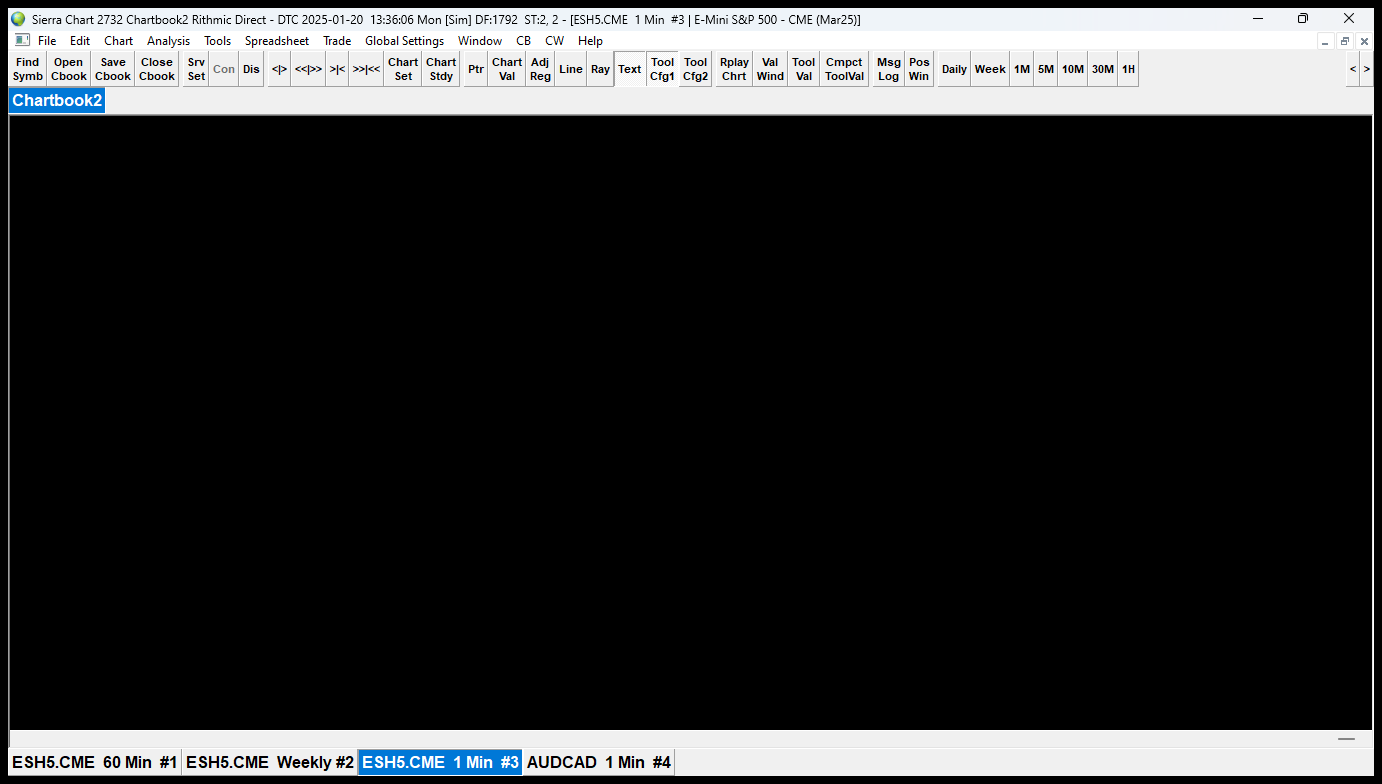

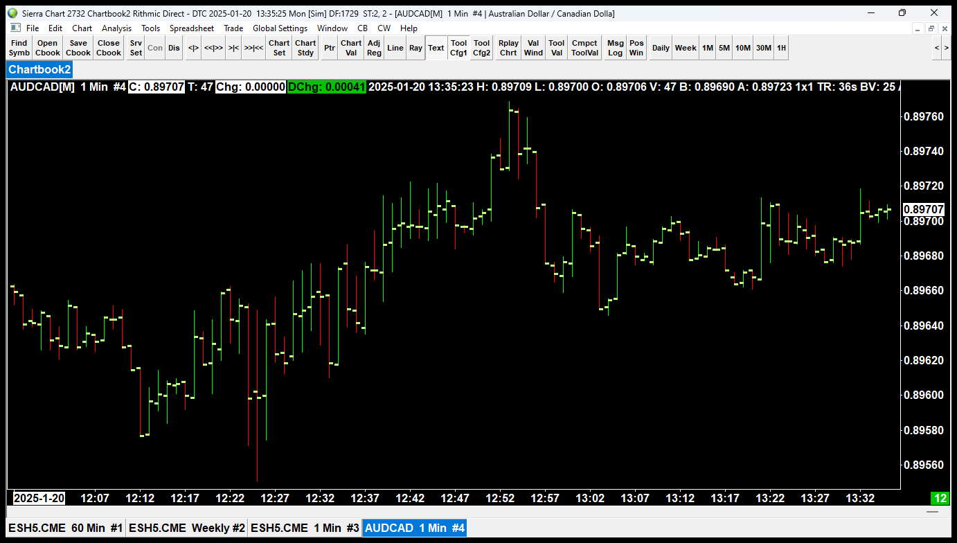

Hi, I wanted to see if I could get some help with my current issue. My futures charts such as es,only seem to load higher time frames like the weekly and daily but wont load for my lower time frames(1min-1 hr). While all my other symbols like forex seem to working just fine. I have the #12 package for sierra and bought a funded account through topstep including their lvl 2 data. When I try to load es or other futures contracts in lower timeframes the price scale and the time scale both disappear, and dont show up later no matter how long i wait. The link I have posted below are screenshots of what my screen looks like the first is aud/cad on the 1 min time frame and the 2nd is es on the same time frame. Notice how the second shows nothing but a blank screen, that is how mines looks every time i try to load up any time frame from 1 min to 1hr.
https://www.sierrachart.com/image.php?Image=1737398126164.png
https://www.sierrachart.com/image.php?Image=1737398167578.png

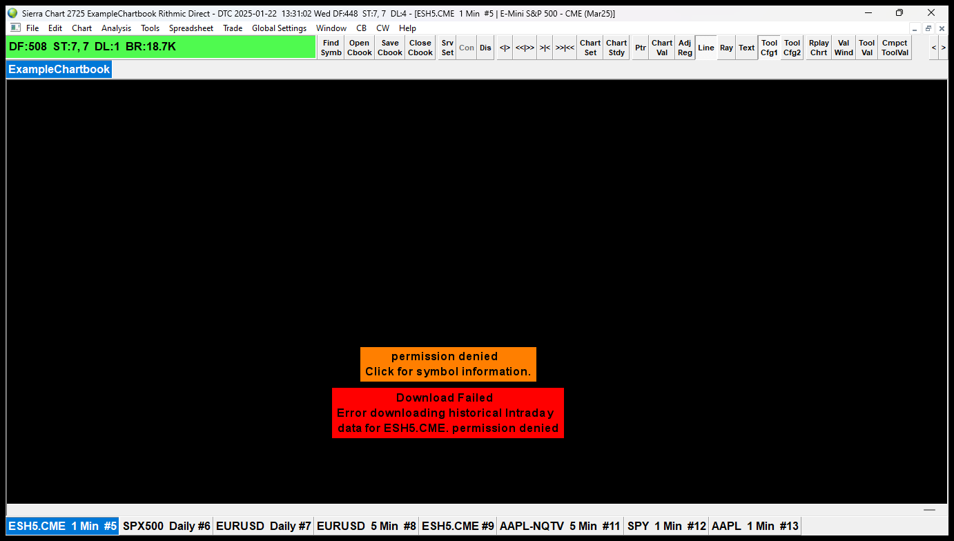

Hi I tried downloading multiple versions of SC before 2728 and now receive the message "Download Failed, Error downloading historical intraday data for ESH5.cme. Permission denied". This is on version 2725 with my current selceted service being rithmic. But when I switch it to sc data it works fine. But I want to be able to use the account prop account I paid for.
https://www.sierrachart.com/image.php?Image=1737570663566.png

Refer to the following:
Rithmic Trading Platform Service: Permission Denied Resolution Procedure

None of these have resolved my issue im not sure whats happening. Im using rithmic as my service but sierra as my trading data, my higher time frames pop up but lower time frames just show a blank screen and no longer has the "permission denied" like I stated before. It's like the program wants to load it but cant, and this happens on previous versions of sierra as well. I've logged into rithmic to see if I needed to sign anything but nothing has showed. I've asked folks on reddit and they seem just as confused, I should be able to use denali while trading on my prop account but that doesnt seem to be the case here.
