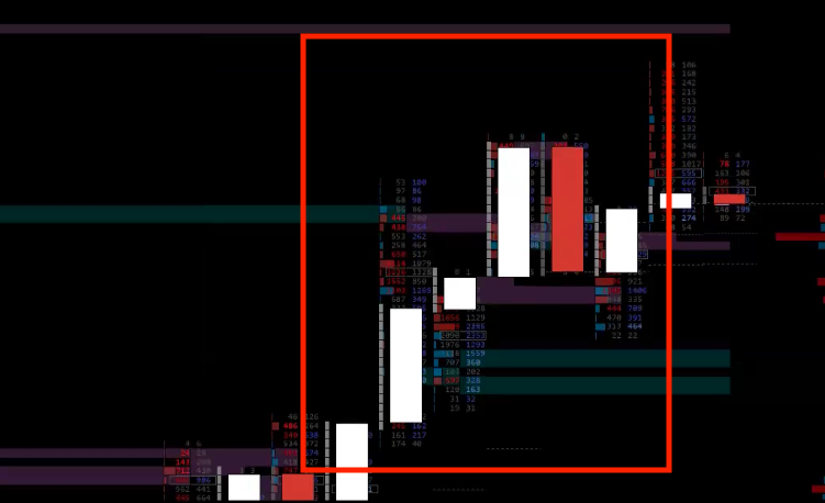

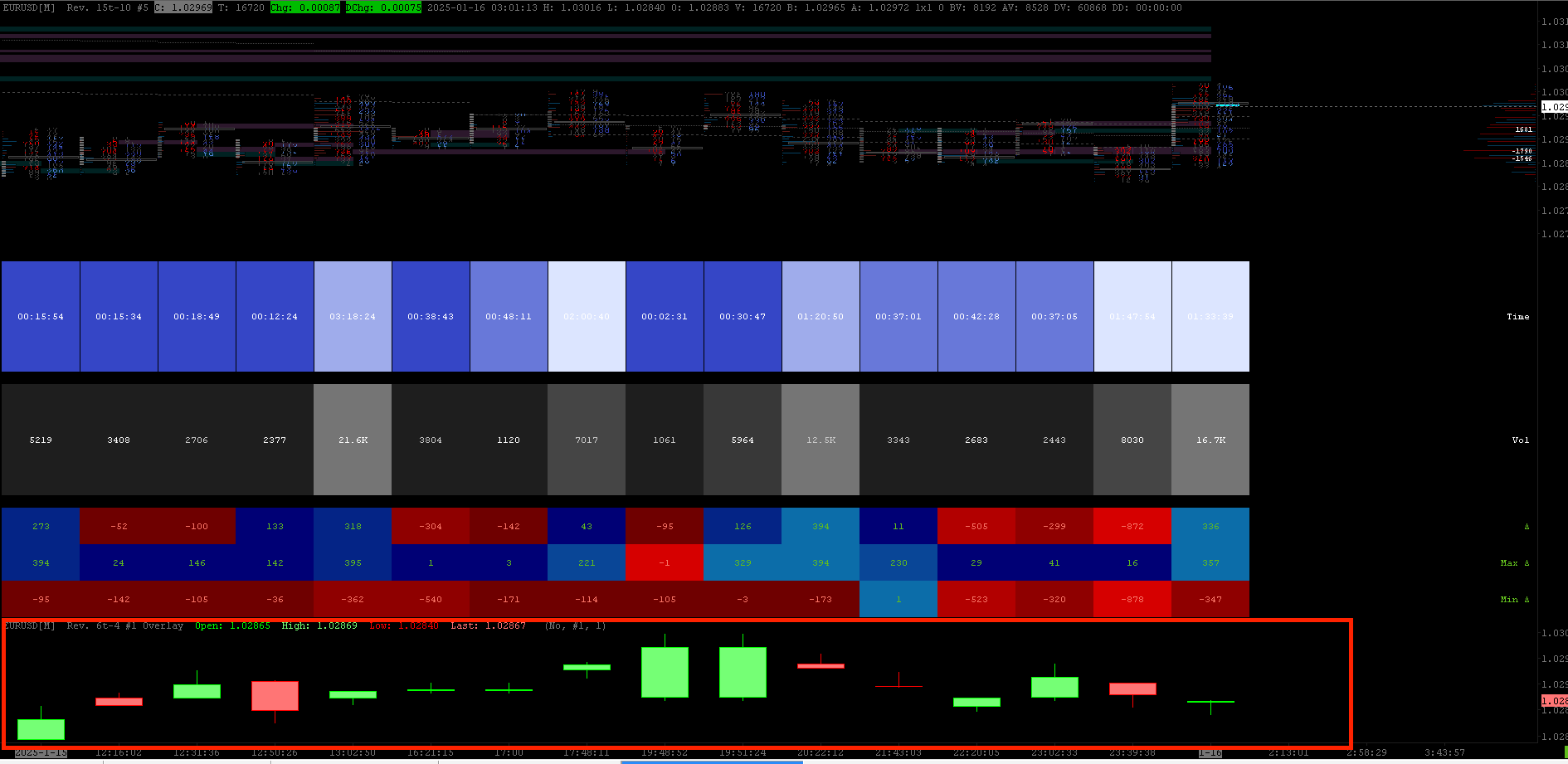

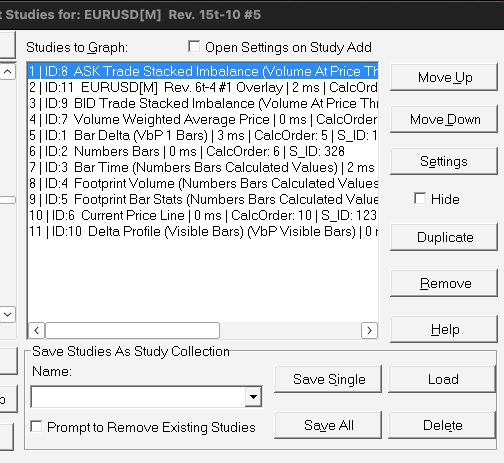

I have one more question regarding technicality on the chart. I am using footpring chart and I want to add overlay bar study to show candles more visible on the chart. But when I add the study "Overlay bar", the candles go to the bottom of the charts as you can see on the screenshot.
What do I have to do to make study overlays the chart like it's shown on the screenshot? I attached examples.

The first thing you need to do in order to move the overlay from the bottom to be within the main chart is to change the Region for the overlay to be in Region 1. Refer to the following:
Chart Studies: Settings and Inputs Tab >> Chart Region
Then, you would want to change the Candlestick Width within the Graphics Settings for that chart in order to make the bars thin so they fit in between the columns. Refer to the following:
Graphics Settings: Candlestick Width %
