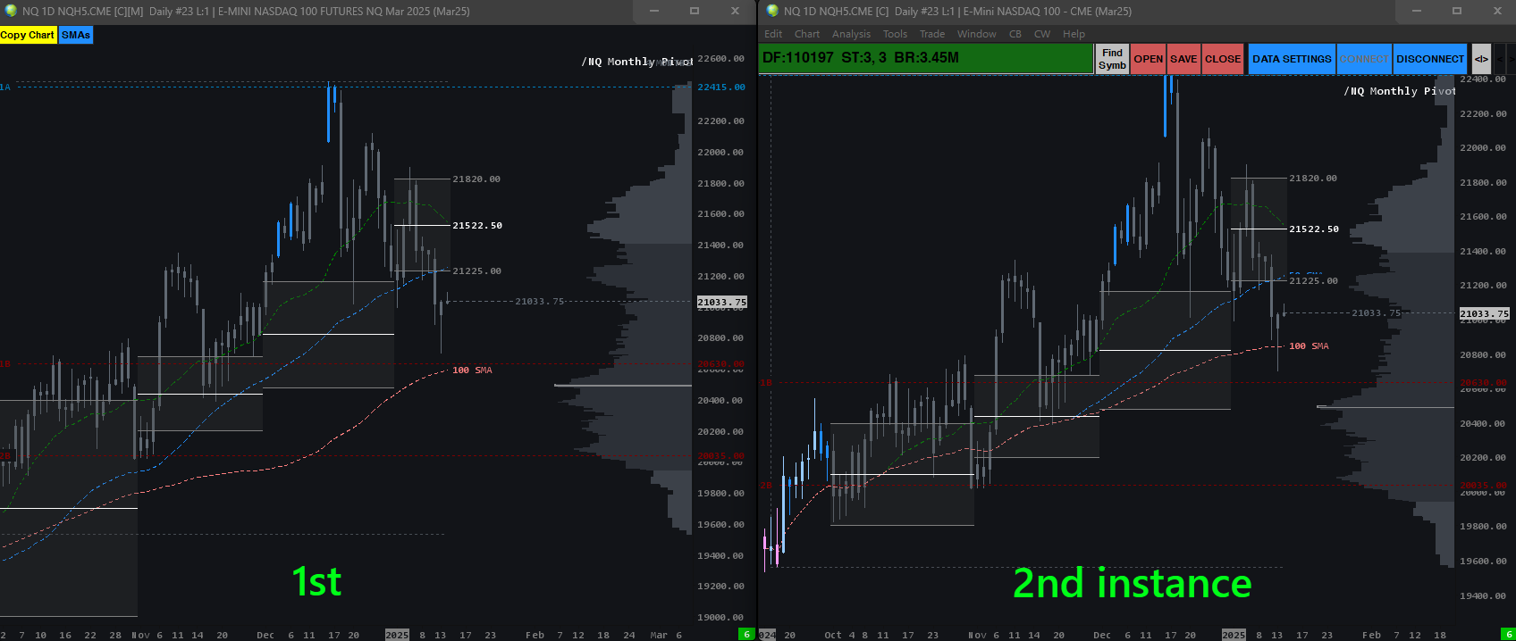

i have a second instance open for my execution but i just noticed that one of the overlay study is different from my execution instance.
i look at the chart that referencing the study and compare it to the 1st instance and found out that the Daily SMA levels are different.
i tried to look at the chart settings and make them the same but the study is still at different levels.

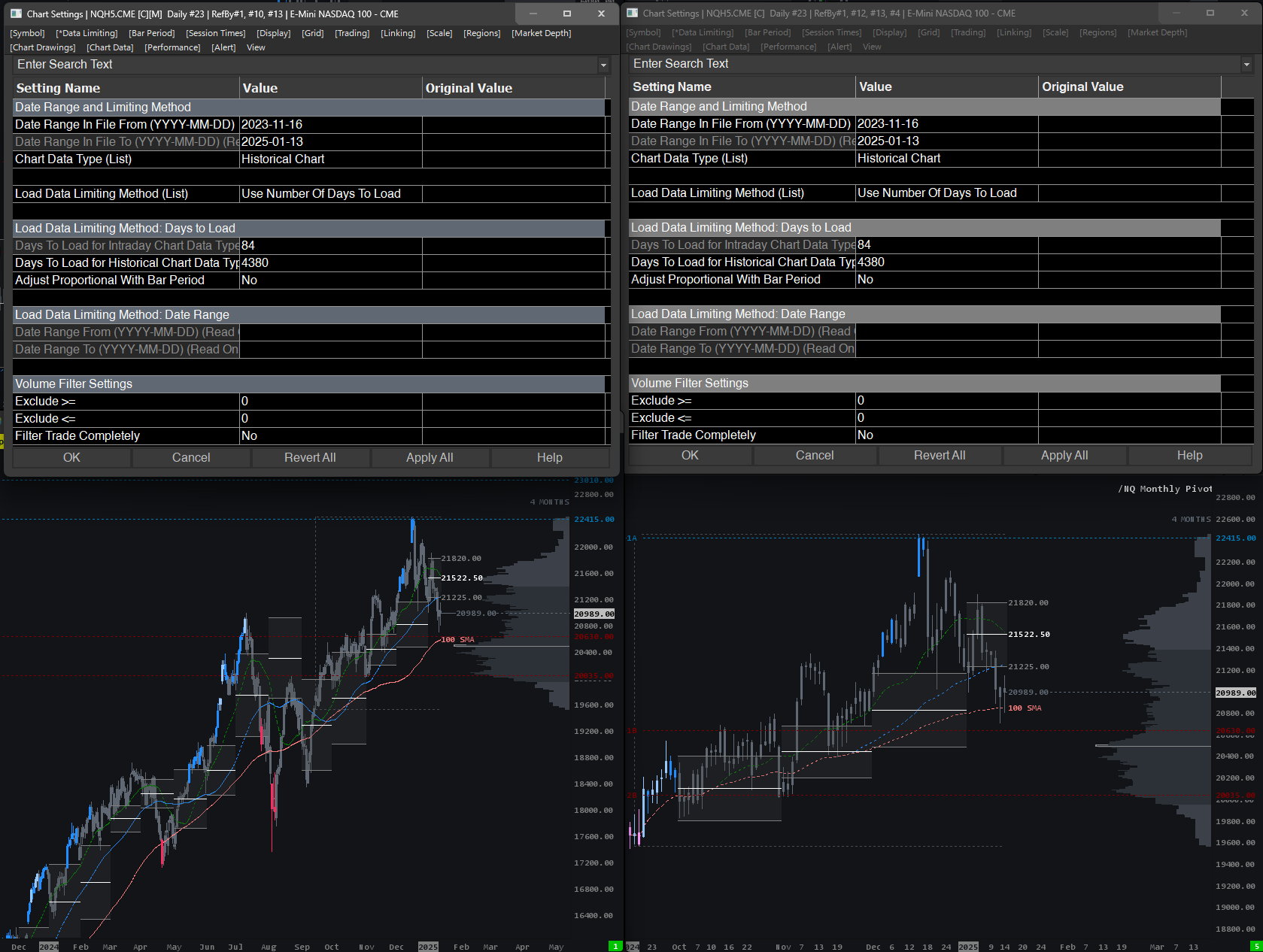

already checked that and all the chart settings are the same. i still cant find why the levels are different.
the only difference i see are the data loaded. but i cant make the second one load more data like the other.

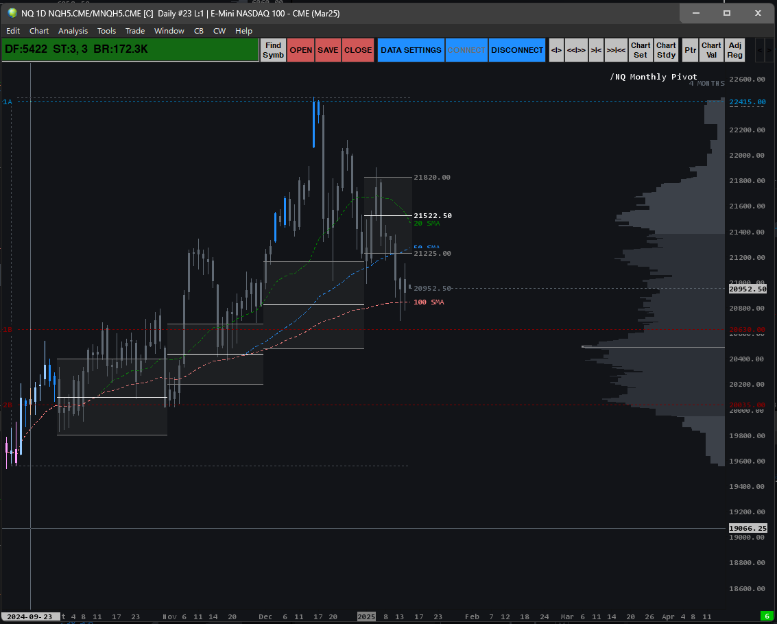

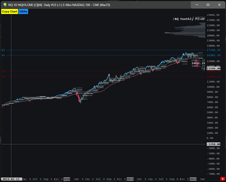

on the first instance, the chart goes way back to 2019 while on the second instance, the last date was just around 2024.
i even dont know why the first chart is displaying that long of historical data even tho set up the chart to load 84 days of data

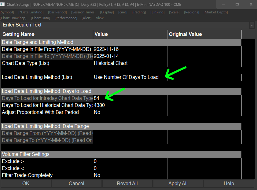

how can i make the 2nd instance chart to load the same historical data like like the first one?
chart data is already set to historical
load data is set to use number of days to load
and the days of historical data to load is set to 4380
and yet the chart doesn't load the historical data

The SMA levels are different due to the difference in the loaded data.
In the instance where the data only goes back to September 23, 2024, please make that chart active and select "Edit >> Delete All Data and Download". A window will come up asking what contracts you want to delete and redownload the data, select the button at the bottom for "Select All" and then select OK.
