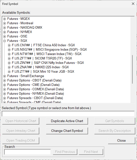

I have double checked with my broker and I am enabled for SGX FX Futures Level 2 and SGX Index Futures & Options Derivatives. But when I look up the Find Symbol I can only see the latter?
imageSierraChart_64_PfdWTABtMq.png / V - Attached On 2025-01-14 17:56:22 UTC - Size: 37.45 KB - 269 views

You need to type in the symbol as you need it in the "Selected Symbol" field. You would need to check with CQG on the symbol format you need for any particular item that is not already listed.

The symbol is F.US.ZUCH25 I tried that as well but only a black chart

We notice there are no trading months listed to the right for the futures (the link you gave above is for the Put Options). We wonder if this means something in particular in relation to the data from CQG. You would need to check with them on this.
