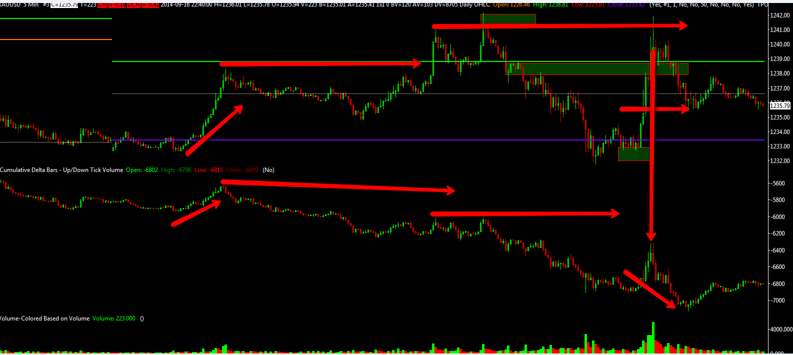

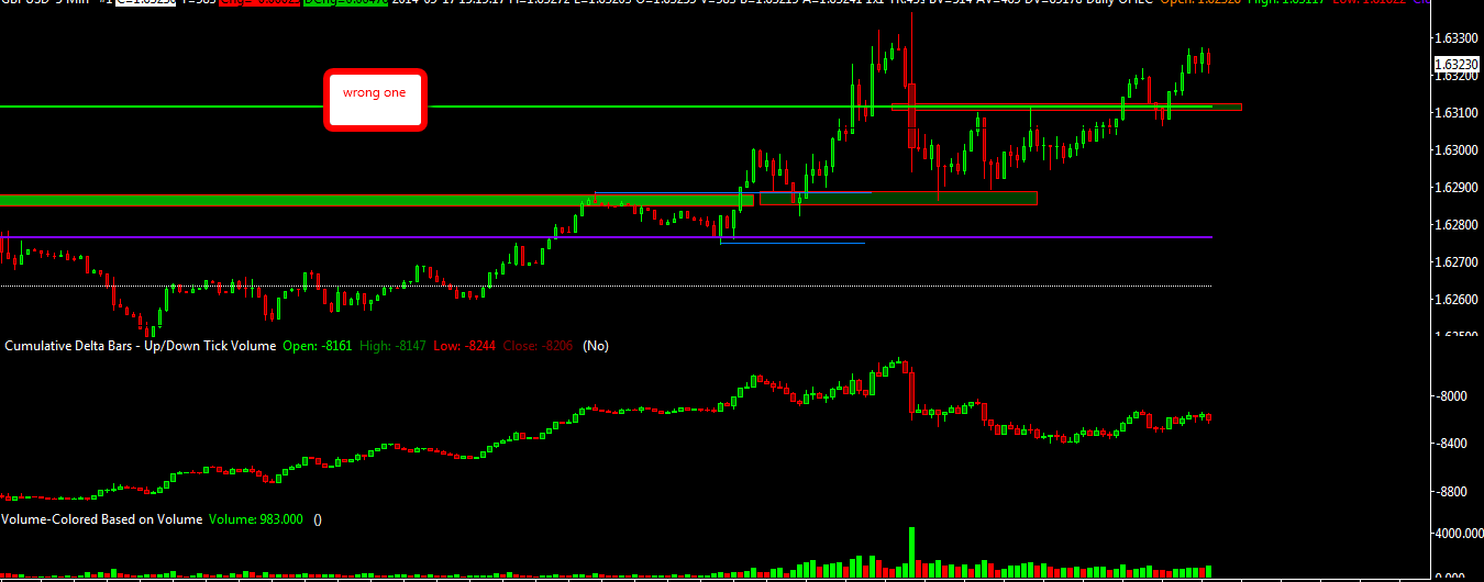

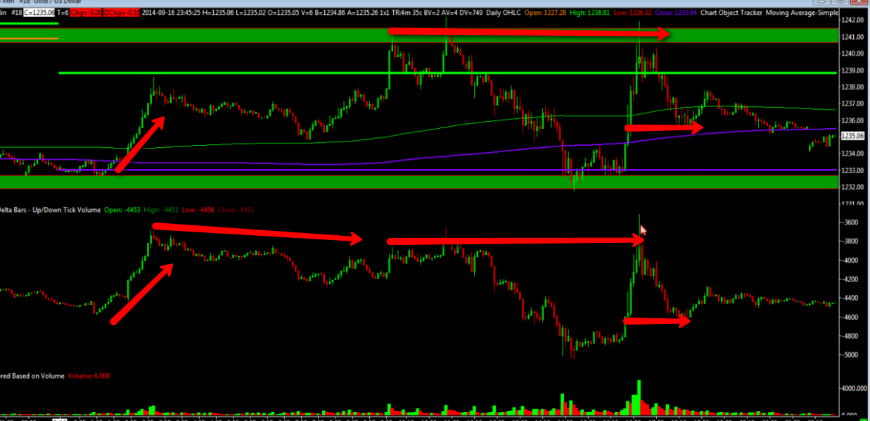

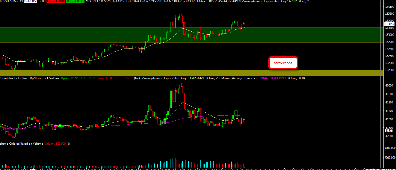

Please see attatched documents for the difference.
My Chart is the chart that has the delta that is very off from price, the other chart is the correct one. AS you can see the correct chart seems to keep the delta in context and follow price and be alot more accurate. Mine tends to just deviate then never really keep the whole chart in prospective. i have tried all the chart scale settings etc.
I have done everything you recommended with no difference at all. is there anything else that is default?
Also just out of curiosity on his chart there is no 'NO' for reset at end of day how is that possible?
Delta should follow price most of the time and keep the chart in context, i do undertand that it deviates because this is how enter but the differences between the 2 charts are immense.

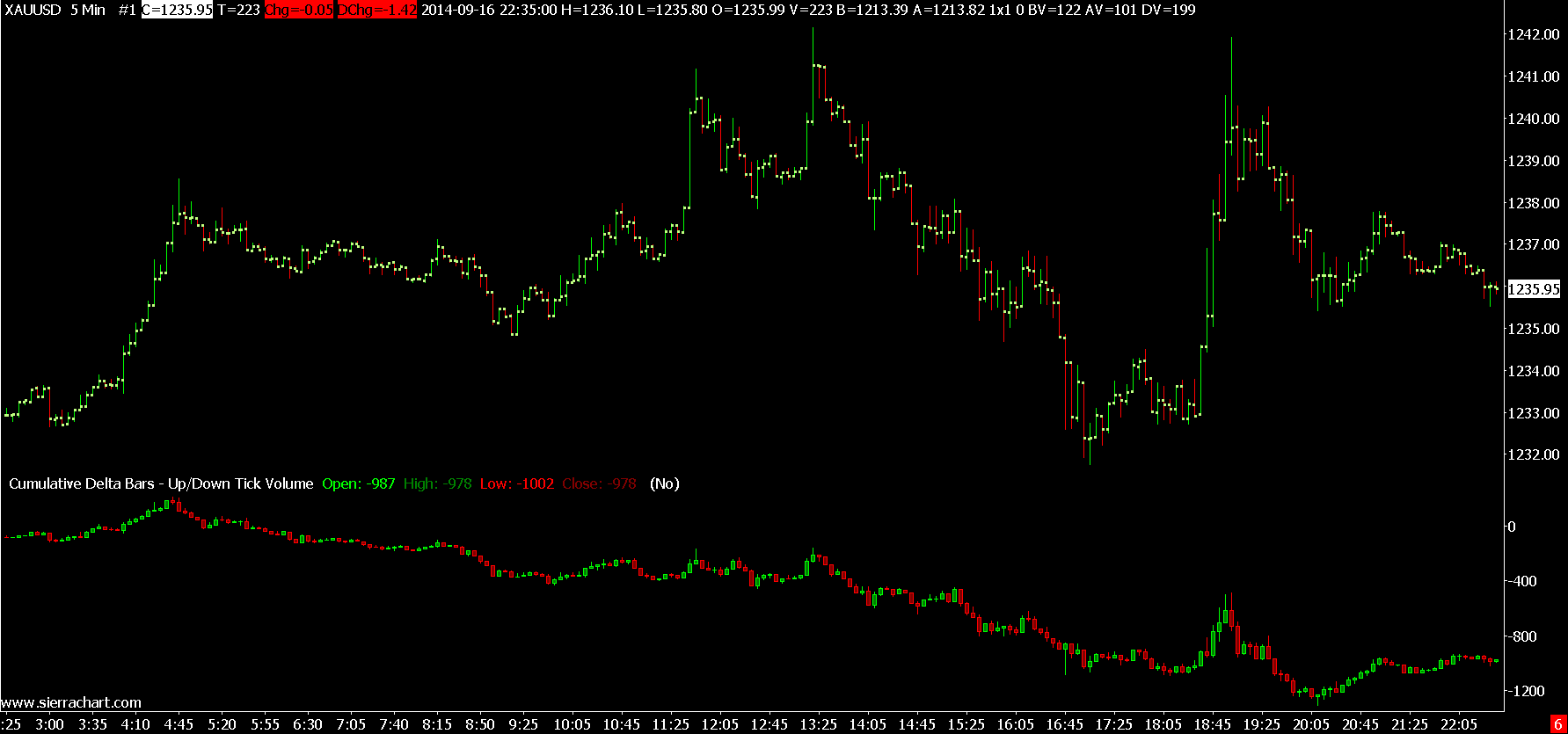

Post one chart where you see the Curative Delta Bars does not look as you expect and only post it by following this method here:
Use no other method.
Tell us the Date-Time of the first bar in that chart.
[2014-09-18 07:35:11]
User15378 - Posts: 45
Start date- 2014/09/16 01:10 to 22:20 timezone- Athens GMT +2
http://www.sierrachart.com/image.php?l=1411024928218.png
Here is my XAUUSD 5 min chart.
The differences are immense, in my previous post the correct chart for this symbol is the 2nd picture if you would like reference.

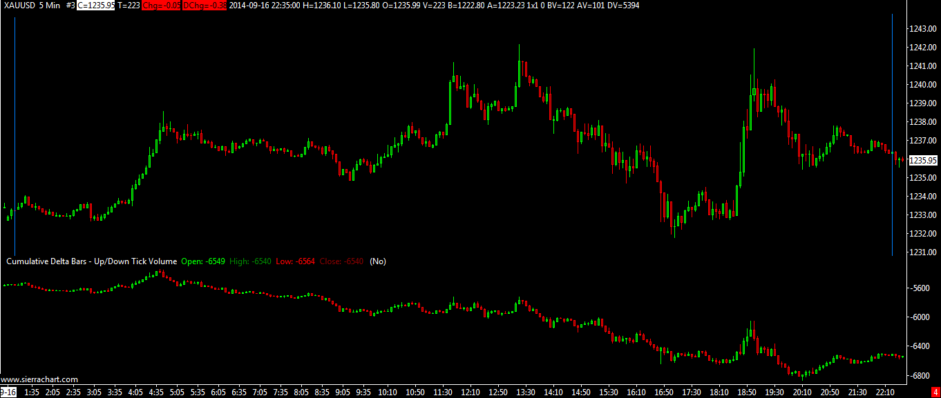

Using a starting time of 2014-09-16 at 01:00 this is what we get:
http://www.sierrachart.com/image.php?l=1411359541881.png
We are not fully understanding this:
What is 22:20? What are the Session Times set to in the chart?
