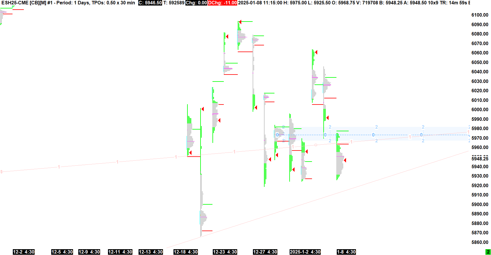

Hello, since I installed Sierra Chart on my new desktop computer, I am unable to highlight just on one of the technicals, as when I click the chart all of the technicals, trend lines, extending rectangles etc. are highlighted, with numbers.
When I clear them with ESC, they come right back after clicking on the chart again.
I had the same issue at my office, when I re-downloaded Sierra Chart, but it cleared up after downloading most current version.
Also, I had to do a screen shot, as it was the only way, for you to see this.
Martin
imageScreenshot 2025-01-05 134254.png / V - Attached On 2025-01-05 18:43:16 UTC - Size: 30.64 KB - 309 views

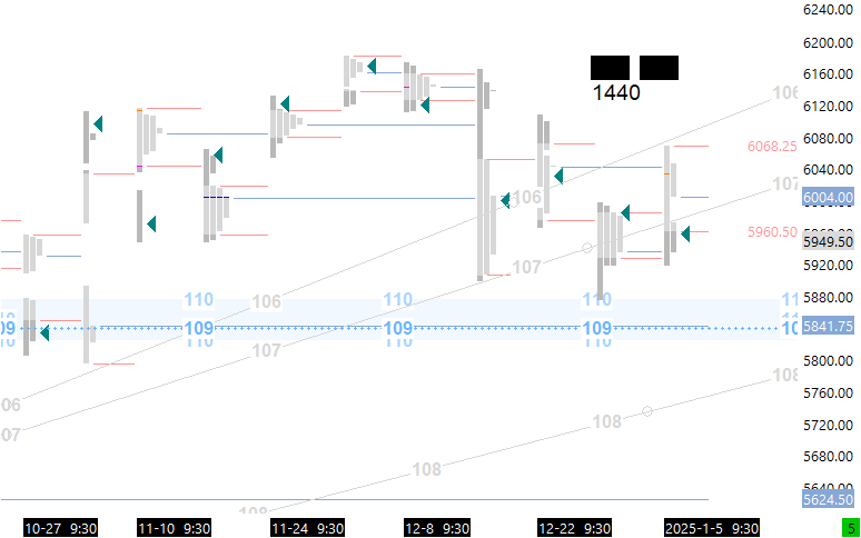

Martin Wunder - Posts: 18
Hello, please see the link below.
Multiple indicators are are highlighted, and I am unable to select just one, without zooming way in.
It does this on all pages, and all charts.
I think that I should probably delete, and re-install Sierra Chart.
It may be the easiest solution.
https://www.sierrachart.com/image.php?Image=1736208531271.png

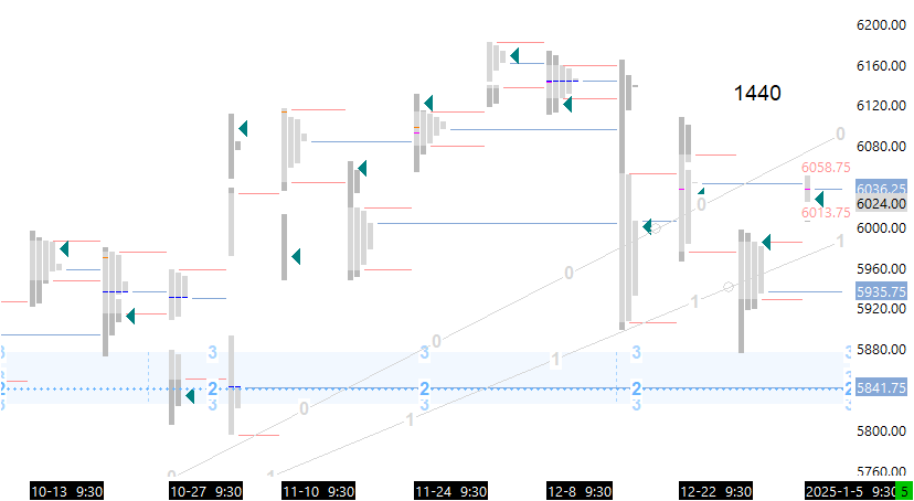

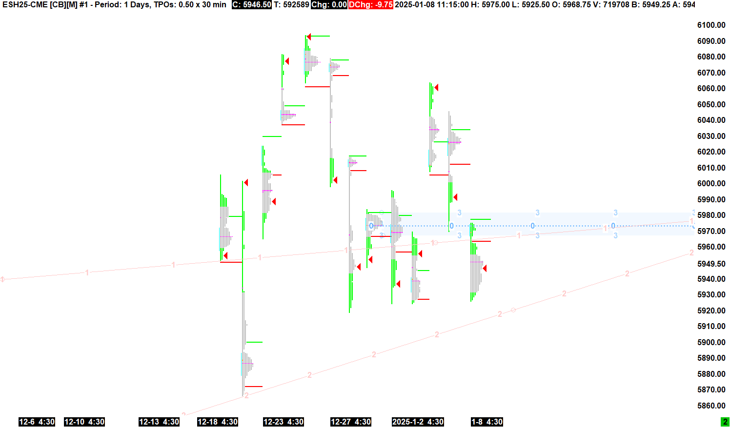

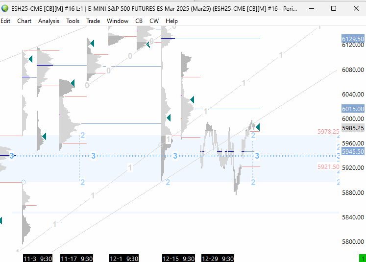

[2025-01-09 00:27:02]
Hello, the first link is a new chart, in a new chartbook.
I clicked on the chart near the extending rectangle with the pointer.
The second link is a chart with Adjust Drawing activated in tools.
The third link is a chart in my main chartbook with Adjust Drawing activated, that is where I saw the 3 digit numbers.
The problem is that when drawing tools are close, multiple tools are activated in the vicinity when clicking on the chart.
https://www.sierrachart.com/image.php?Image=1736381105660.png
https://www.sierrachart.com/image.php?Image=1736381055720.png
https://www.sierrachart.com/image.php?Image=1736381329839.png
Martin

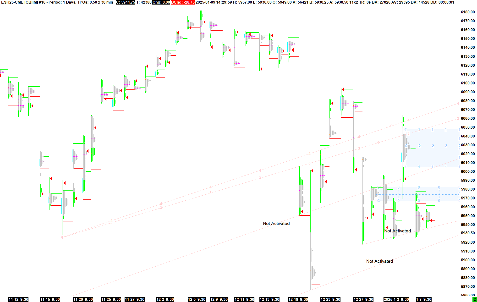

[2025-01-10 00:08:25]
Hello, yes ,it is a bit confusing.
With the pointer engaged, and Move Drawing off ,Adjust Drawing off, Copy and Adjust off, all of these are for sure not engaged in tools, the below link is what I get when clicking the chart, with the pointer, I clicked near the upper extending rectangle, and pressed ESC prior.
I have drawn some random drawing tools so that you can see that they are not ALL activated, with numbers, I marked the ones not activated.
Only the ones in the proximity of where I clicked on the chart, are activated with numbers.
It makes it extremely difficult to modify a single drawing tool.
Also, this is a new chart.
https://www.sierrachart.com/image.php?Image=1736467393938.png
Martin
