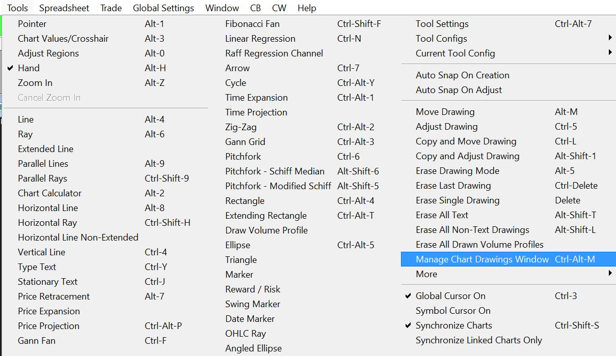

User719512 - Posts: 548
Sierra Chart Engineering,
Is this working for you?
And yes...I have that key combo mapped for this...
imageScreenshot 2025-01-03 203728.png / V - Attached On 2025-01-04 04:39:52 UTC - Size: 74.57 KB - 278 views

Will keep looking on my end. ctrl-alt-A brings up Alert Manager as expected, but no luck with ctrl-alt-M for Manage Chart Drawings. appreciate the reply.
EDIT: still searching for the culprit, but making this ctrl-alt-shift-M works as expected, so unsure what is eating the ctrl-alt-M when Sierra is active, but I do have a workaround/solution for the immediate issue.
