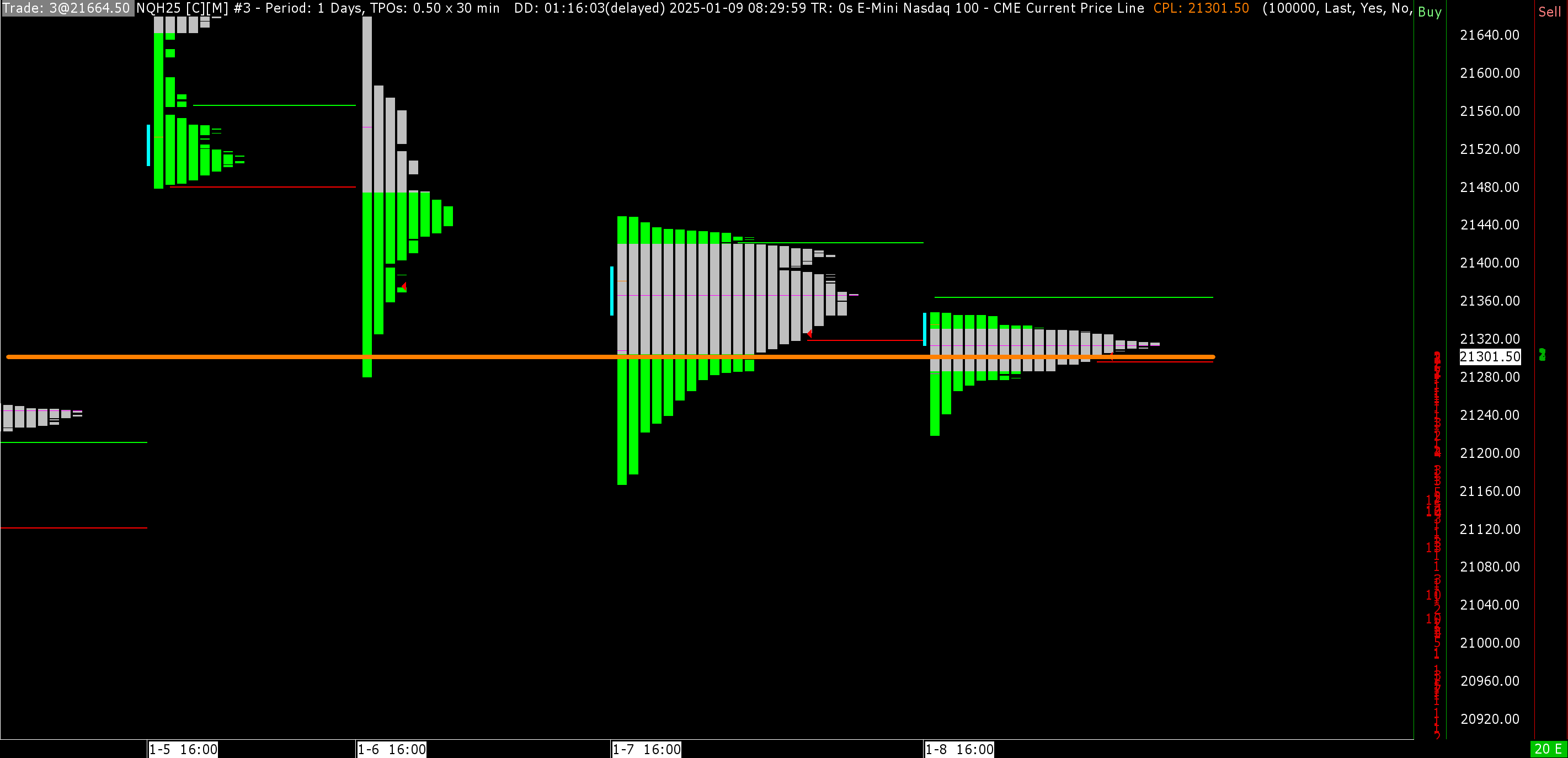

Hi there,
Although everything is perfectly on candlesticks, I have observed that the "Lock Fill Space" option on TPO charts is not functioning, and I am also unable to send the "Current Price Line" behind TPO charts. "Draw study underneath..." is selected, and the order layer is ranked second.

[2025-01-06 21:01:34]
In the case of a TPO chart to control the draw order, refer to the instructions here:
Chart Studies: Study Display Order

[2025-01-09 16:01:59]
We are not seeing any issue with the Current Price Line being drawn appropriately depending on the order in the Studies to Graph window. Attached is an image of the Current Price Line when it is below the TPO in the Studies to Graph - in this case the Current Price Line is drawn above the TPO study as it is lower in the Studies to Graph. The Current Price Line is the thick orange line in the image.
imageNQH25 [C][M] #3 2025-01-09 10_01_30.483.png / V - Attached On 2025-01-09 16:01:39 UTC - Size: 68.72 KB - 241 views
