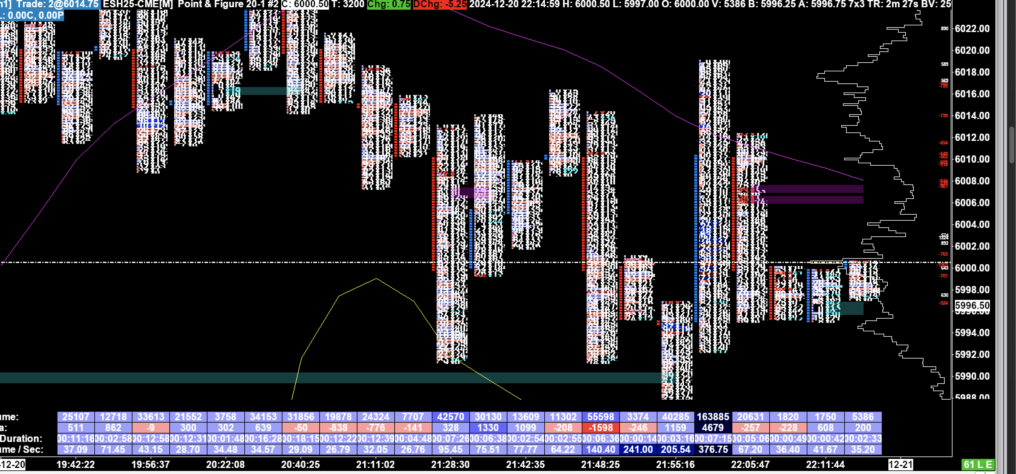

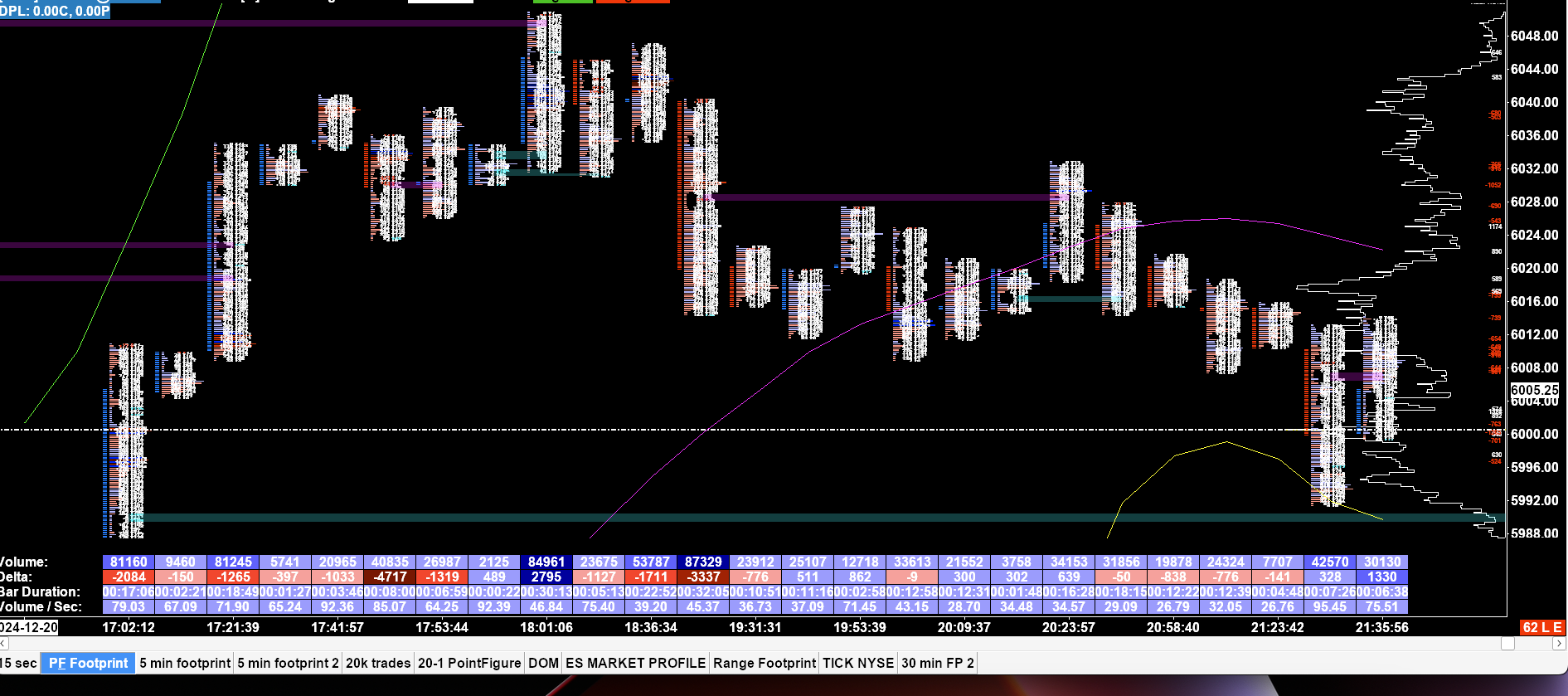

I have a problem with the size of my graph. In particular, I can't resize the graph. I see mixed numbers. I want a graph like the attached photo. The first is how I would like it, the second is how I see it. It's not a screen problem because mine is a 32 inch. Thank you very much.

Your price scale is set too tight. To fix that, right click on the right price scale, select Scale range : constant range, then right clic again and select interactive scale range. Now you can hold left click on the scale and expand/contract it.
[2024-12-21 22:41:26]
The main issue we see is the font size is too large. Adjust these three Inputs as needed:
Numbers Bars: Font Size Mode
And also refer to:
Numbers Bars: Scaling a Numbers Bars Chart

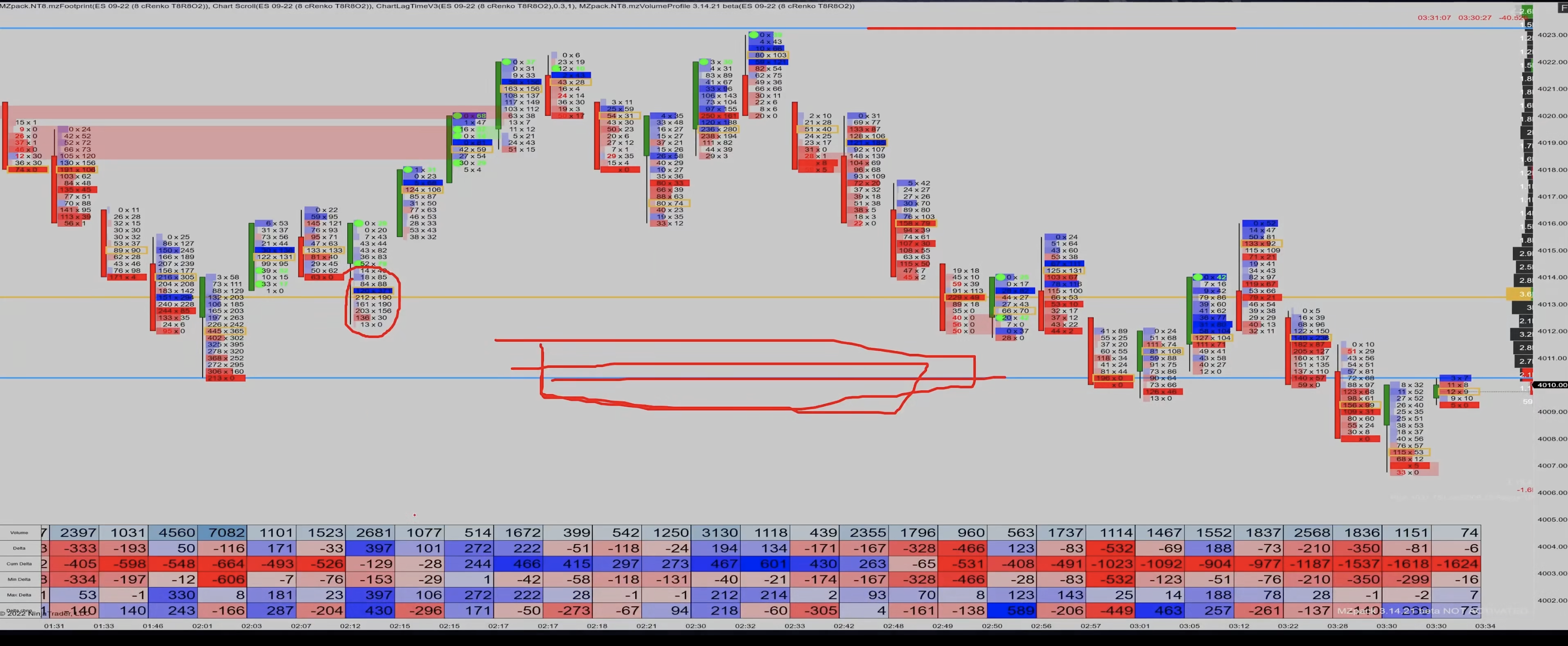

thanks guys I resized the fonts but it seems that I always have the same problem, when I want to see the chart with more candles all the numbers even with small fonts get mixed up. I didn't understand if there is a way to see them well as in the first photo I attached. Thanks

Yes. You need to increase the chart Tick Size:
Numbers Bars: Adjusting Volume at Price Multiplier For Larger Increment
