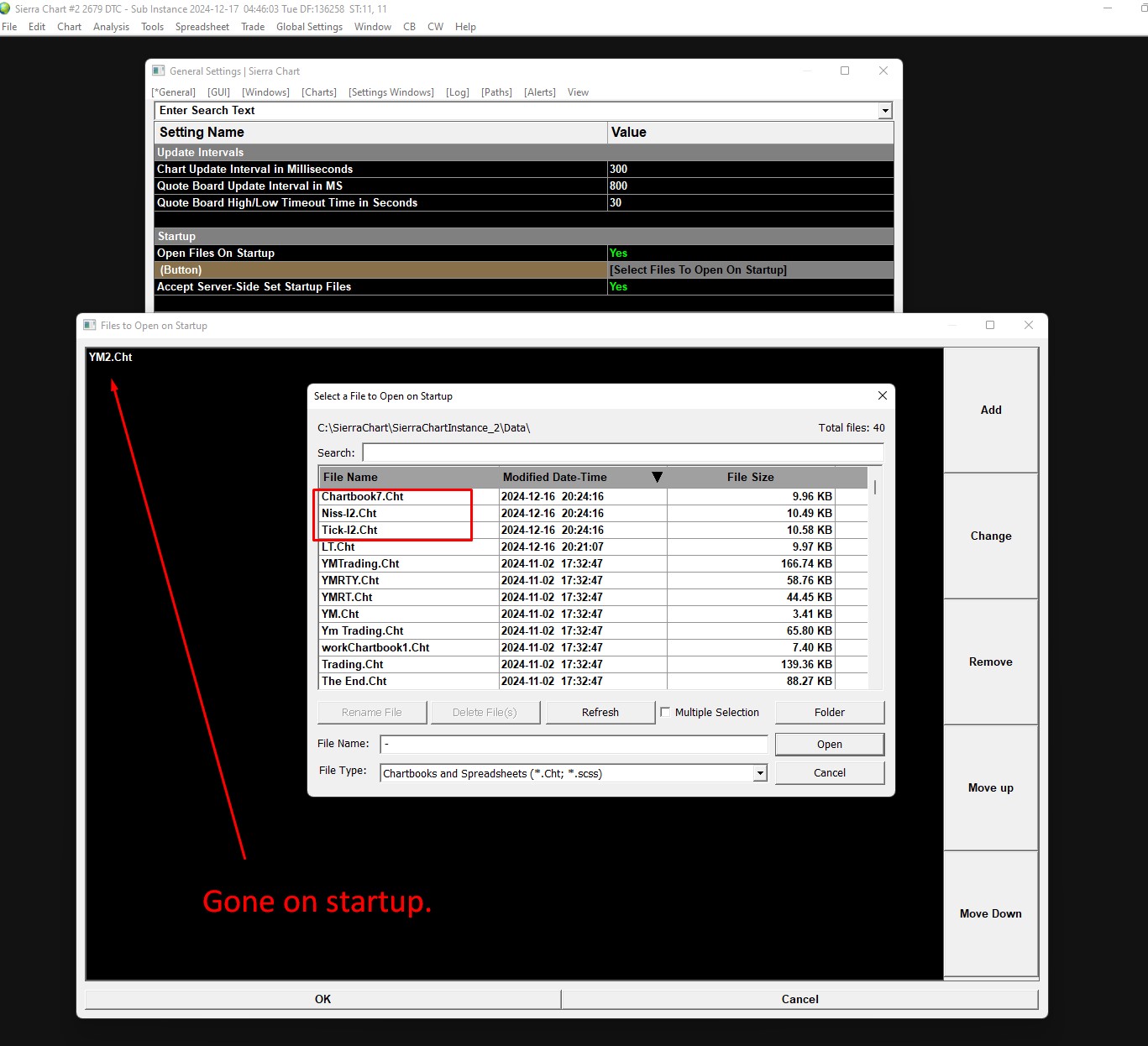

I need to run multiple instances and would like all my charts to load automatically on startup. On sub-instance the general settings has Open files on startup option turned on and the file directory have the right path and my SC version is 2679.

Sorry I didn't explain it correctly. Basically my chartbook in sub-instance 2 is not opening automatically. In sub-instance 2, I went to General > "Open Files on Startup" added my chartbooks which are saved in sub-instance data directory everything is fine until I save all and close the application and when I open next day my chartbook wouldn't open automatically for some reason the 2nd sub-instance is not being saved properly.

[2024-12-18 14:50:52]
You should not have a problem with this. The Sub-Instance should be doing what you are wanting and it sounds like you have everything setup properly.
In the Sub-Instance, please tell us what the following items are set to:
- Global Settings >> General Settings >> Paths >> Data Files Folder
- Global Settings >> General Settings >> Paths >> Always Use 'Data' Folder within Main Folder
[2024-12-18 16:35:11]
MarketBeast - Posts: 48
C:\SierraChart\SierraChartInstance_2\Data\
- Global Settings >> General Settings >> Paths >> Always Use 'Data' Folder within Main Folder Is YES

[2024-12-18 17:10:08]
Since you have the "Always copy config files to new instance" set to "Yes", this is probably causing your issues with the Chartbook opening and keyboard shortcuts.
To start with, are you wanting the same chartbooks to open in the Main Instance and in the Sub-Instance? If so, then keep the "Always Copy config files to new instance" set to "Yes" and make sure you have the chartbooks with the same names in both instances.
With regards to the Keyboard Shortcuts, make sure you make any changes in the Main Instance and then restart the sub-instance to get those keyboard shortcuts to flow down.
The other option would be to set "Always copy config files to new instance" to "No" and then have each instance setup as you want it.
With regards to the default study settings, we see that the folder that has the default study settings is not being copied even with the setting for "Always copy config files to new instance" being set to "Yes". If you are comfortable with it, copy the folder named "DefaultStudySettings" from the Main Instance installation folder to the top of the Sub-Instance installation folder (C:\SierraChart\SierraChartInstance_2). You will then have those default study settings in the sub-instance.
[2024-12-19 01:13:49]
Thanks for the explanation. So it seems like as long as this option is set to YES "Always Copy config files to new instance" anything I modify in general setting will not be saved therefore on sub-instance 2 you can not have chartbook open automatically on startup, correct? So, I guess I will set it to "No" and if I need to copy/replace anything I will just copy/paste data files from one instance to another.

[2024-12-19 15:38:00]
You are correct.
